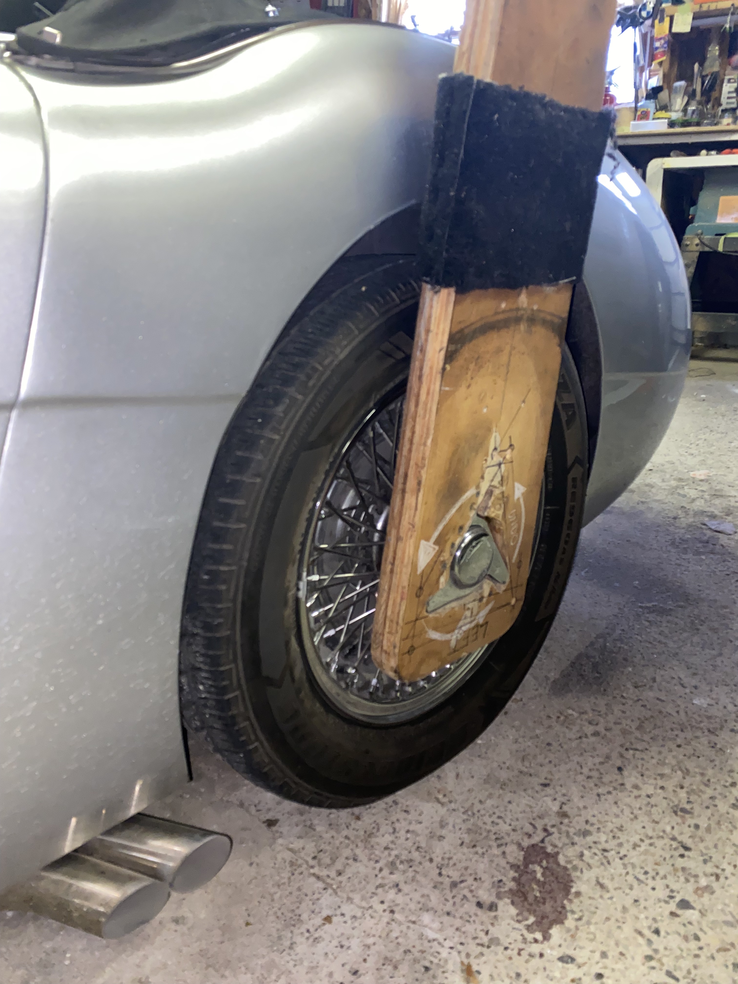

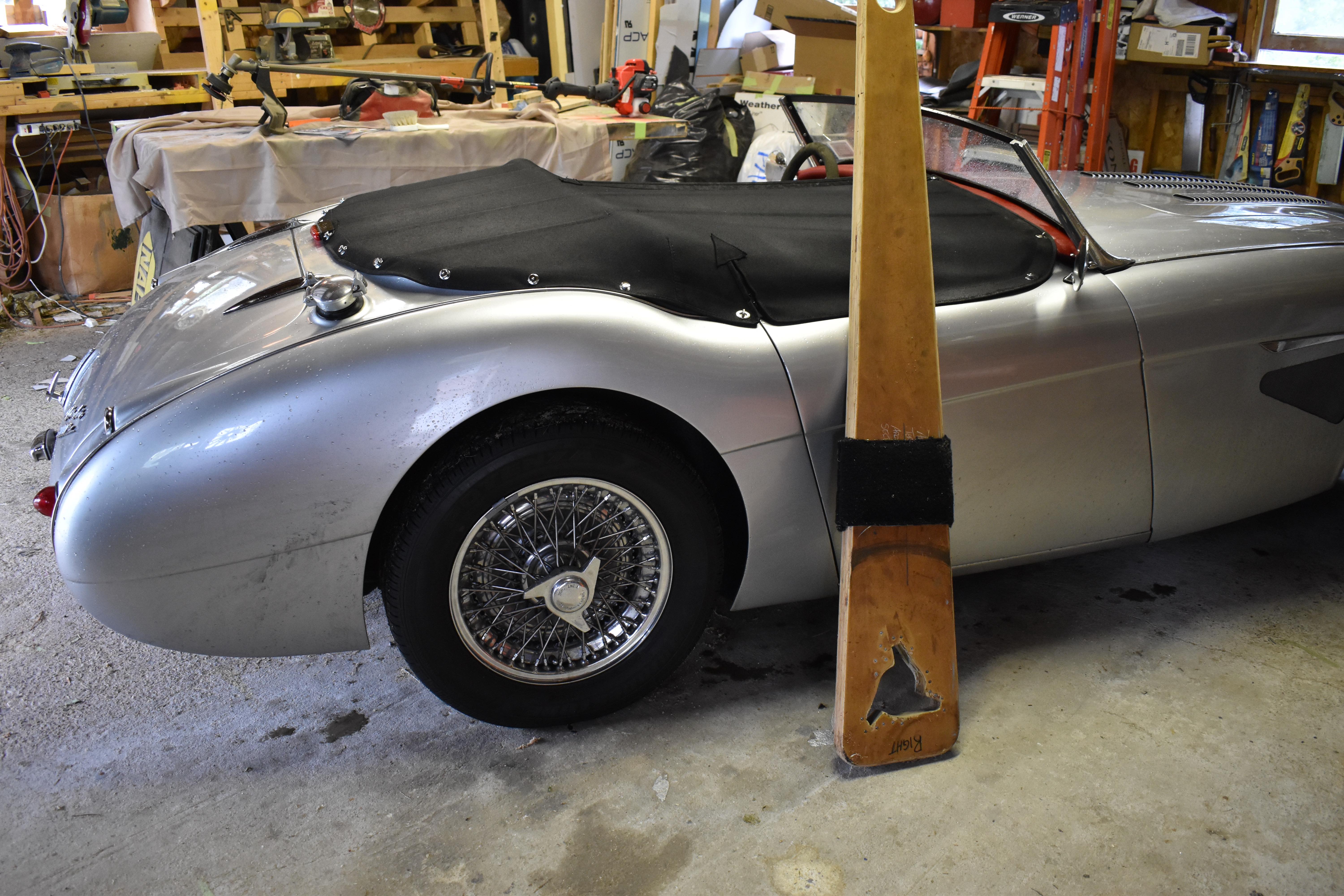

Hi Guys,
Who likes to "beat the livin' crap out of their Knock Off Hubs" ? Raise your hand.
Just the thought of removing a Knock Off was stressful enough for me, especially when they're new !
Obviously this "wrench" is only for the garage but it works flawlessly.
One quarter turn is all you need to tighten or remove the Knock Off.
The section of black carpet was added to protect the paint from scratches.
I still keep a 5# Sledge hammer and a piece of hardwood in the trunk but only for self defense.
Bouna fortuna,
Peter C.

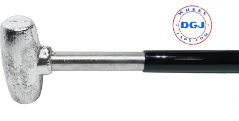

I don't "beat the living crap" out of my knock-ons. I use a Thor copper/hide faced hammer. You should never use a steel hammer on a knock-on, and the hardwood will probably split when struck by the sledge hammer. I'm not a fan of these wooden devices, I wouldn't use a wooden mallet to tighten a knock-on so I would not have confidence in the effectiveness of any wooden tool.
One time I couldn't find one of my 4lb lead sledges to tighten a K/O so I put a block of wood on the K/O ear and beat on it with an iron sledgehammer. It's the only time I dented or marred a K/O, and I've beat a-plenty with the lead hammer.
PAUL161
I use lead only! Almost 10 years and my knockoffs still look like new. (y)

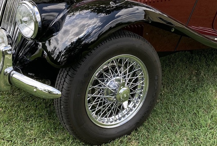

10 years of tapping on these
with one of these
and not a mark anywhere. Easy to tell just how snug they are when tapping them. I also do this with the wheels off the ground. Never had one loosen up yet and used the same procedure on the MGB. (y)
