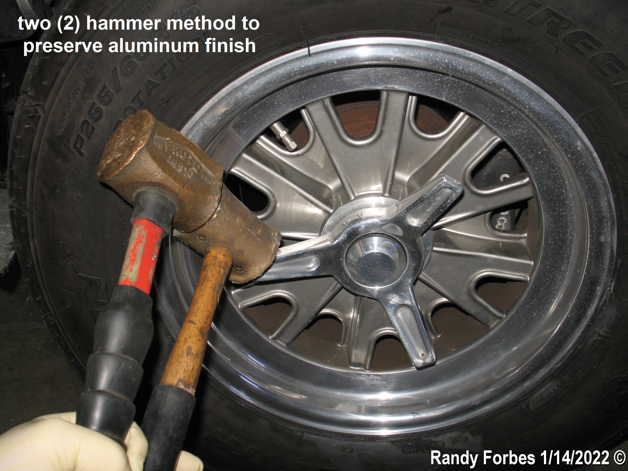

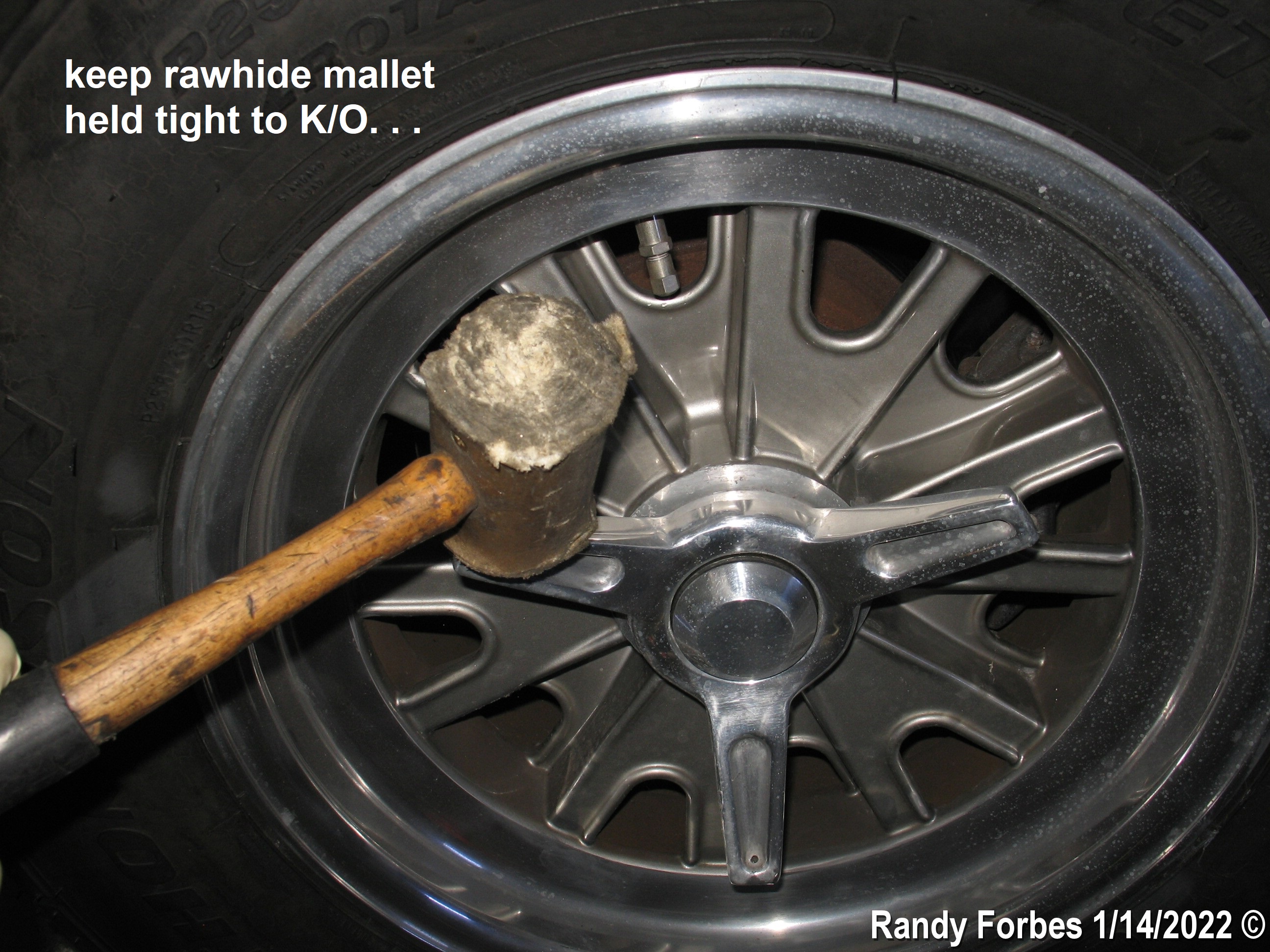

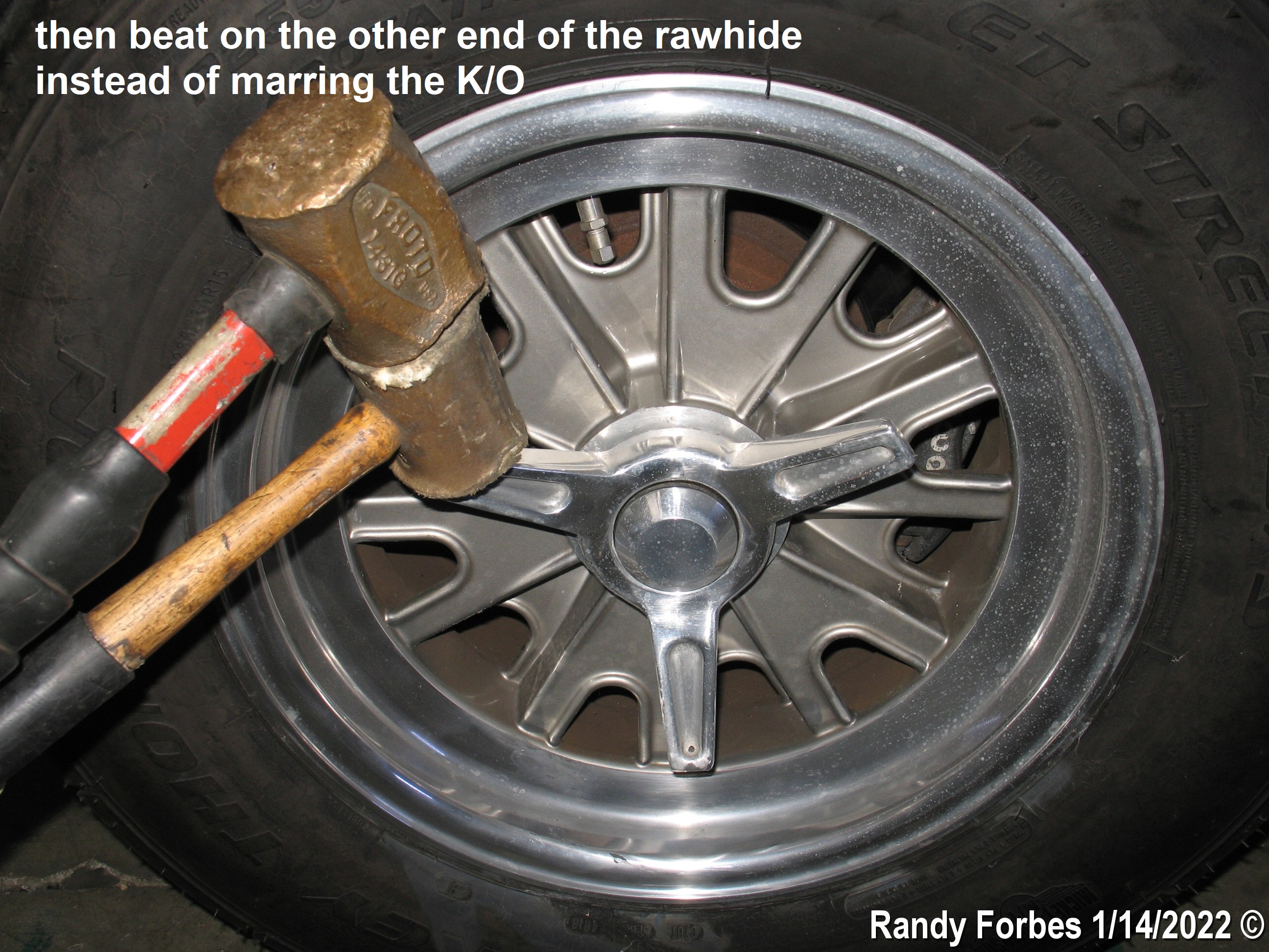

Another Healey owner tipped me to the "2-hammer" method sometime in the 90s; he held a lead hammer to the spinner, and struck the opposite end with a decent sized mallet. The spinners on his 30-yo MKIII still looked pristine! Taken a step further, I use a rawhide mallet against the spinner, striking it with my Indy 500 (Proto Tools) copper hammer...

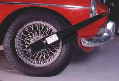

I have a British Wheel Wrench:
BRITISH WHEEL WRENCH for MG. Knock-off KO Spinner Wire Wheel MGB TD TC
I've made sure there are no sharp corners on the working surfaces and put a shop rag over the spinner. The threads are 12 tpi.
I tighten the spinner hand tight plus 1/2 turn.
