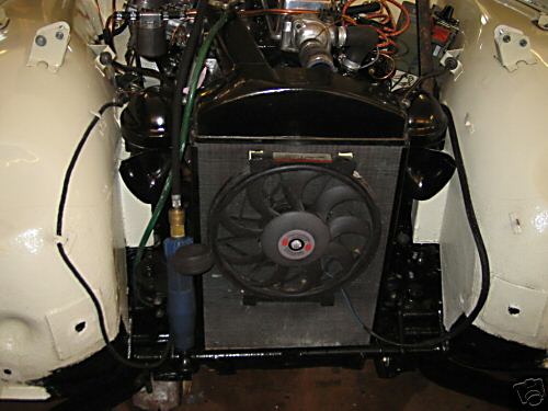

How have all of you mounted your aux. electric fans?
Anyone made actual metal mounting brackets that you would share the diagrams and photos of the set up and install?
I have a fan but am not interestest in the factory's suggestion of thru core cable ties mounting method.
Mickey Mouse way of doing it I say!

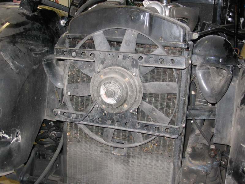

Here are photos of how I mounted the 12" kenlowe fan I installed on my Black 1958 TR3A back in 1992.
A white TR on e-bay a while back showed how the fan was done.

Mine's not "auxilliary", it's the main fan. And after talking to my friends at the local radiator shop, I used the plastic ties through the core. Worked great for almost 20 years of daily driving.
So, Mickey Mouse it may be, but it's simple, cheap and effective.

Mickey Mouse was not a slight even though he only has three fingers and a thumb on each hand. Just thought that there may be a better way
TR3driver
Great Pumpkin - R.I.P
No offense taken, Tom. It is kind of Mickey Mouse, IMO, and I was concerned about it myself.
But Kurt at Mac's Radiator Shop told me that, although they would be happy to build me a steel fan mount, the plastic ties would work fine (as long as I was careful to position them away from the tubes). Seemed like it was worth a chance to me, and it worked out quite well.
Not sure what Kurt's relation to Mac's is, but I've been dealing with him for close to 30 years and he's never steered me wrong. Even sold me a second recore at his cost after I ruined the first one through my own stupidity.
