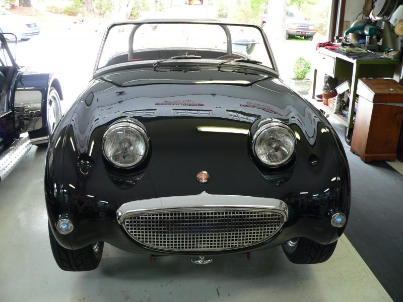

Paint booths are a necessity when your looking for a high quality paint job. My Healey was painted to these standards and the results and outcome was excellent.
