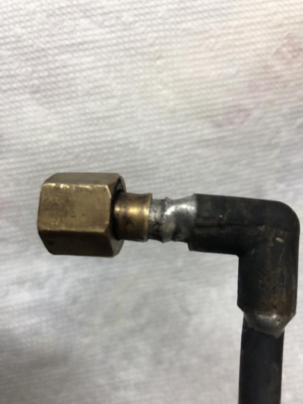

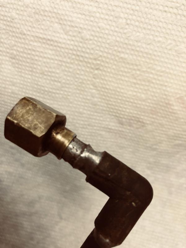

I had a problem with the fuel pump rapidly clicking when I was driving my car. It also clicked a lot when I switched on the pump to start the car. The problem ended up being a defective connection on the fuel line fitting that attaches to the tank.
I troubleshooted this by disconnecting the fuel line at the carb and submersing it in a container of fuel and turning on the ignition key to check for air bubbles. I then worked backwards Checking fitting connections to the pump and then the tank.
