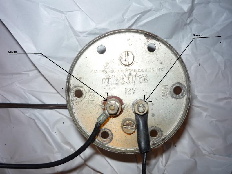

DavidApp
Here is a photo of the sender with the wires marked.
+ 1 on the good ground wire to both the gauge case and sender unit.
David
