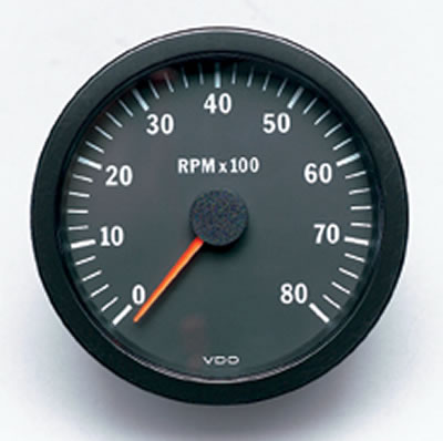

While working on the Bugeye getting ready for CMP
track day I somehow fried my VDO tach.
Reads idle rpm just fine but will not go over 2.5k on
revving.
Geesh.
I disconnected the bloody thing and checked all connections.
Re-installed and it it still is wonky.

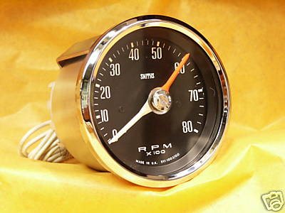

I ordered this sucker. Ex Works Mini 8000 rpm Tach.
It is a nice match for the Smiths speedo and as a bonus it has an adjustable redline indicator.
Old VDO tach pic for reference.
It may not be here in time but it will look correct in the end.

So what happened to the VDO Dave? VDO gauges are usually bullet-proof.

The tach is supposed to be an all original Smiths unit.
4 cylinder only model.
dklawson
If you change your mind, there is still time tomorrow to send you a loaner.
Keep in mind that if it is an original Smiths tach, most of the ones that look like the one in your picture are the RVI type that does not work with electronic ignitions. As long as your dizzy has points you will be OK. Also remember that RVI tachs wire in series with power to/from the coil and do not use the modern single wire hookup used by voltage sensing tachs.

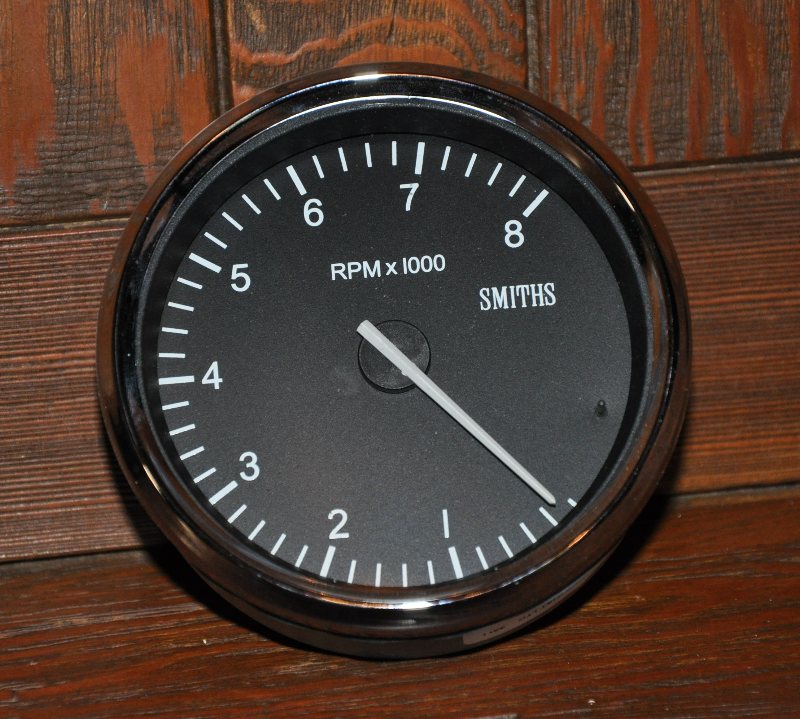

Well, I screwed the pooch on this one.
I don't know why I had 80mm in my mind.
It is 100mm for a Bugeye dash.
Live and learn.
BlueMax, my buddy, found me a 100mm Smiths racing tach.
Ordered THAT one today.
Overnight shipping will have it here tomorrow.
Pic:
Mine will be 0-8000 scale.

dklawson
If the tach from Europe is truly "new" it will be a Caerbont manufactured gauge. Those are the type I mentioned earlier where you have to pay close attention to the dip switch settings and which wires you use for connecting to the ignition system. They are a high-tech, universal application tach built to look like the traditional Smiths instruments.
Sorry about the diameter difference. The racing tach looks nice though. Unfortunately, unless your engine is exceptionally prepared, it looks like the needle won't see the "top" half of the scale.

My gauge will be a 0-8000 scale.
