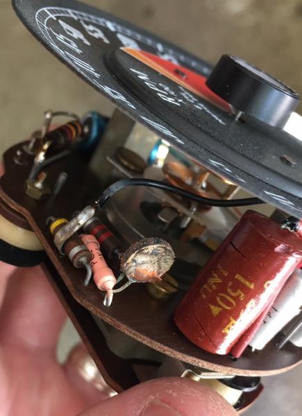

Prior to totally failing, did your tachometer read high? There is a known problem with our electronic tachometer where a 2uf capacitor deteriorates and eventually fails to a shorted or open circuit. It is reasonably easy to replace the part and recalibrate the tachometer.
Attached is a document written by Frank Filangeri that addresses this condition that could be the cause of your problem. One last point, Frank describes this capacitor as tubular in structure. However, I found my capacitor to be more disk like. so either could be presented.

Is the 2uf capacitor you are referring to the round disk-shaped component in the center of the image that has the paint burned off?
