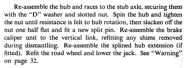

Making steady progress on the TR4A. Time for the hubs to go back on, and I thought I'd ask if y'all have any tips on doing this.
Manual makes it pretty straight forward, but...

Tighten until the bearings just start to bind (hub doesn't spin as freely as before), then back off 1/2 flat plus whatever it takes to get the cotter pin to line up.

You should probably get one then.
The snippet above is from
