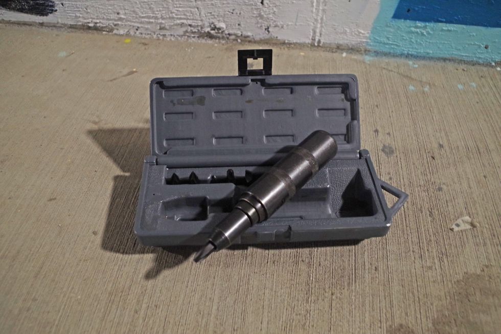

What I suggest you do to remove the stuck pin is to hack saw it above and below the door hinge pivot that is what we did then put it into the drill press with a jig to keep it vertical and drilled the pin out, next we had to drill the hinge again for an oversize pin, do not try and drill with it on the car.
If you have to remove the hinge half that is screwed to the pillar use the tool in the pic BUT you will need to support the pillar with emphasis at the top where the signal arm goes. We bent the pillar from repeated hammering on the hinge screws, had to turn them cherry red, and hammer the heck out of them.

Bayless
Thanks for the advice but I am afraid I will have to drill it on the car. I have tried your suggested impact tool with no luck. Also my door jambs are already painted and I don't want to burn it up. I'll try a smaller bit to weaken it enough so I can push it out. I think someone had worked on this one before (surely not me, I hope) and spread the bottom part enough that it is too tight in the bottom section of the hinge. Will try that later since working under the car and on the driveline right now. Like you, I am waiting for warmer weather before painting the Sprite. Prefect outer skin still needs to be stripped before paint prep can really start so maybe by next fall.

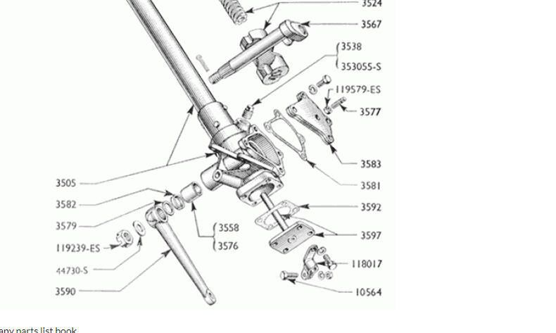

Hey algot, I need a favor. If you get a chance an are so inclined, would you please measure your steering arm for length. I have to customize one and I need the length from the center of the shaft out of the box to the center of the drag link tie rod end. In other words, center to center between the holes in the arm.
Thanks very much.

Confused!!!!!!
Which part??

Bayless
#3590 in your diagram.

Bronze
Approximately 5 inches from hole to hole center which would be 4 1/2"
Bayless
Thanks very much. I'll check mine and see what I have. I'm sure it is too short since my turning circle is way too big.
