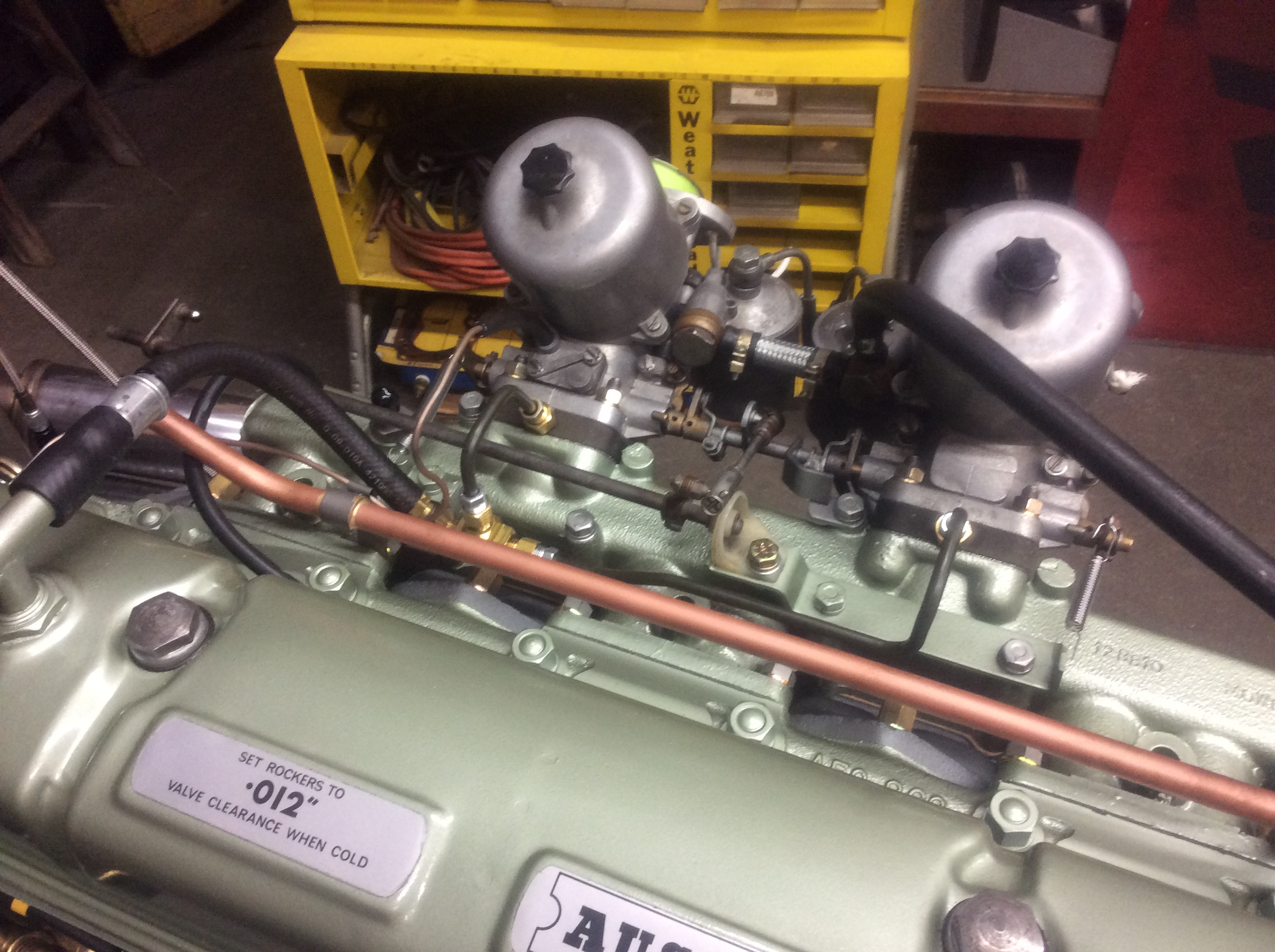

Also with the hose going from the rear valve cover vent to the carb in the original fashion you will have too much pressure in the crankcase (possibly more so because of ring blow-by). With that hose stuck in the rear air cleaner that rear carb is also ingesting oil into the cylinders. So first thing to do is take the hose off between rear valve cover vent and the rear carb and throw it away. Then install a K&N push on filter on the valve cover vent as seen in the attached picture. This will at least remove the carb from ingesting oil which will help. It will also allow the crankcase to breather better and reduce some of that crankcase pressure. Then by use of a proper compression test and leak down test try to verify whether the cylinders have weak rings or bad valve seals. If it is just valve seals it is not a hard fix and you would at least be able to enjoy driving your car.
( As a side note, realize that the hose and Tee vent arrangement on the Healey as installed by the factory is not a good arrangement. The crankcase usually has too much pressure in it. It is not vented well. That is why they develope oil leaks so easily. That hose to the carb is the only factory original opening to the crankcase and it is not enough. With the K&N filter installed like seen in the pic it helps to reduce pressure in the crankcase. )

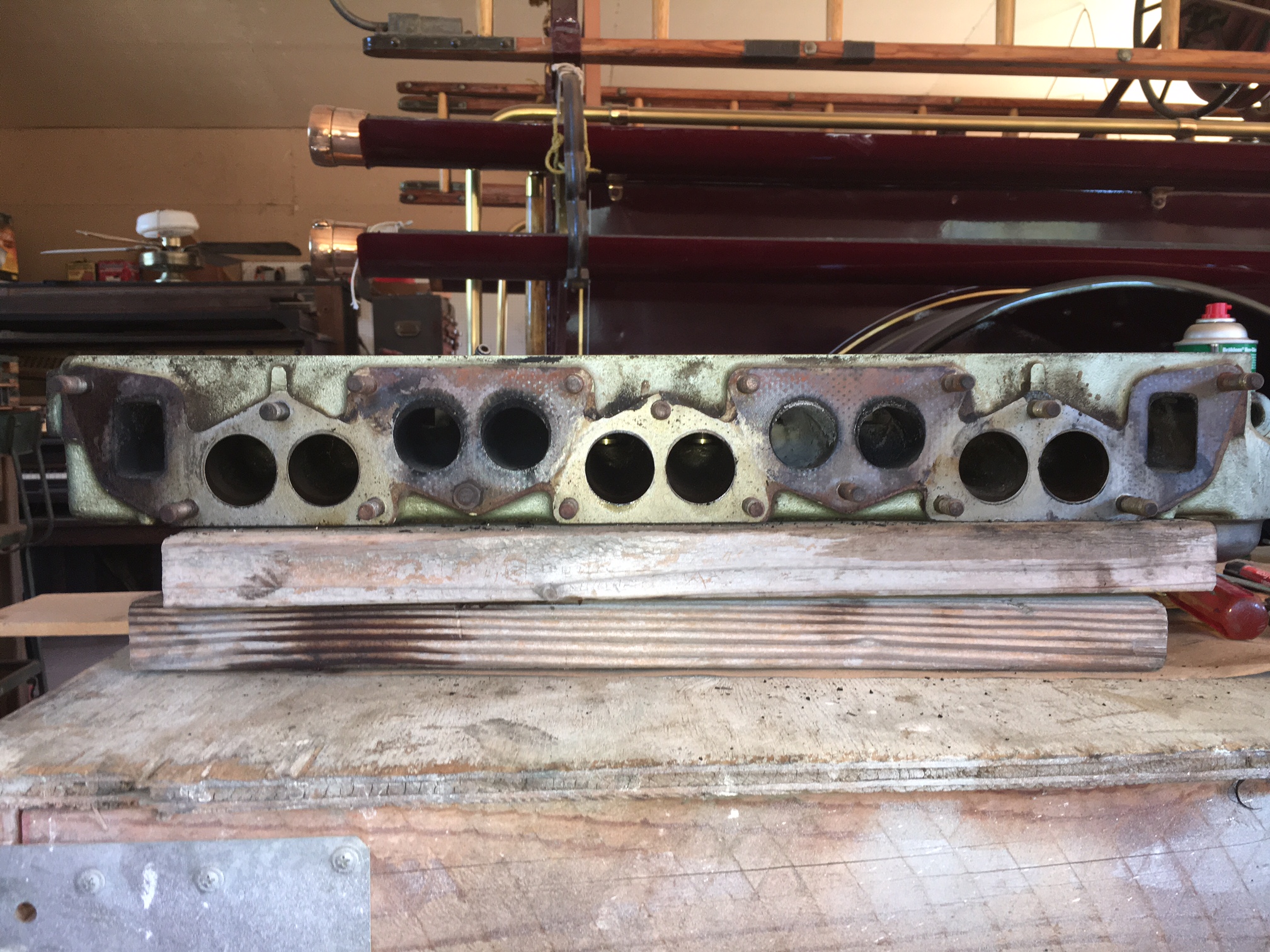

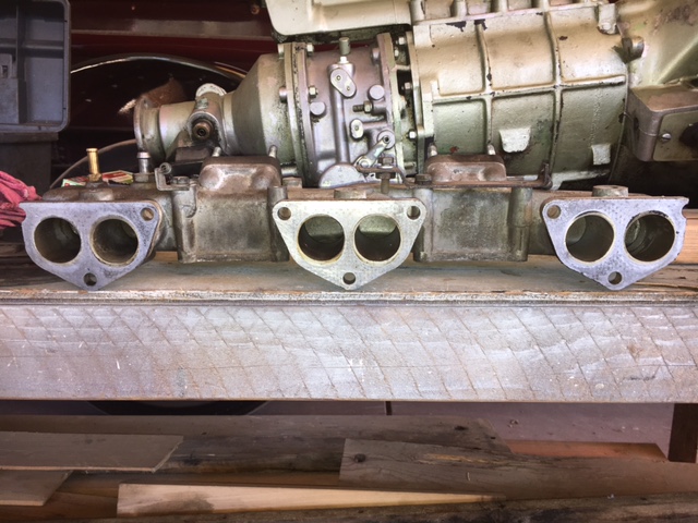

I started with a 'kit' from BCS put together by Norman Nock; the valve was 'loose;' i.e. not in a box so I don't know the part no. (wish I did). The original kit had the PCV output vented to the spare vacuum port on the manifold; my engine builder who did the most recent overhaul fabricated the current rig. He tapped the 'phenol' heat insulators; actually, it never occurred that he used brake hardware, but that makes sense. I wanted him to install a rear crank seal I'd bought, but he insisted this was a better solution.
I'm somewhat 'environmentally conscious'--I do what I can--but that wasn't the purpose of installing the kit. I used to take a lot of long road trips and would sometimes encounter bad dust storms; I wanted better air filters than the stock 'grasshopper stoppers.' When I pulled the head for rebuild, I was surprised that the back intake ports and cylinders looked not much worse than the front ones. With only a few exceptions--my 2000 Lincoln LS doesn't have a PCV valve, just a passive tube to the throttle body (it's a British engine)--every car built from the early 1970s has PCV. It's considered advantageous overall; including keeping oil cleaner and preventing sludge buildup and, for my Healey reduced oil loss. I did put a catch can inline on my 2019 Mustang GT.
