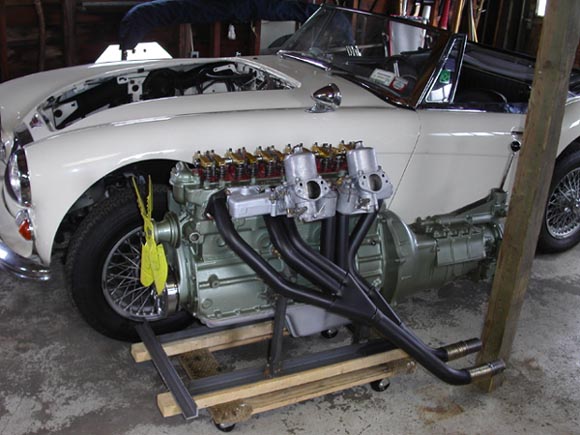

I posed a picture of my motor before I installed it on Sunday. See the attached.

Can't comment on the sound yet. I hope to fire it up this weekend for the first time in more than a year.
You've mentioned that it changes the sound...I've got a full stainless steel exhaust (I know, counter-productive) so I expect it to be louder. Hope the 'rasp' is still there.
