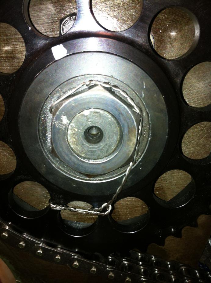

Hello,
DW told me to lock wire the nut. I sent them this picture and DW told me it looks good.
Cheers Phil

Oh Good!
It looks like I've done much the same as MCS. I drilled a 2mm channel across a flat/angle of the nut and put in a lock wire, twisted around a spoke on the cam gear (didn't fancy drilling through an expensive gear). I also sealed the nut thread with Loctite.
I don't know if this is overkill as rotation is in the tightening direction. But easy done and peace of mind.

roscoe
I don't mean to be picky, the lock wire is the good choice, but if you had your pick of "spokes " to run the wire to, why did you not use the nearest spoke in the tightening direction. You now run the small risk of having the braid pop off the side of the nut and become useless or even do some harm if it hits something causing some damage? The shortest piece of safety wire you can use is most often the best course.
