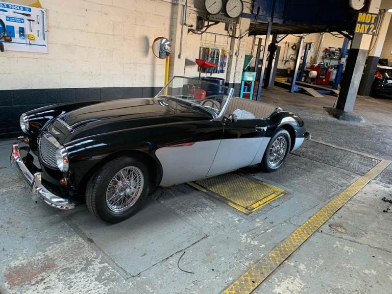

The 9 leaf springs are on, along with the front disc conversion, high torque starter and electronic dizzy.....can't wait to get her back
On to new tyres as well as replacing the front seat
Tyres will be from Blockley, however I'd take advice on front seats Healey.jpg
