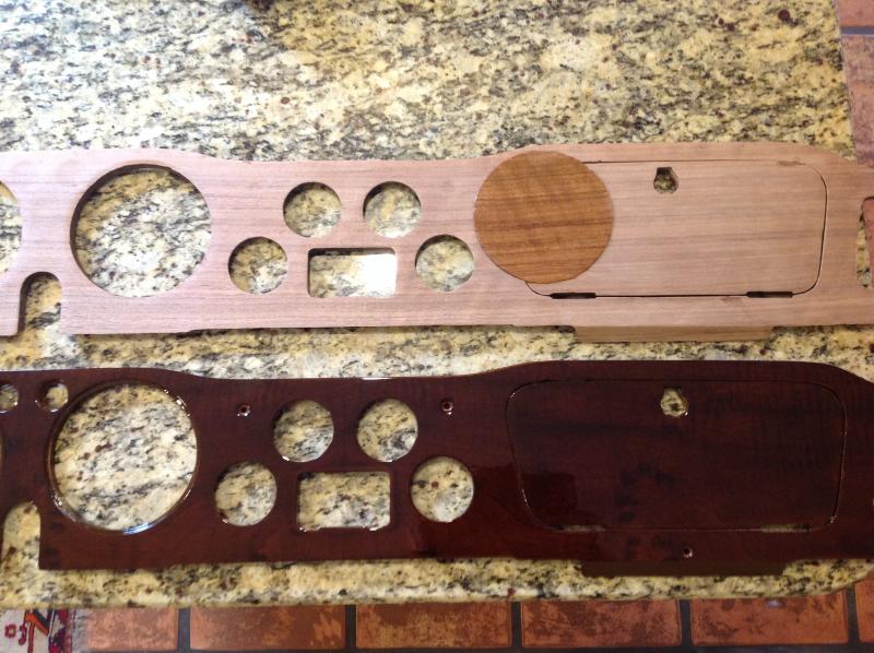

I just finished doing this to 2 TR4a wooded dashes and chose to go with marine spar urethane. I'm going to have 8 coats when I'm finished and so far I'm very pleased. One dash is the original wood and the other is a rotten dash I relaminated and covered with a piece of walnut veneer with a very similar pattern to the original.
Rut
BTW, when you finish your dash be sure to finish the backside and all cutouts to prevent delamination.

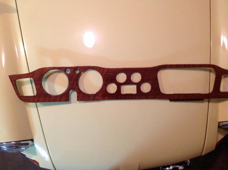

On our Spitfire we chose to re-glue the lifting OEM vernier, fill the cracks, then apply a new layer of teak vernier over that. The new vernier was lightly stained and then, like Rut, we applied several coats of marine spar varnish. We did not go for a thick, deep finish with multiple coats. I believe we stopped at three which left the vernier with the appearance of more open grain. The dash has looked good for the past 7 years.
