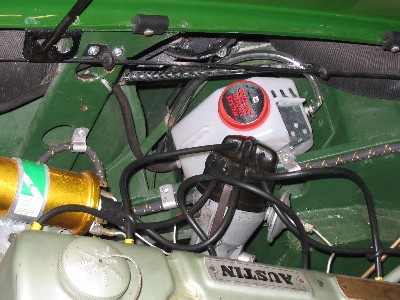

I know this is an old thread, but I installed a recovery tank today. I contemplated making my own until I found a polished stainless steel tank that was cheaper ($32) than what the raw materials would have cost. It’s a 3” tube 10”s tall with a nice knurled cap. I made a simple bracket that mounts it to the radiator bolts. One modification I had to make to the tank was put a bigger barb on it so the tube from the radiator would fit. I think it makes a pretty clean install for our cars. Check it out.
