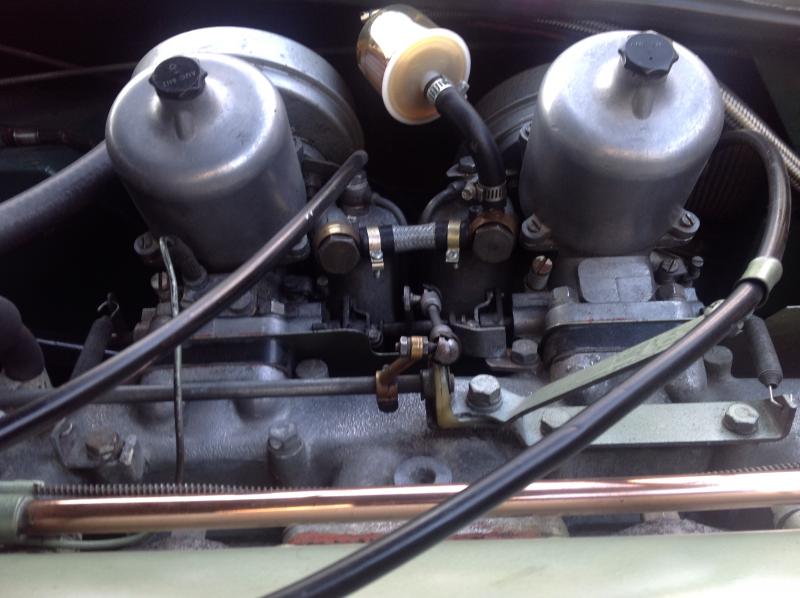

Actually, I used regular baking soda....very mild and leaves the perfect stock finish! See my posted photo..I should have pointed that detail out in my above post. Household Armor hammer baking soda..works great! Yes,I definitely agree benching the carbs are one of the most pleasant, relaxing and rewarding things to do.

Your carbs look great; for some reason I didn't notice your photo first-time reading it.
