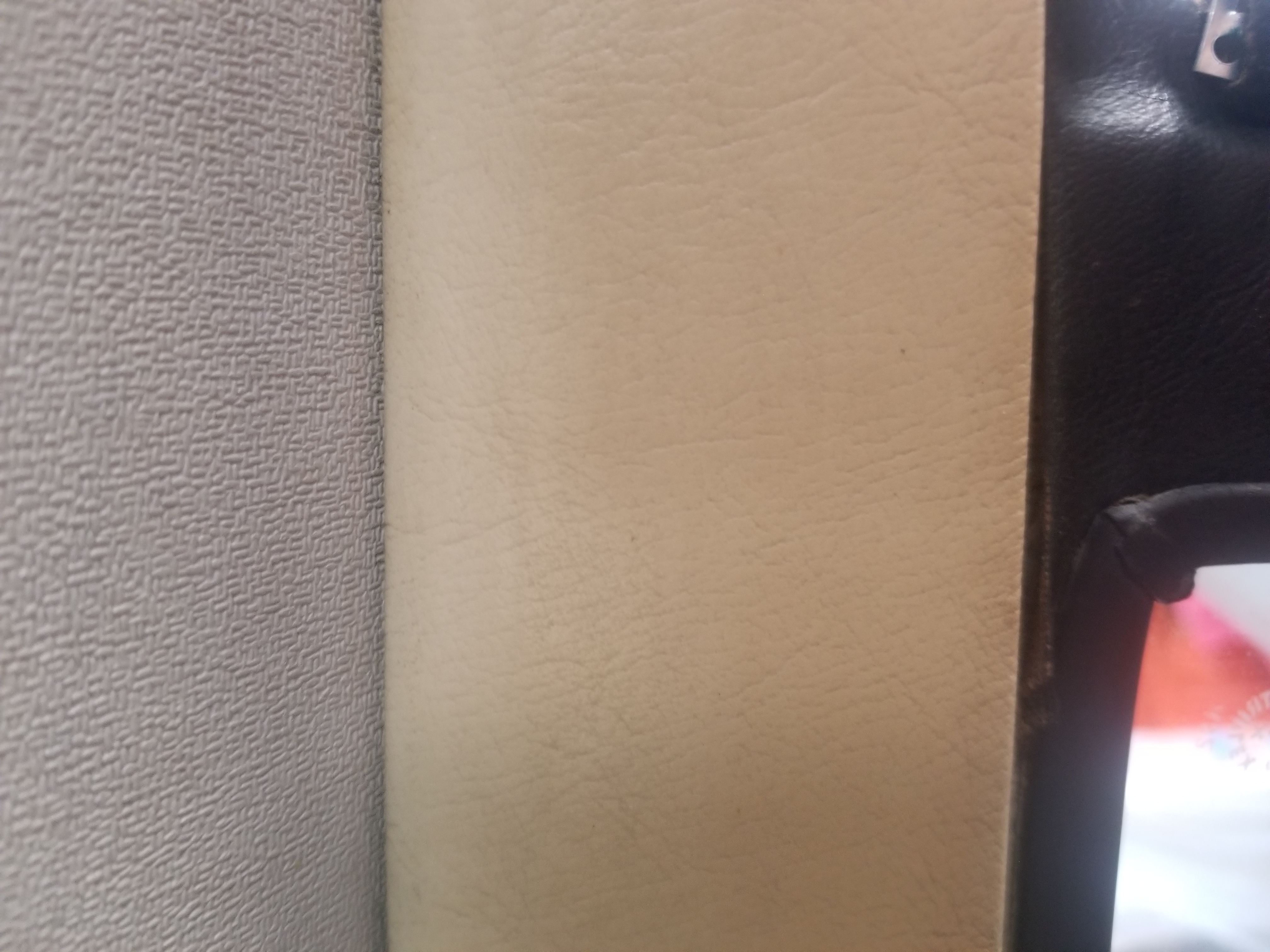

Maybe different on later cars but I see no way of removing the front or side rails.
vping
Bronze
Maybe someone out there has a picture of these removed.
