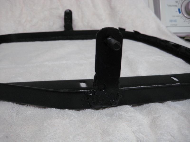

I am 6'3" and have never had an issue with leg room in my BT7 using the original location of the seat rails. Everyone is always amazed that I fit into the car.

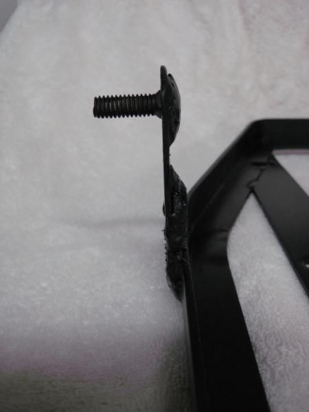

I did have an issue with head room when the top was up and also seeing out of the windshield. I was always looking out the top one or two inches, just below the top frame piece. I solved those problems about 35 years ago by modifying the lower sear frames by moving the hinge bolt vertically about 2", allowing the rear sear back to recline several inches. Now with the seat slider in the rear most position, I have plenty of headroom and my view out the windshield is about 4" below the top frame piece. I've included a few photos. The metal piece is about 1" x 2-1/2" X 1/8" thick and is welded to the ear that held the original hinge bolt. I used a carriage bolt for the hinge bolt (same size of the original). Just last year I welded some additional taps to the rear of the lower seat frame to stabilize the seat back. Previously, the seat back only rested on the center tabs of the bottom frame. This modification made a huge difference in the comfort of the driving position. Not sure you can see the difference in the seat back angle in the first shot, but it's has a least 2" more rake than original.

my question here was based on what i have been able to try. my seat rails are in bad shape with broken studs on them so i can't mount them in the car. i also wanted to wait until i have the engine in to put them in anyway so i am not crawling over them. since i bought the car in boxes i have never sat in it or know exactly how far the seat goes back. but i figured if it was an issue, someone on here has come up with a trick to make it better.
i do like the tilted seat idea. one thing that killed my back on the TD was sitting up so straight. i may have to try that one after i get the seats in.
