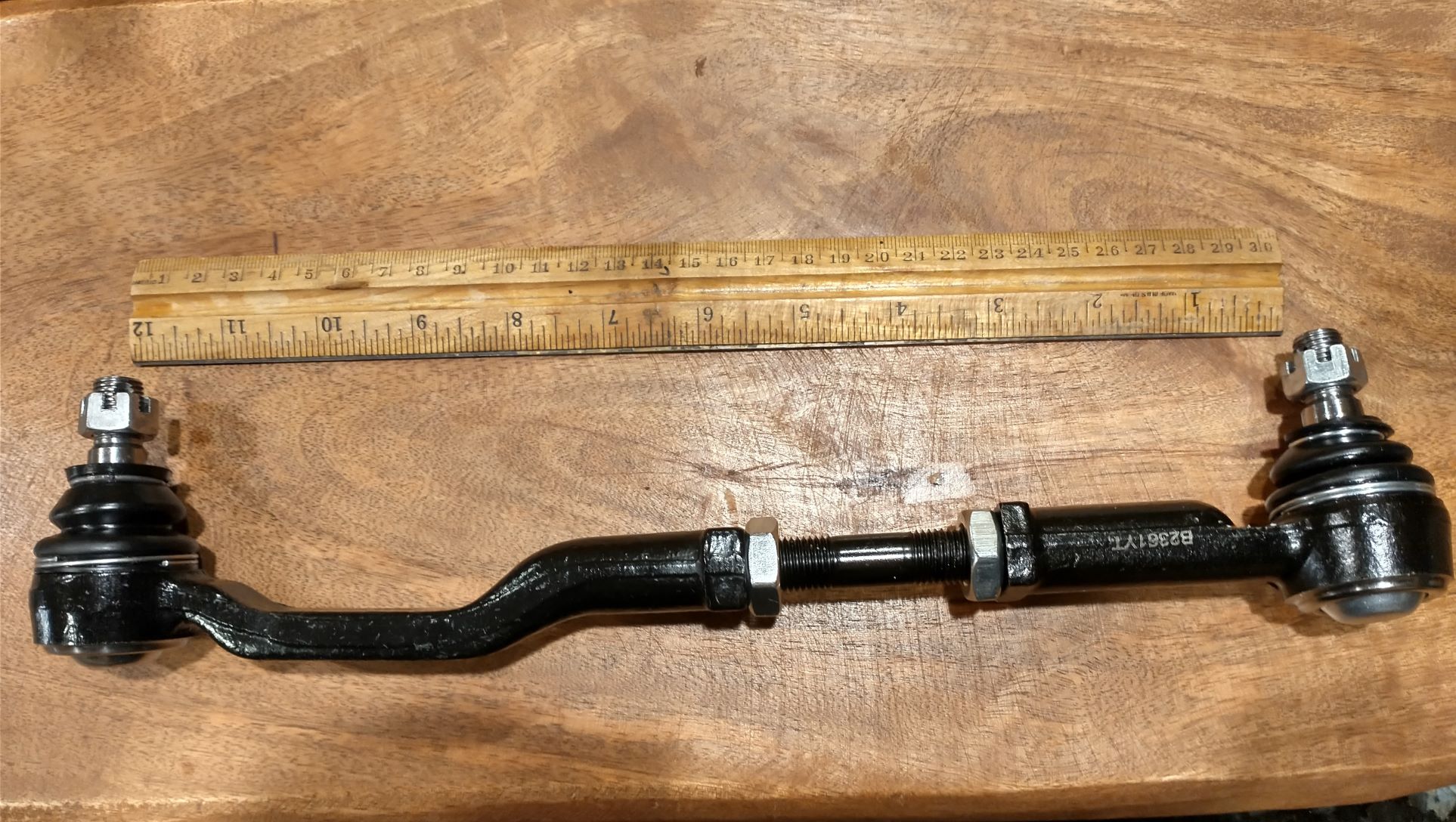

Here is a picture of the Mazda B2200 tie rods. They look like a good quality option. Two rods for $58, not bad.

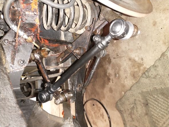

I did a test fit. It does sit up a little bit higher that the original, but it does snug up very tight. For a steering rod I think it would be good.

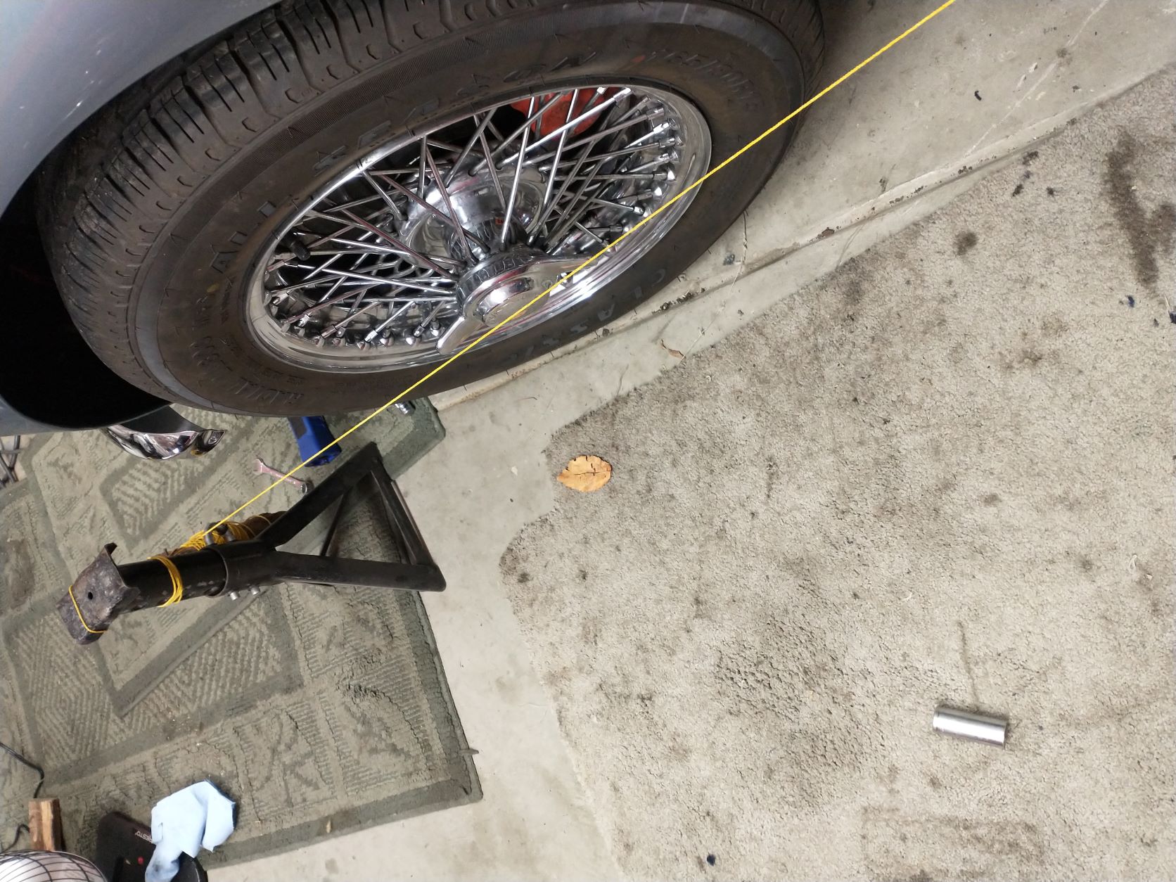

This is my front toe measurement technique. You can measure to within 1/32" The rear width is .6" wider on one side so have the line .6" away from the front spinner and just touching the rear spinner.
