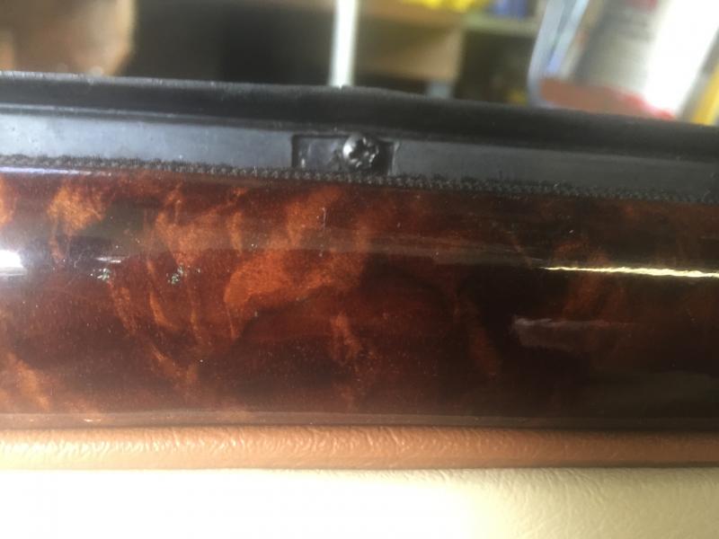

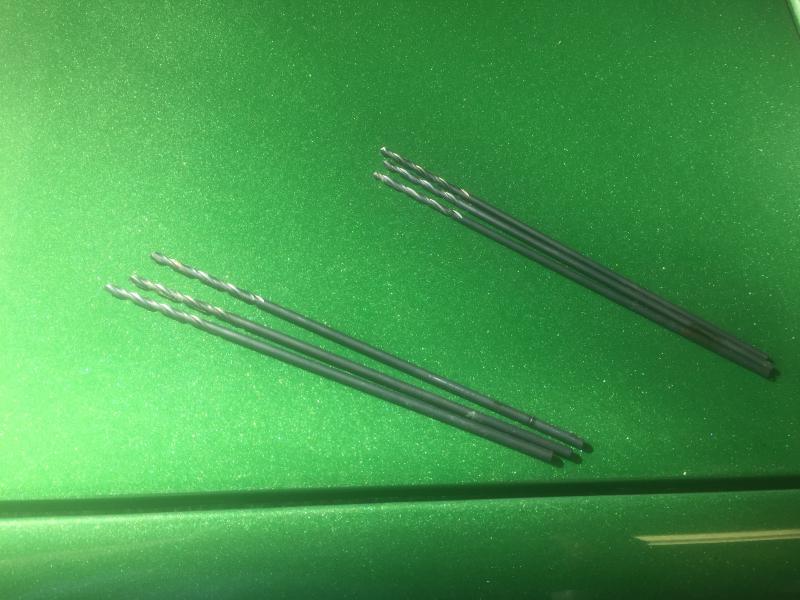

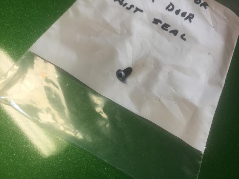

First I drilled the 1/8" in the seal strip. Then holding the strip in place I used the first holes as guides to drill the 7/64" holes in the door flange. Last I screwed the strip in place. I used the longer drills to avoid hitting the door cap with the drill chuck.
