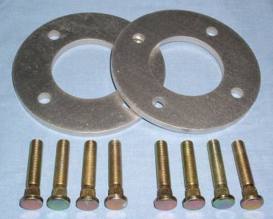

One of our VTO wheels dealers, Dave Patton at Futo Fab which specializes in Datsun 510, and 240Zs, the Datsuns have the same 4x4.5", or 4x114.3mm bolt patterns as the big Triumphs and MGBs, so'll these will work on our cars, and are drilled to be the correct bolt pattern specific. Dave offers them 1/8", and 5/16" thickness. His website is www.futofab.com here's a picture of them.
