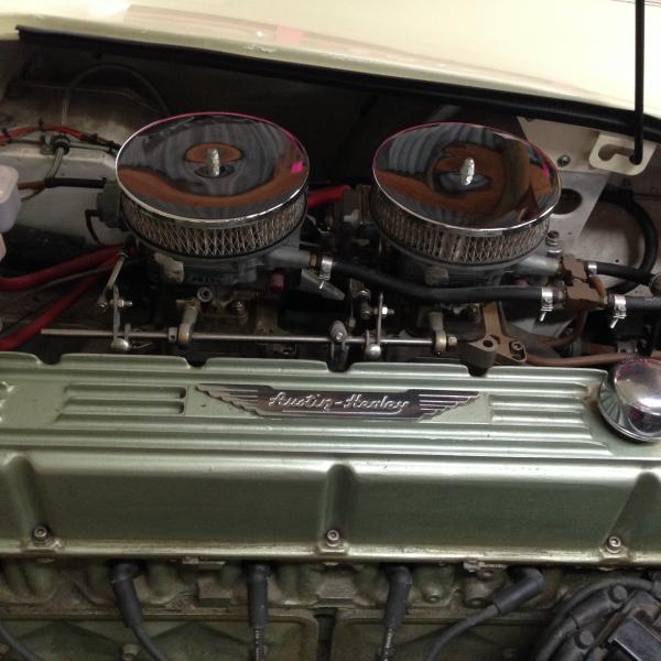

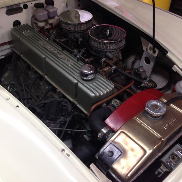

no it has a 250 inline Chevrolet six cylinder motor and tremec 5 speed transmission. this combination must be even lighter than a small block chevy or ford engine!

steve, i will post a few pictures in a couple of weeks. the car was not nearly as nice as it was depicted. the owner allowed brake fluid to leak onto the drivers side front fender apron, foot box area and frame rail. so i am in the process of cleaning and repainting. the engine was worn, but i was able to locate a rebuilt hot rod inline six 250 motor sitting in a local shop. i have installed new gauges, new wiring harness and several other lesser items. i am going to move the engine back about an inch to make room for a puller electric fan. one major surprise was that the drivers side foot box had been cut and modified for clearance for the slave cylinder. i replaced the slave cylinder with an internal hydraulic throw out bearing and rewelded the foot box. so i have been busy. i will paint the engine healey green and add a finned vale cover and side covers and i hope this gives a nice engine compartment when finished. with the mods to the engine i bought as well as adding a hei distributor. headers, four barrel intake and holley carb i am hoping for about 225 horsepower. with the tremec five speed I expect this to make a nice cruiser.
This is a 250 Chevy with twin 2 barrels. Hope the photos post.
Definitely lighter than the Austin engine.

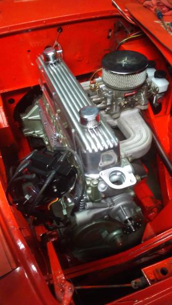

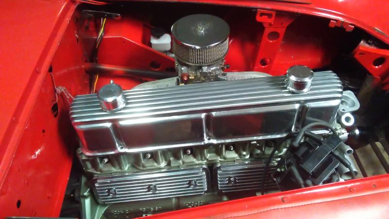

still lots to be done but coming along. a couple of pics of progress in the engine compartment! progress to me, maybe not to the purists?
