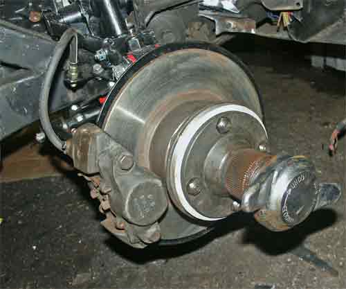

You can use them on an MGB that has bolt on wheels. You need to buy the special nuts that hold them on, and to avoid having to saw off your studs (rendering the conversion irreversible without fitting new studs) you can have some 7/16" spacers made up.
MGB front hubs with the foregoing fitted:
On the car (I did this on my Jamaican bodied MGA that uses MGB brakes)
