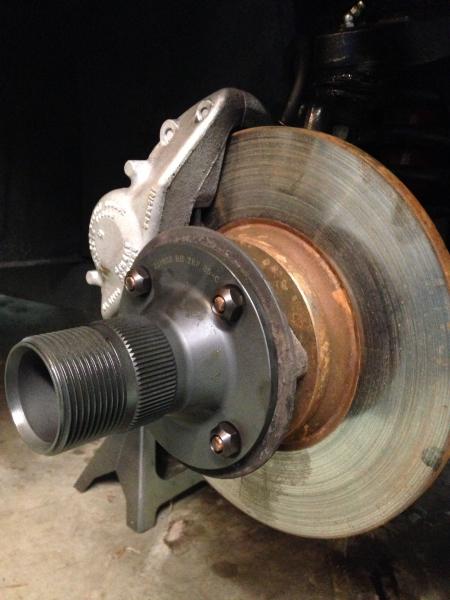

I have replaced my hub extensions for wire wheels, but can't find the recommended torque in the workshop manual.
appreciate your input.

65 ftlb per the TR4 workshop manual.

Glad to see you got them (that one anyway) on the correct side of the car.
