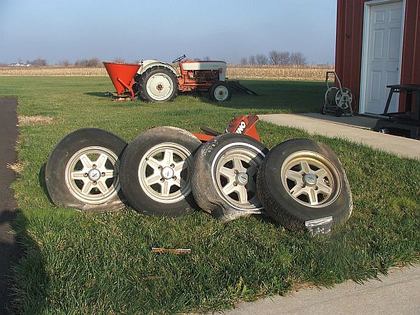

There are several styles of Datsun wheels...they may use different styles of lug nuts.
I picked up a set of "Snowflake" Datsun 280ZX wheels yesterday. The lugs had a large shoulder on them.

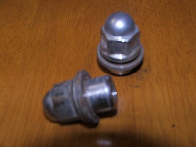

Here's a picture of the lugs.

Rick, can you measure from shoulder to the end?
14mm, including the thickness of a 3mm washer.
This measurement is to the bevel, not to the end of the lug.
