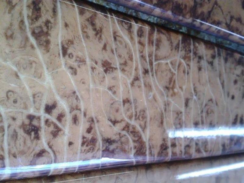

My veneered alloy door inserts on my 99 XJ8 have a lot of cracking.
What is the Varnish used on these trim pieces?

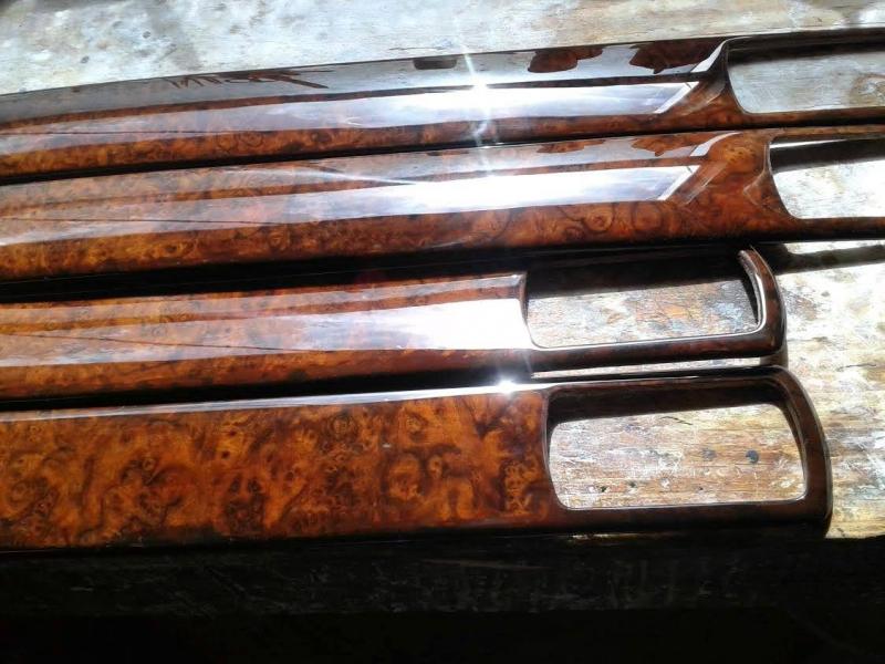

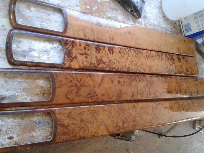

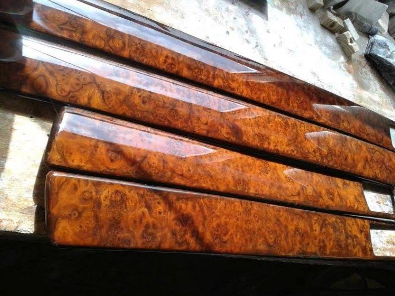

Hello,
The finish used on all post 1973 Jaguars is Polyester. It is used over a two part Polyurethane barrier coat, and applied wet on wet at certain intervals. In the factory enviroment it is UV cured. The doors are notorious for cracking on the X300/X308, but even the worst looking items will usually stand refinishing, without getting into re-veneering them xjdoor2.jpgxjdoor3.jpgxjdoor4.jpgxjdoor5.jpg. Often for the budget minded, it is cheaper to buy used wood off ebay or wherever, but will never be as nice or match as properly refinished parts that are original to your car.
