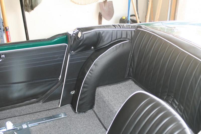

On the TR4 the sticks are covered by the upholstery that forms the entire seat back (or what would be the seat back if there was, in fact, a seat. The whole thing remains attached to the body and lifts up and back over the boot when the stick need to be put away. There are also two small panels (also permanently attached) covering the sticks that lift off to the sides.
Here's a photo of those pieces in place (along with the wheel arch covers, the dog-legs and the carpet).
Looking at the Vicky Brit catalog I see those three pieces (page 47, heading 'SEATS') shown in a box labeled 'TR4 Non-Hardtop' and offered for 199.95 (vinyl) or 449.95 (leather). I believe vinyl was original even on cars with leather interior. Those three pieces illustrated are what covers the sticks. It is a complex set of upholstery, piping, snaps, foam padding and cloth backing that I would not expect a custom shop to be able to duplicate for under $200.

They are a pair of flaps that are permanently attached under the capping. They lift away to tuck in the sticks, then snap down to cover the sticks but leave the knee-joint exposed. They are a fairly complex shape to do all this and still present a neat look when in place.
...However, your picture does raise another question - how did you get the seats out without unbolting the entire frame?
Mine is a late TR4 - the seats are hinged at the front and both can be lifted forward for access to the back. The hinges are just two bolts per seat and are easily removed, then the whole seat comes out. Since you have to ask I assume yours is an early TR4 which essentially had TR3 seats (fully nutted to the tracks).

Here is a picture out of my interior, right after I had installed these pieces. Maybe a slightly clearer view than Geo's. The drivers side is reverse.
