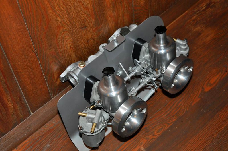

Here are pics of the HIF6 and HS2s.

Hap hooked me up with an early intake for the HS2s(better flow)
and then he ported the thing to match my GT7 Longman head.
It's bad to the bone.
:devilgrin:
