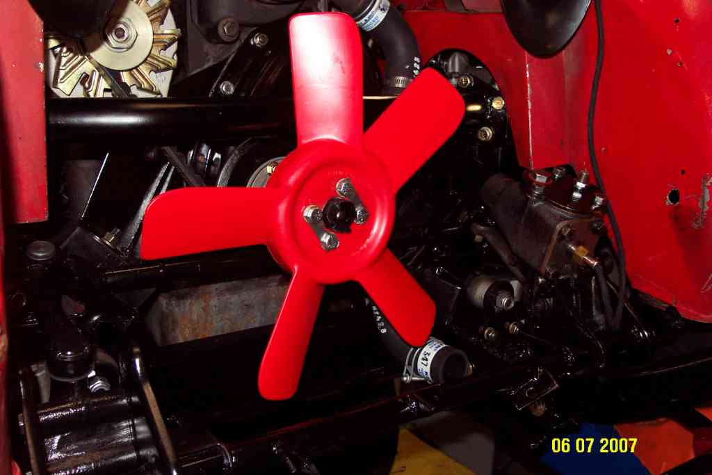

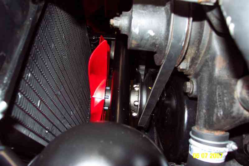

PeterK
Here's an old shot, you've probably seen it. Kind of shows the kit with the lock tabs.
I used a new fan kit from TRF. Since theirs fits TR2-TR6, the inserts are probably already shorter to accomodate the TR6 plastic fan. Not saying that I know the plastic fan is thinner, but probably.
Yes, I had to elongate/slot the mounting holes in the fan a bit but plastic was easy to work.
https://home.myfairpoint.net/kentech0822/triumph/bmwfan_front.jpg
