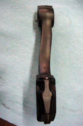

Scuse me - But wet turbos can work very well. One of my projects was a Garrett T3 turbo with a Holley 500 cfm carb on the compressor inlet. The power valve control on the carb was rerouted to externally reference it to manifold pressure instead of intake vacuum.
Since the carb is on the vacuum side of the turbo, & the T3 is oil AND water cooled, no heat problems at all.
The wastegate actuator was connected to manifold pressure via a dash mounted pressure regulator which gave adjustable boost.
Boost variable water/alcohol injection was also applied to the compressor intake. Takes the place of a very efficient intercooler on the pressure side. A MSD6AL ignition with dash adjustable variable boost timing retard covered the ignition.
About 50 HP worth of nitrous oxide injection was set to come on at full throttle & cut off at 12 PSI boost. No turbo lag. Boost could be adjusted up to 20 PSI while driving, with no detonation on premium gas.
Needless to say, the entire engine was extremely over built to withstand about 400 HP from a 140 cu. in. engine.
The only real problem was that at full throttle, the stock prepped rods bent fore/aft into an S shape. See attached pic. A new set of Crower I beam rods cured the problem.
Some of the old stuff wasn't so bad, just different.

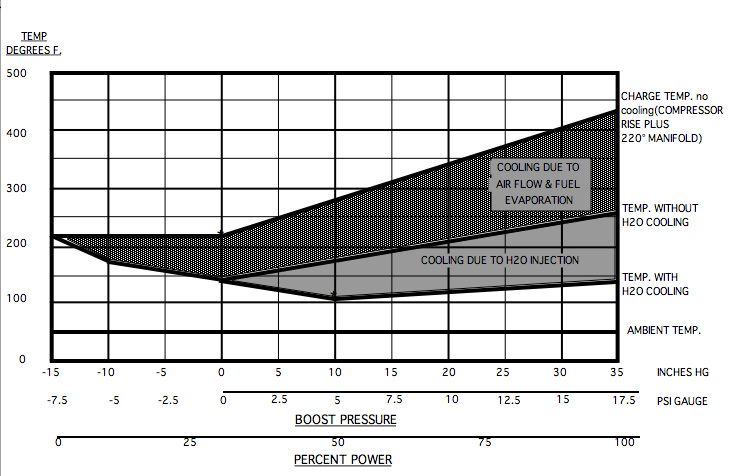

Wet turbo again.
Here is a graph of actual charge temperatures on the 2.3L Ford. I actually installed thermocouples at the intake manifold to head interface.
Interesting how much the wet charge & H2O injection cooled the intake charge.
