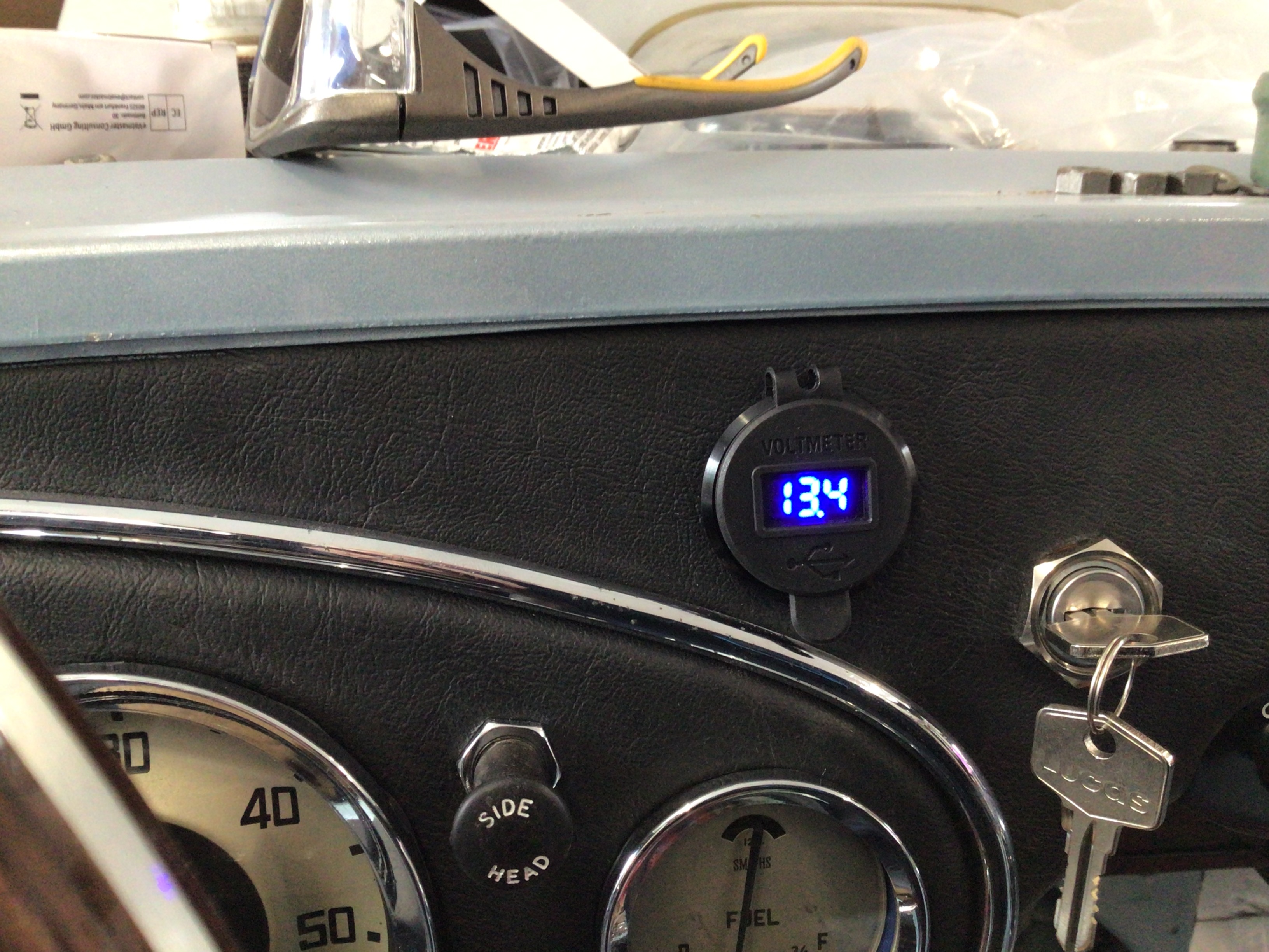

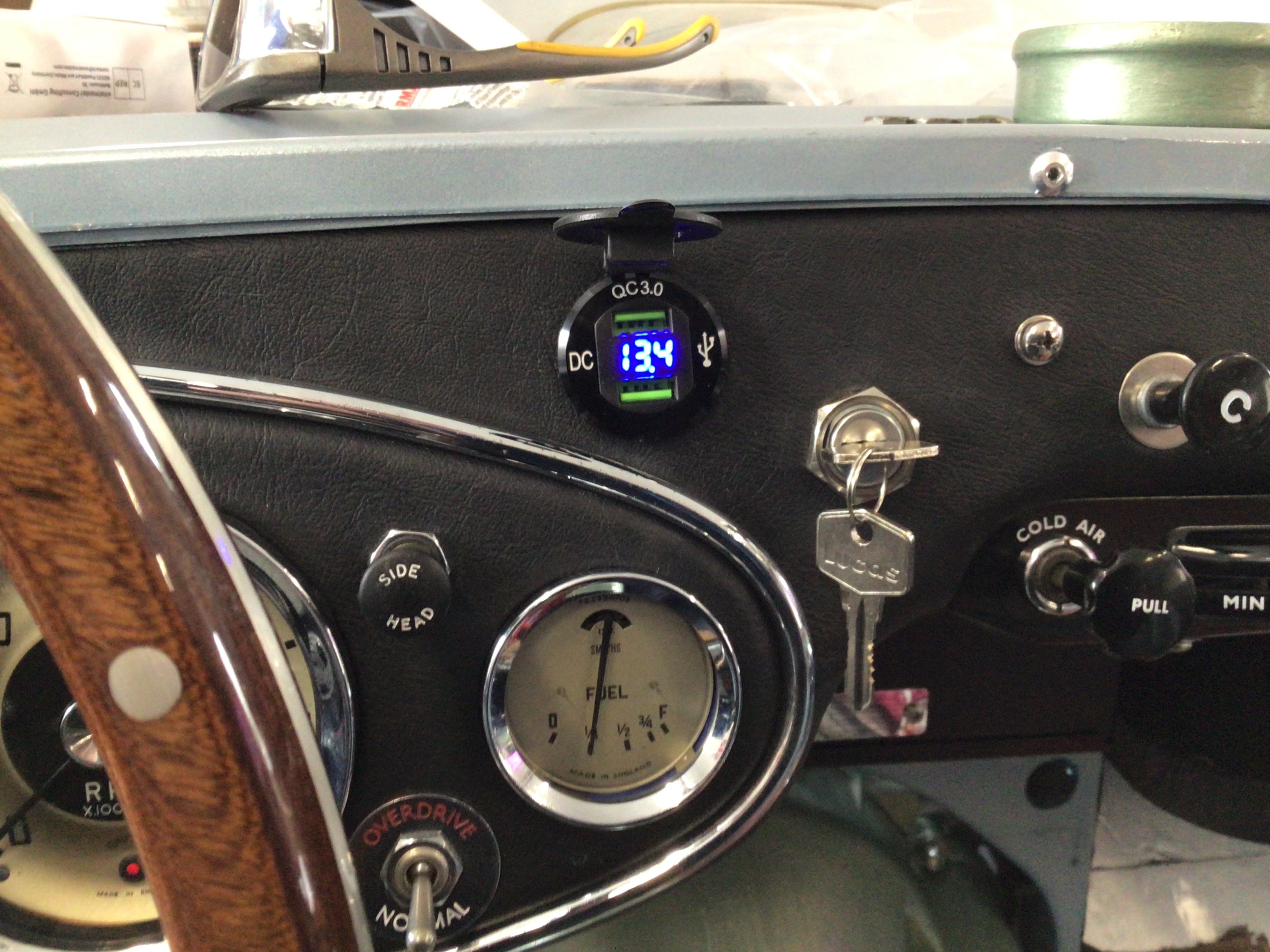

Added a modern touch to the dash.
I know I could have added a period-correct volt or ammeter. Then I would have had to add a bracket etc., etc.
This gives you dual USBs for all kinds of goodies and was an easy add, and being black it blends into the dash.
Amazon if anyone is interested.

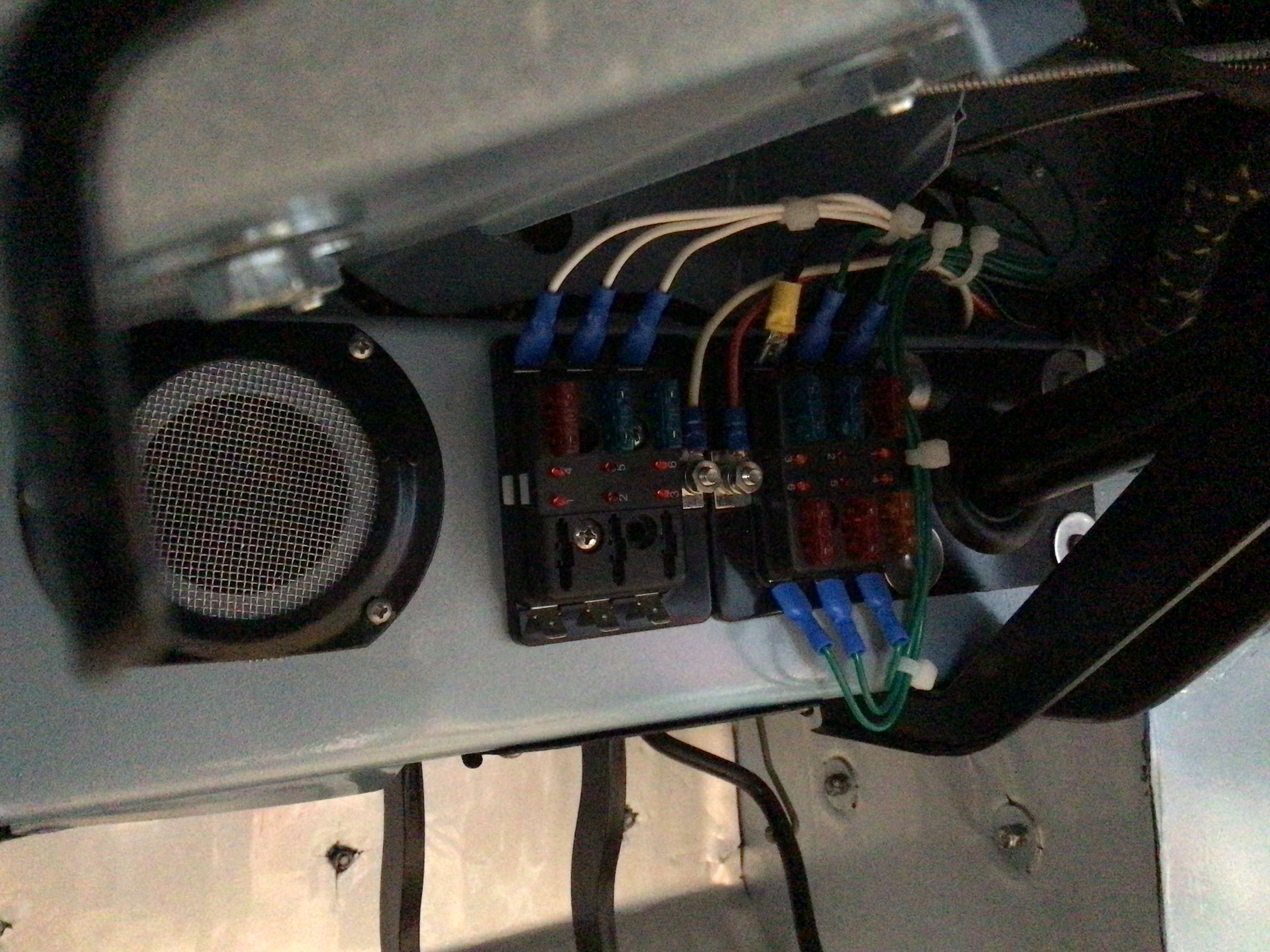

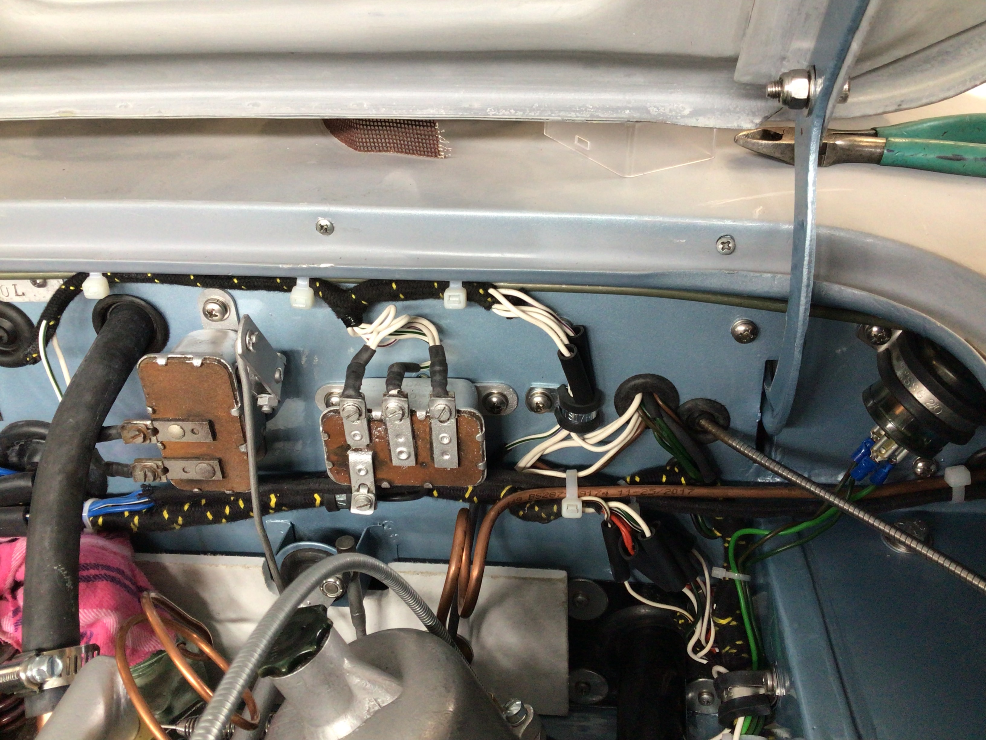

Wiring reconfigured with separate fuse panels , also inline fuse added at rear licence plate lamp .
firewall wiring cleaned up .
spare fuses available for future goodies .

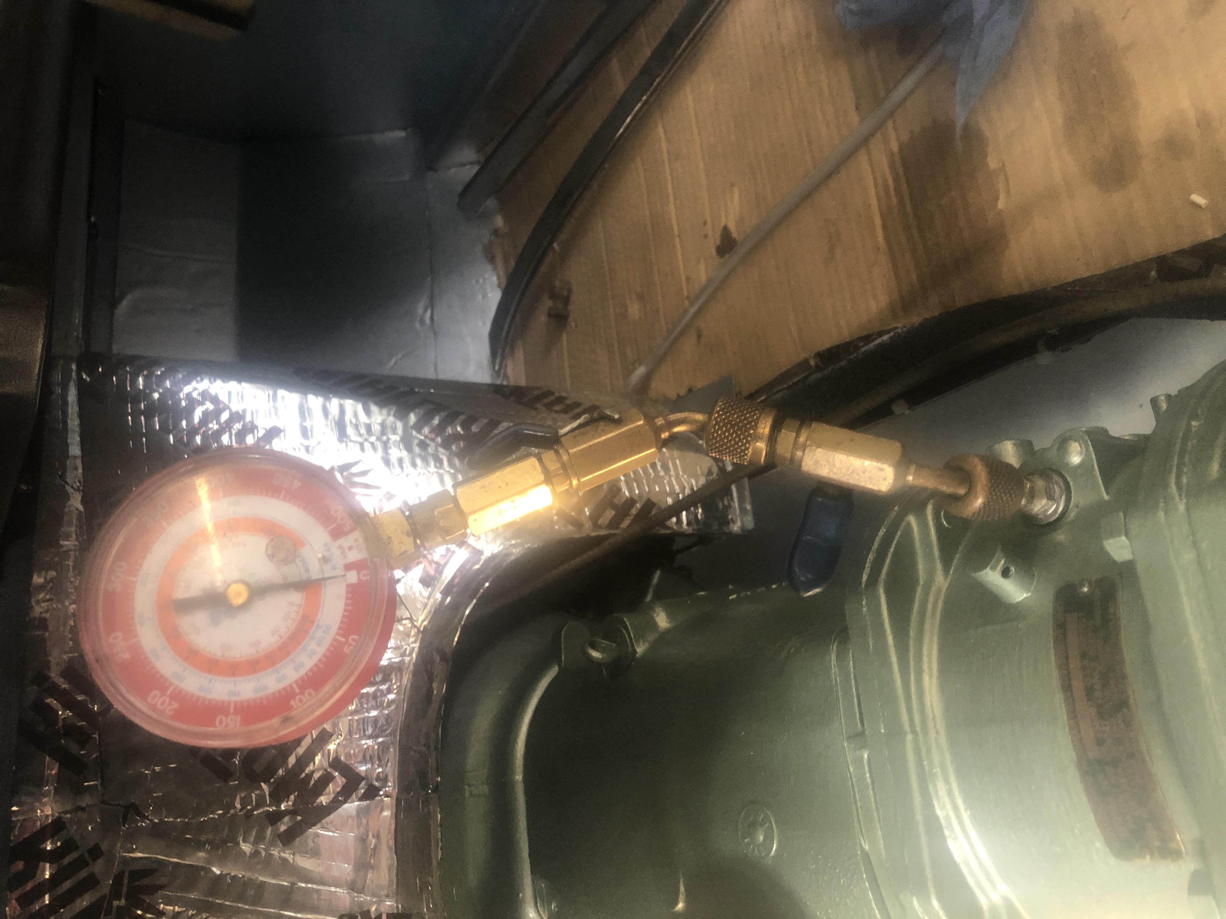

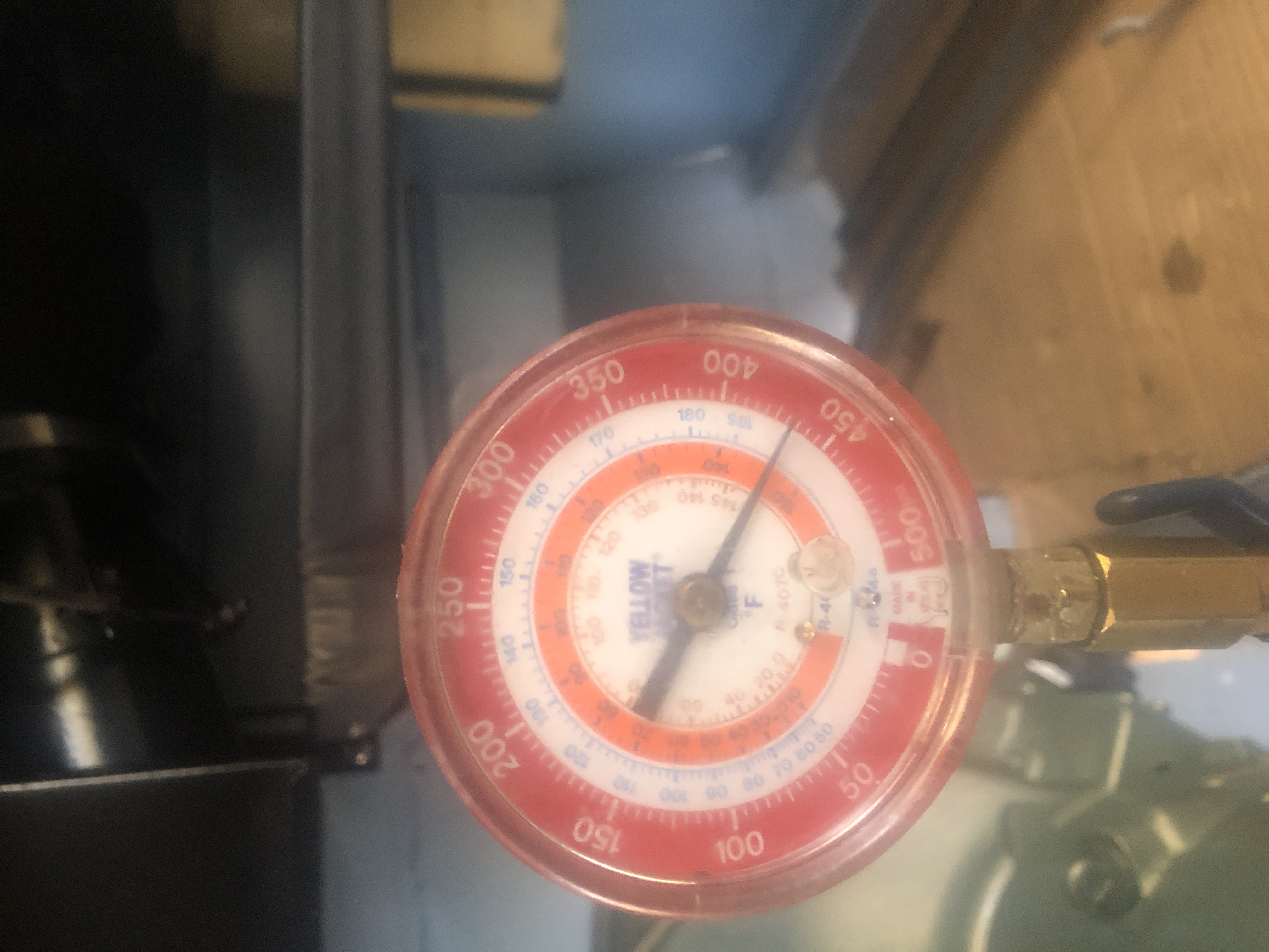

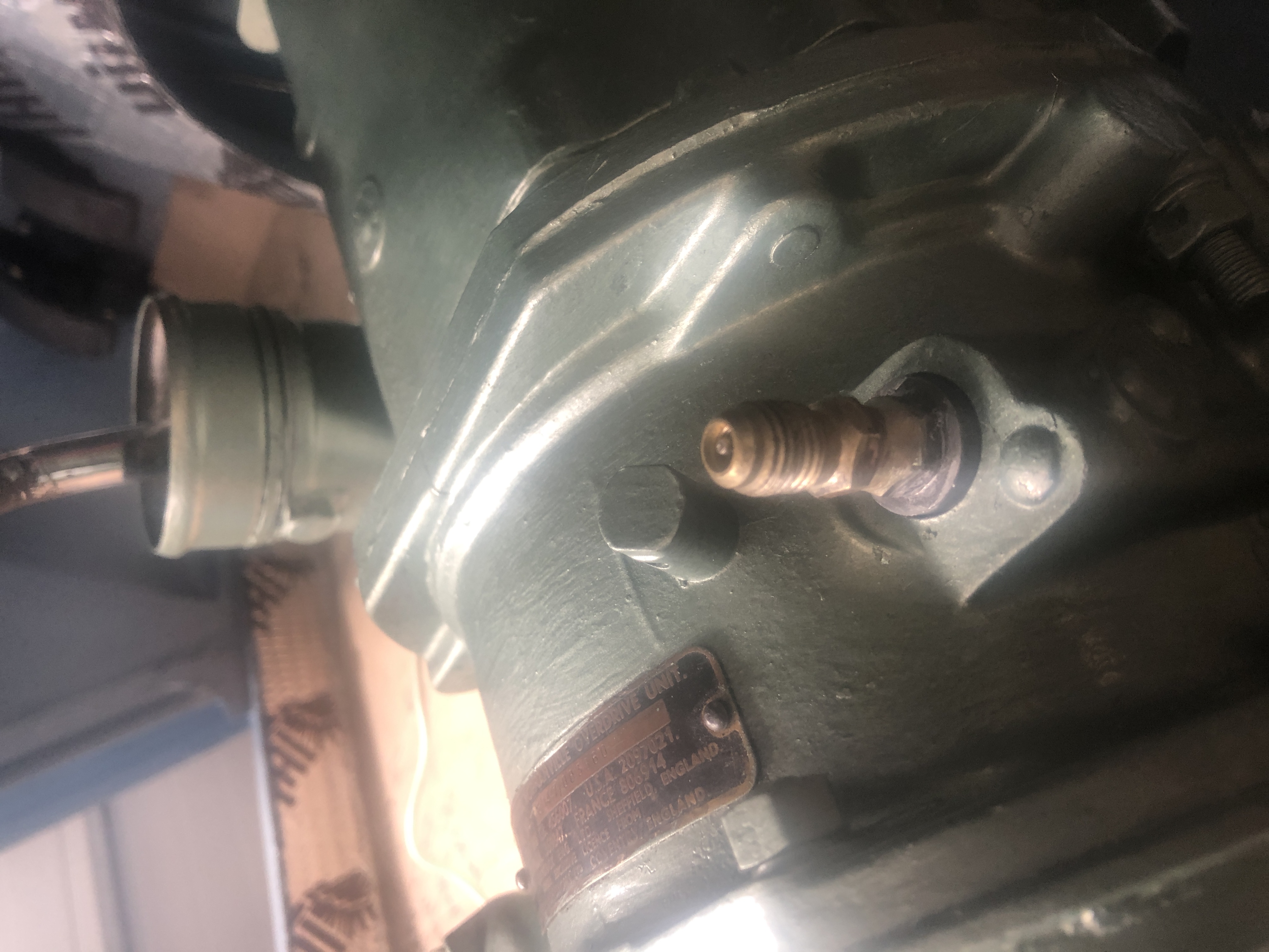

Well that sucks , zero oil pressure from the OD . SUSPECT I have the oil pump cam lobe on the wrong way round .
looks like the OD is coming out .
OH JOY !!!!!
I was right some rookie OD builder put the camlobe on backwards . Now fixed , beer time .

Leave the side cover off with the accumulator piston spring and housing removed as well. Make sure the cam lobe is at the flattest point on the bottom where it meets the pump plunger .
get the OD back on with all the nuts started on the bolts by the first thread only , this can be a bear as the double spline has to be perfectly aligned just to get it to this point . DO NOT FORCE IT AT ANY POINT .
You should now have about 1/4ā€ between the gasket faces .
Use two skinny long blade screwdrivers to compress the plunger spring by levering on it turn by turn .
once you have it sufficiently compressed have someone give the OD a wiggle and if you have it compressed enough it will slide all the way home without any force .
Quickly tighten one nut and do a happy dance around the shop and grab a celebratory beer out of the fridge . šŸ‘šŸ‘šŸ˜šŸ˜šŸ˜Ž
If the above process and your patience fails your pulling the gearbox out to upend it to complete the OD/gearbox mating .
Ah, a side-shifter. Wonder if something similar would work with a top-loader?
I gave up after several hours of trying last time and took them to BCS. Dave Nock split the O/D and its gearbox adapter, pulled the pump, sat the gearbox on the ground 'face down' and had two of his mechanics pull the O/D and adapter down with large channel lock pliers while he manipulated the output shaft to get the splines lined-up. Then he re-installed the pump; of course, he had 'special' tools to do this.
I used the same technique on my BJ8s , it takes a lot of patience and fiddling but it can be done .
I did it alone on my BJ8s once I had the pump spring compressed I used some tie wraps to hold it in place wrapped around the side plate studs .
Removing the pump would be the simple way if only it was just an unbolt and remove it job .
Once you have the splined shafts lined up, you just need something to hold the pump plunger back; a bent wire or string will do. Put the low point on the cam toward the pump. Separating the transmission and O/D to turn the cam around should leave the splines aligned.
The
The splines stayed perfectly aligned , it was just the last 1/4ā€ to get it over the lip on the pump cam that I had to get the screwdrivers busy to compress the pump spring .

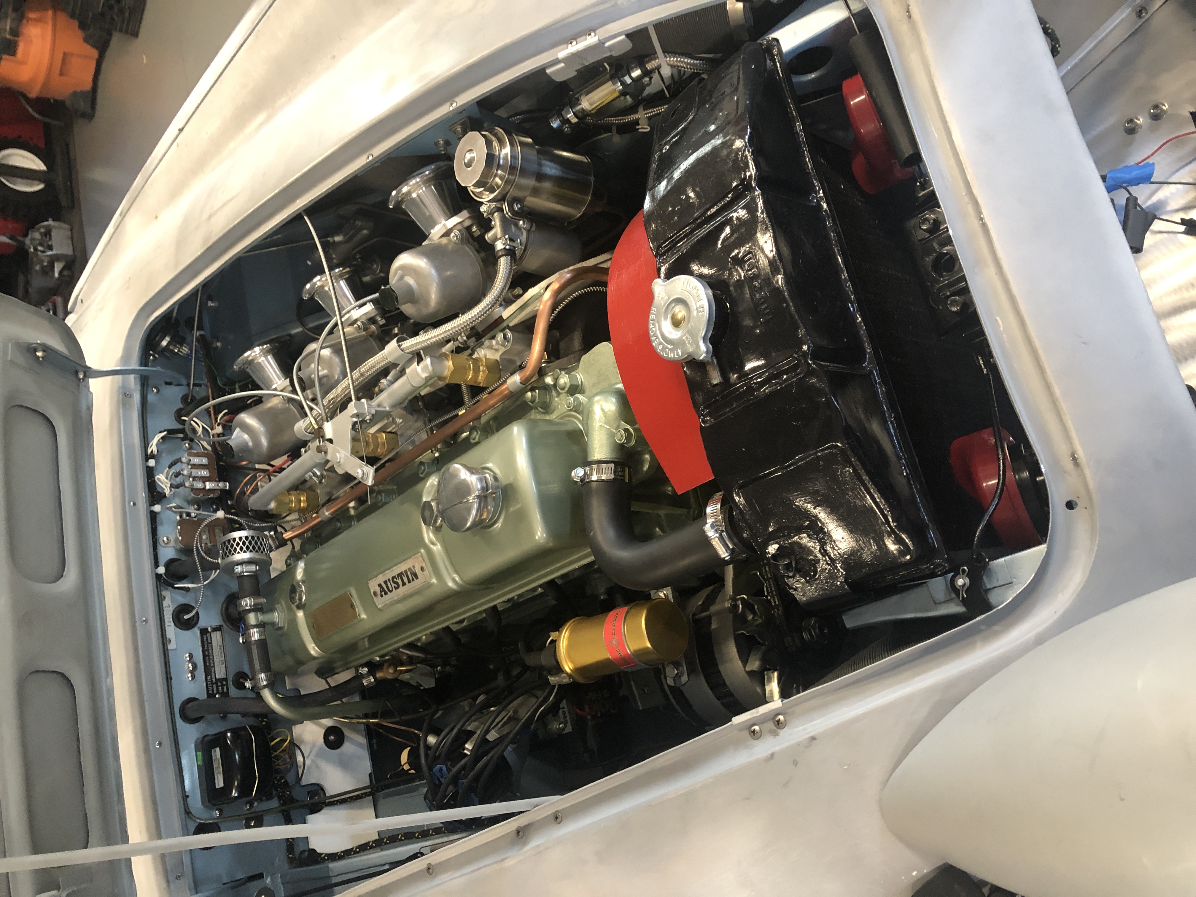

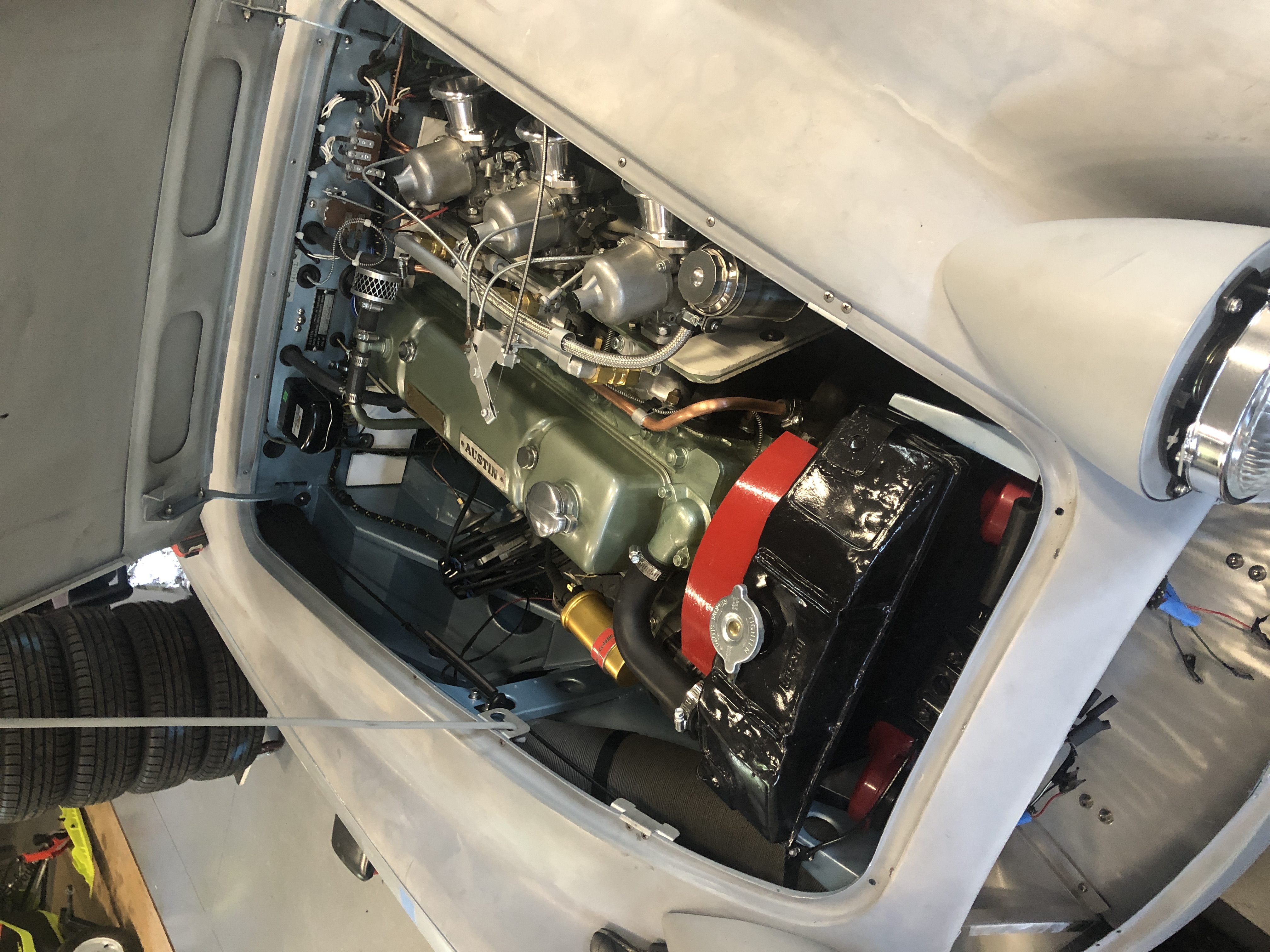

Well I’m going to declare the engine bay done . Some minor touch ups here n there but they can wait till final finishing .
Rocker cover includes my retrofit 2ā€ BSA motorcycle Monza style flip fuel cap modification .
My focus now is to get the exterior body to 80% of filler touch ups sanding prep etc then send her back to the paint shop for her pretty Healey Blue finish .
Purists may need to avert their eyes as they may find the images disturbing šŸ˜šŸ˜ŽšŸ˜Ž
