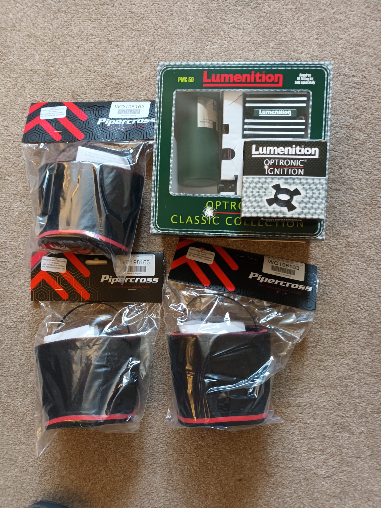

Are you using Pertronix?
No points or condenser. I have a Lumenition kit on order, but won’t get that until I go to the UK in September.
Well, check your dwell. An overheating coil can be caused by too much dwell, but your coil could be defective. I heard Lucas 'sports coils' had issues a while back.
Parts arrived at my friends place in the UK .
Electronic ignition to be installed on my return to Canada later this year .

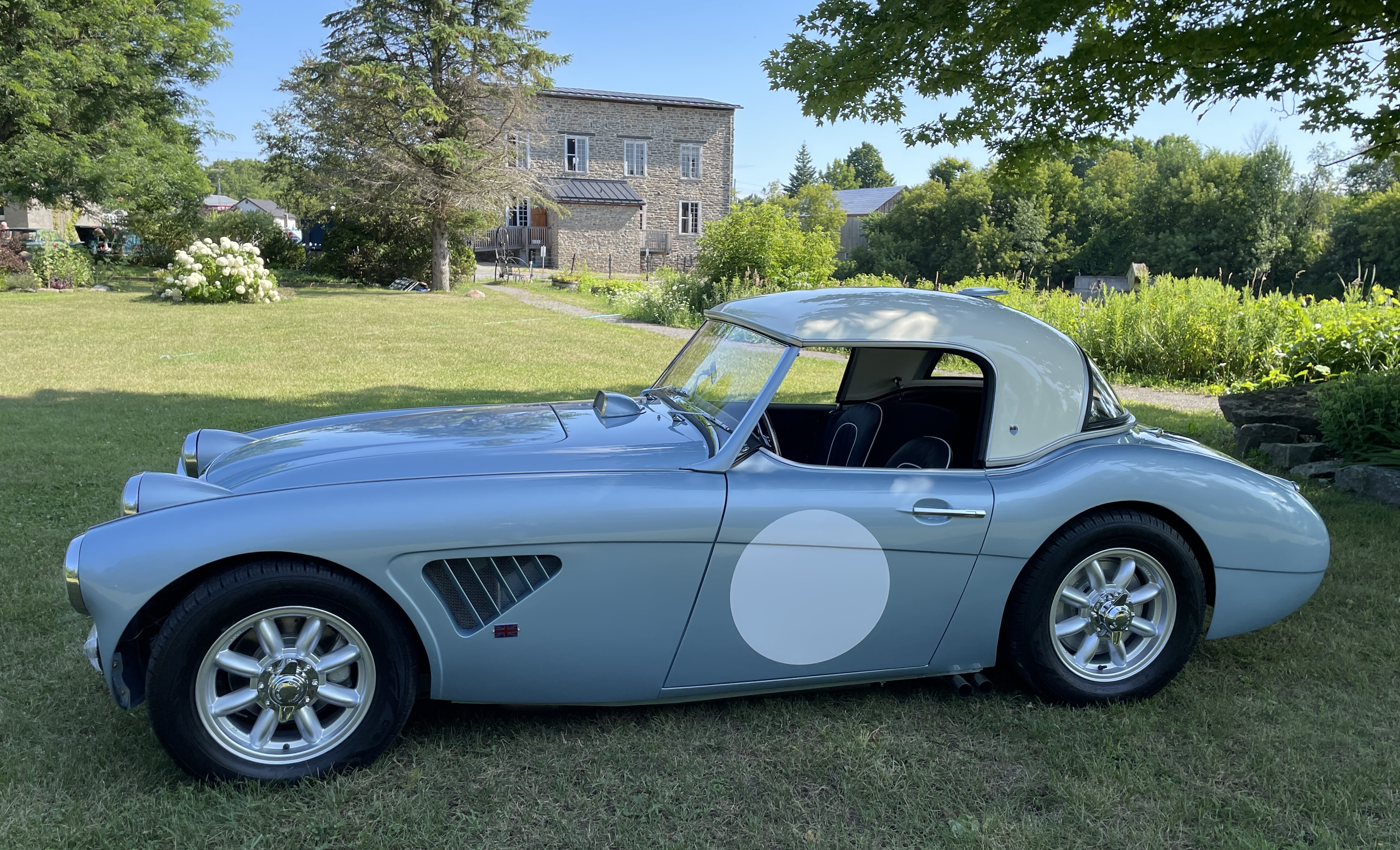

So I’ve been on a few local trips; nothing too far, just getting used to driving a side shift and getting more confident with the car.

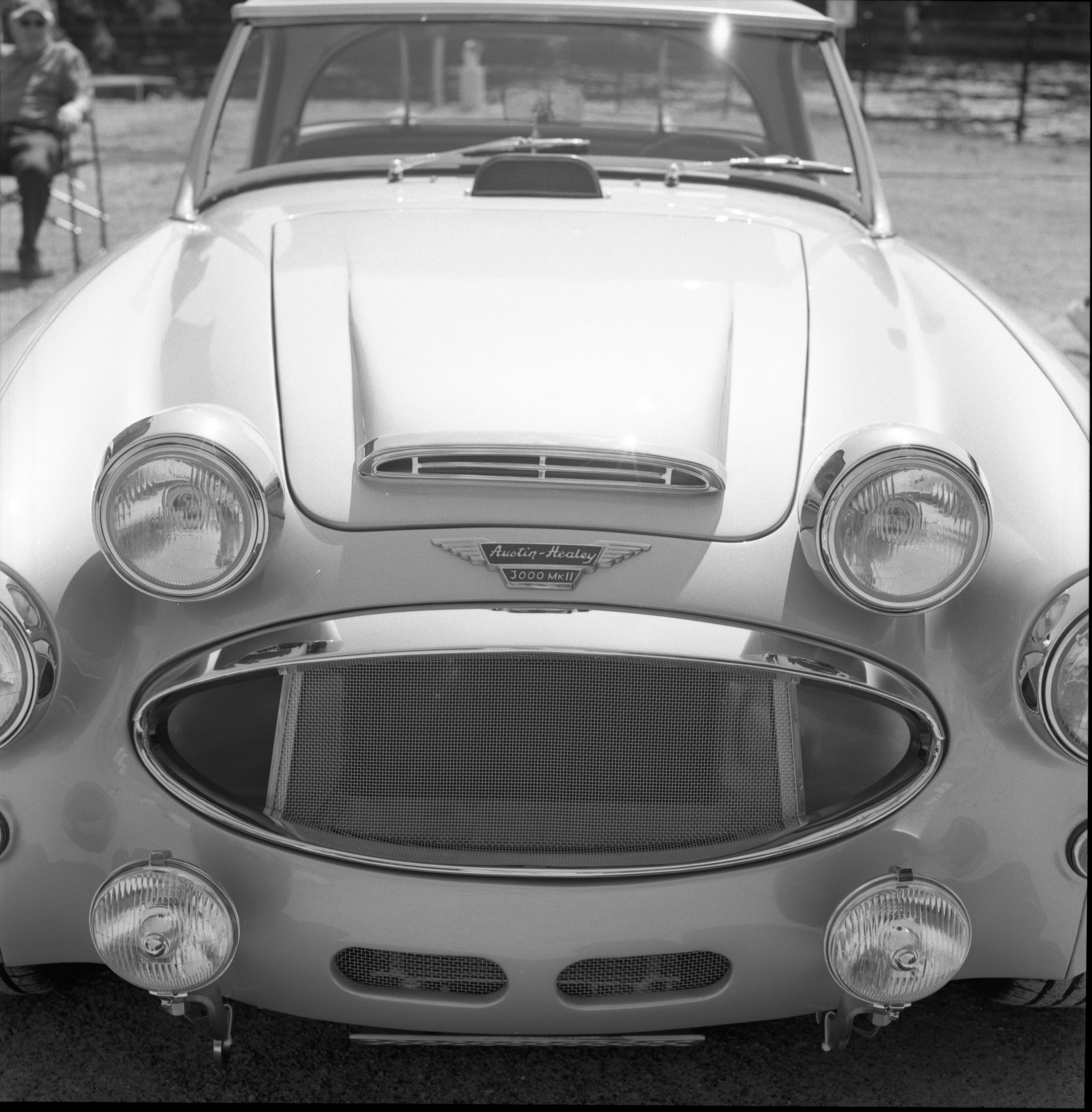

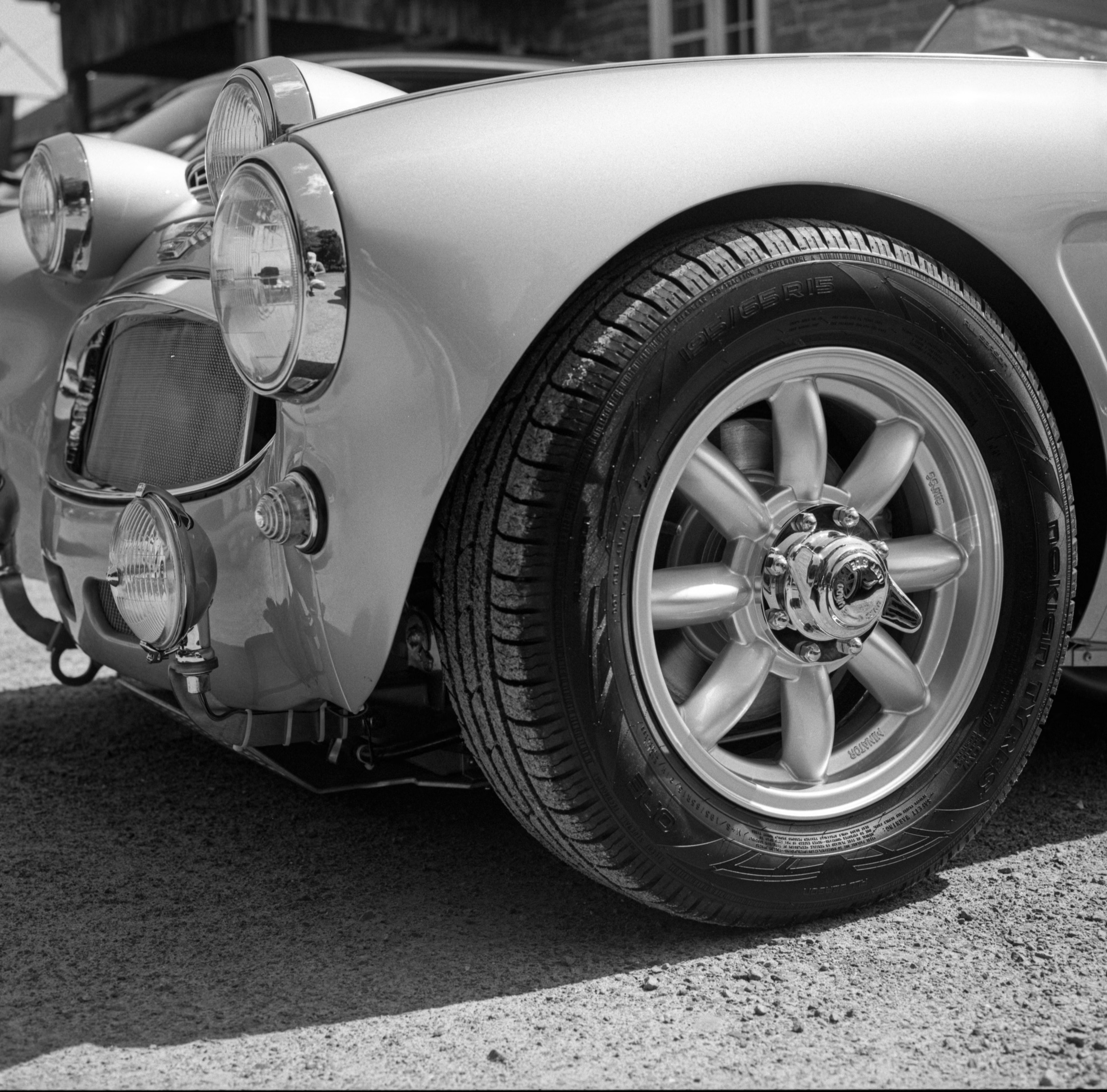

I was at a small local car show and got chatting with a keen photographer guy who was using a 70s box-type camera with real film in it who was taking pics of my car. He also develops them himself. Here’s a couple that he sent me. They are B&W but quite striking.

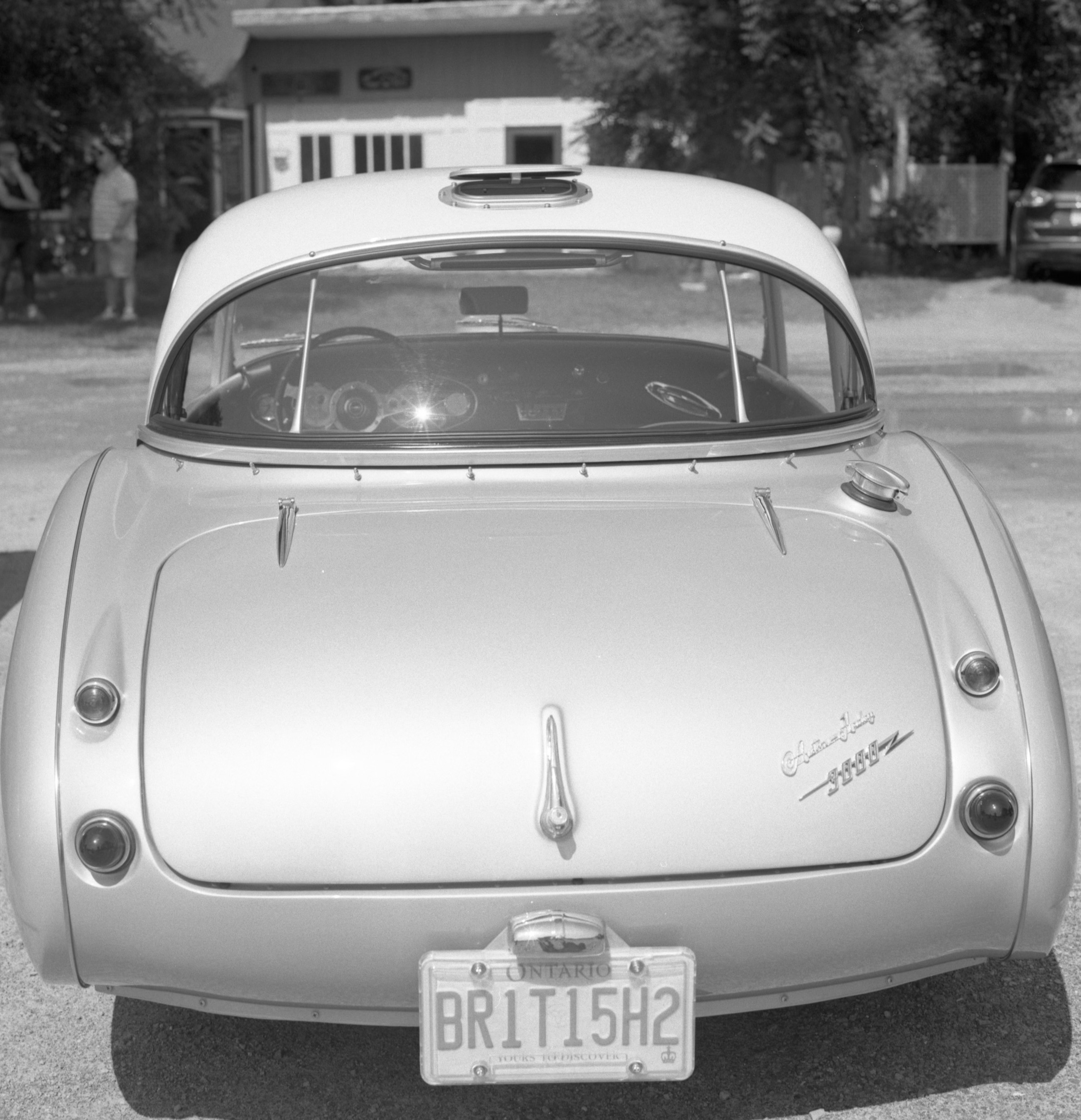

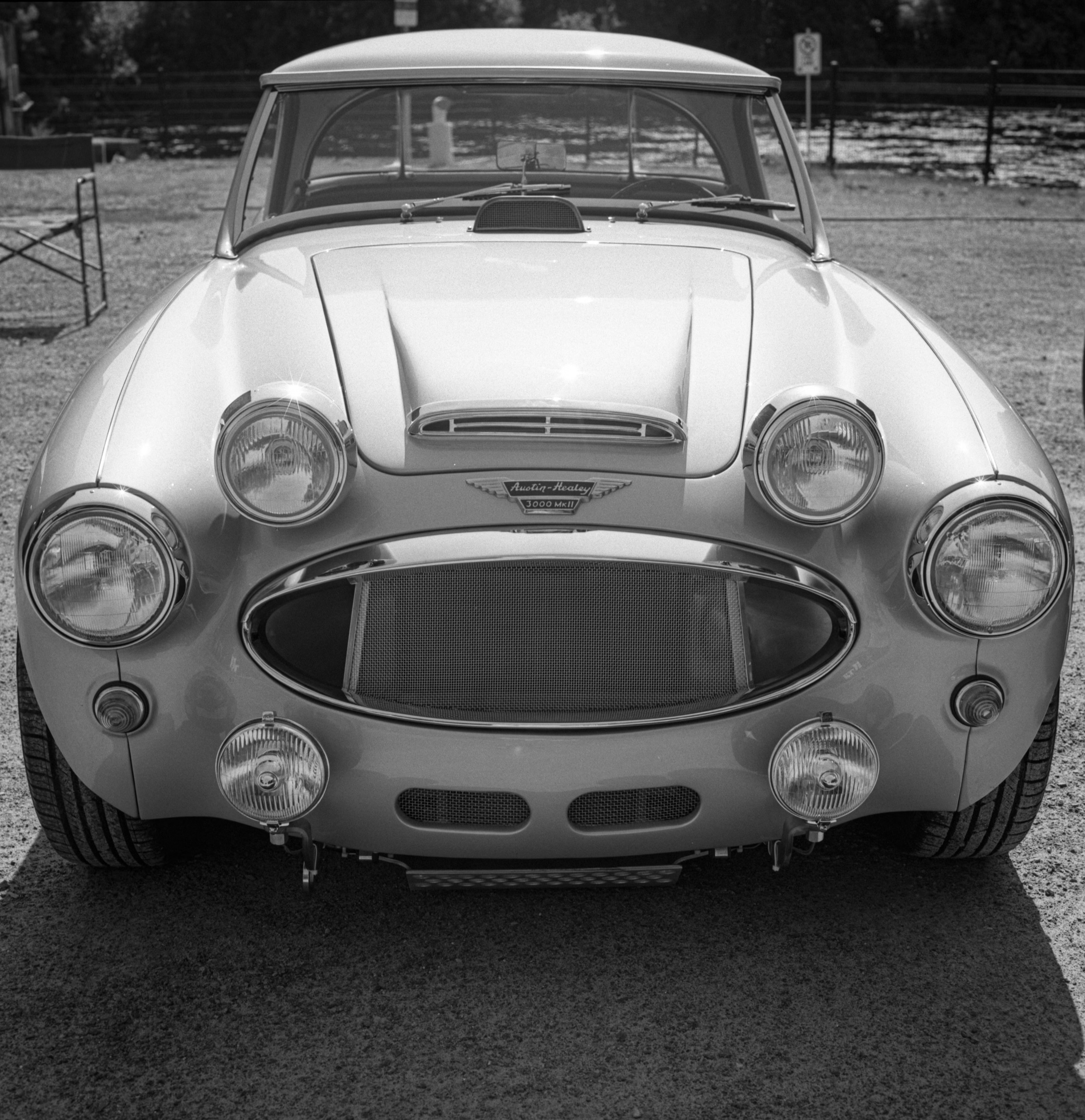

Another couple of the B&W pics sent to me by the same photographer as the previously posted ones .

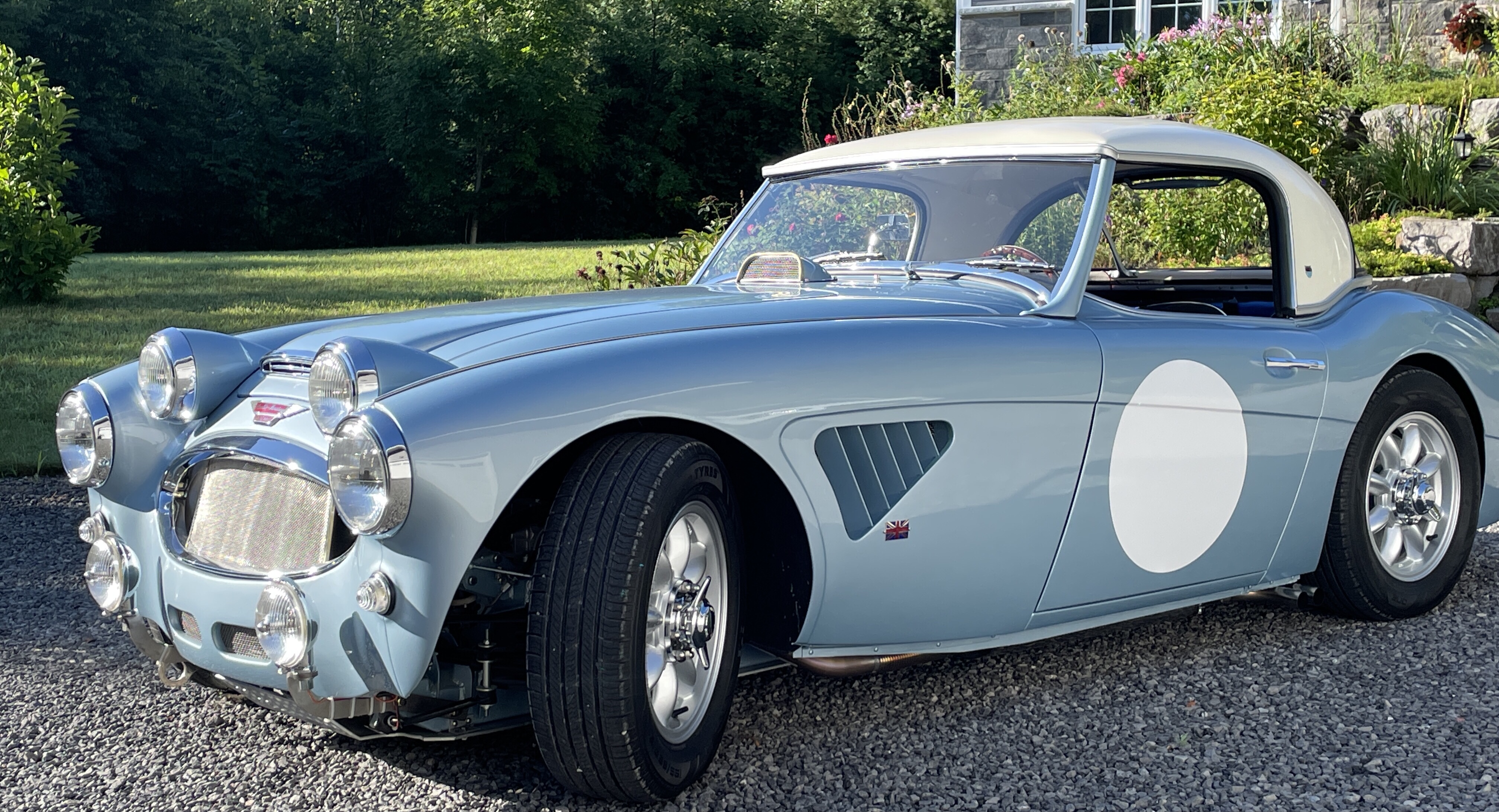

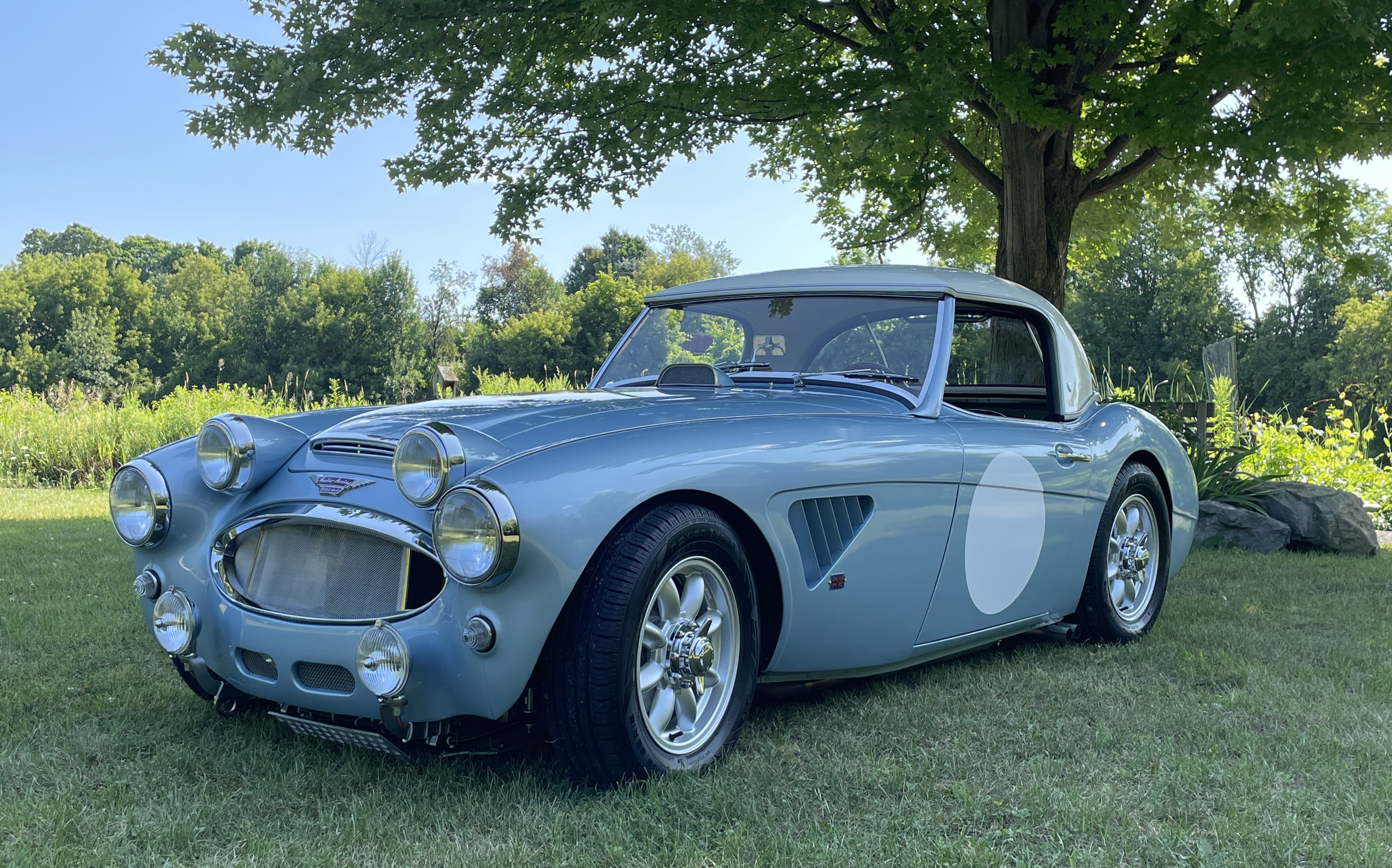

The car does get well admired at car shows .
Im getting better at taking pics of it too .Pity I cut off the rear bit of the fender on this one .

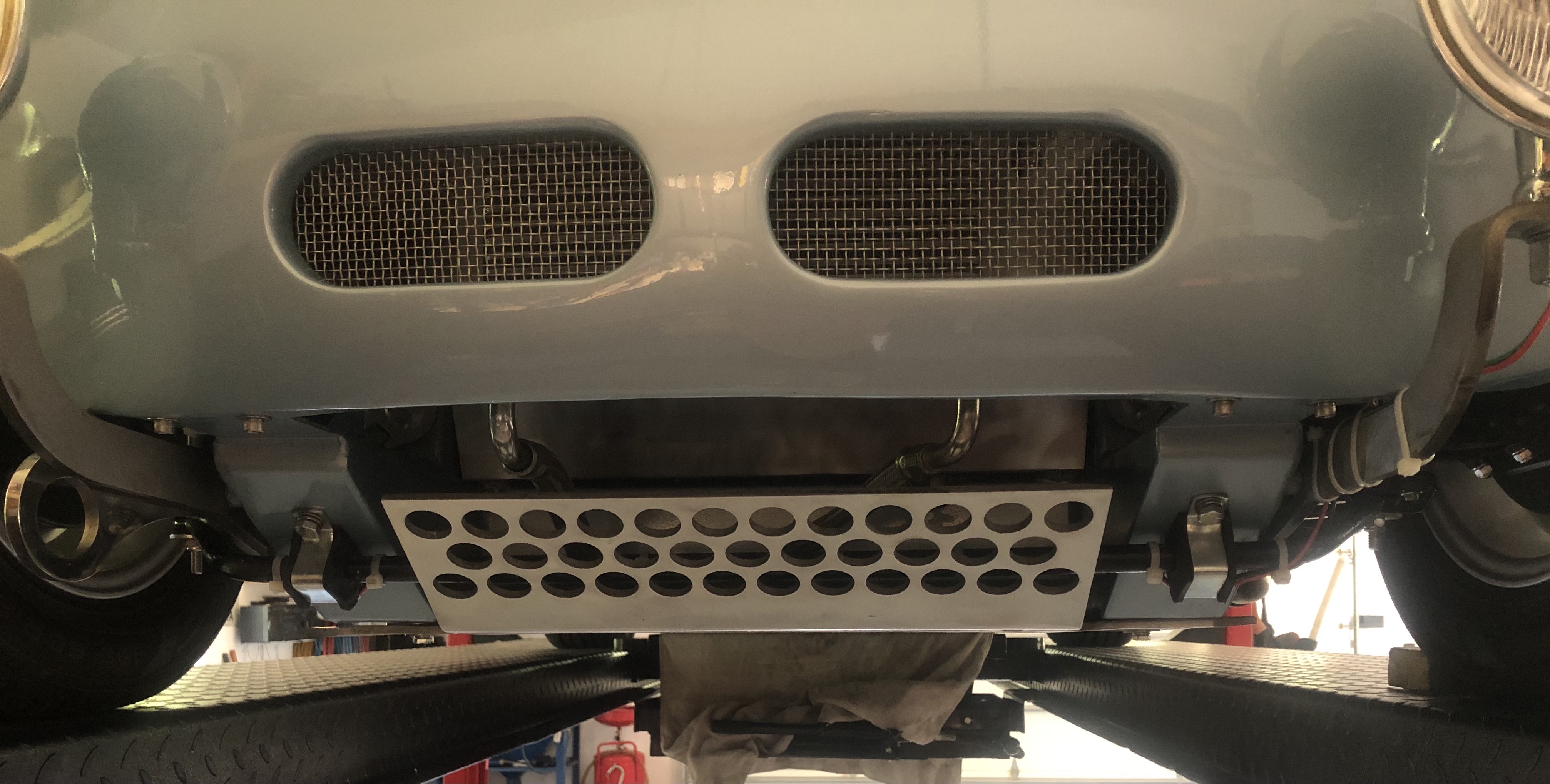

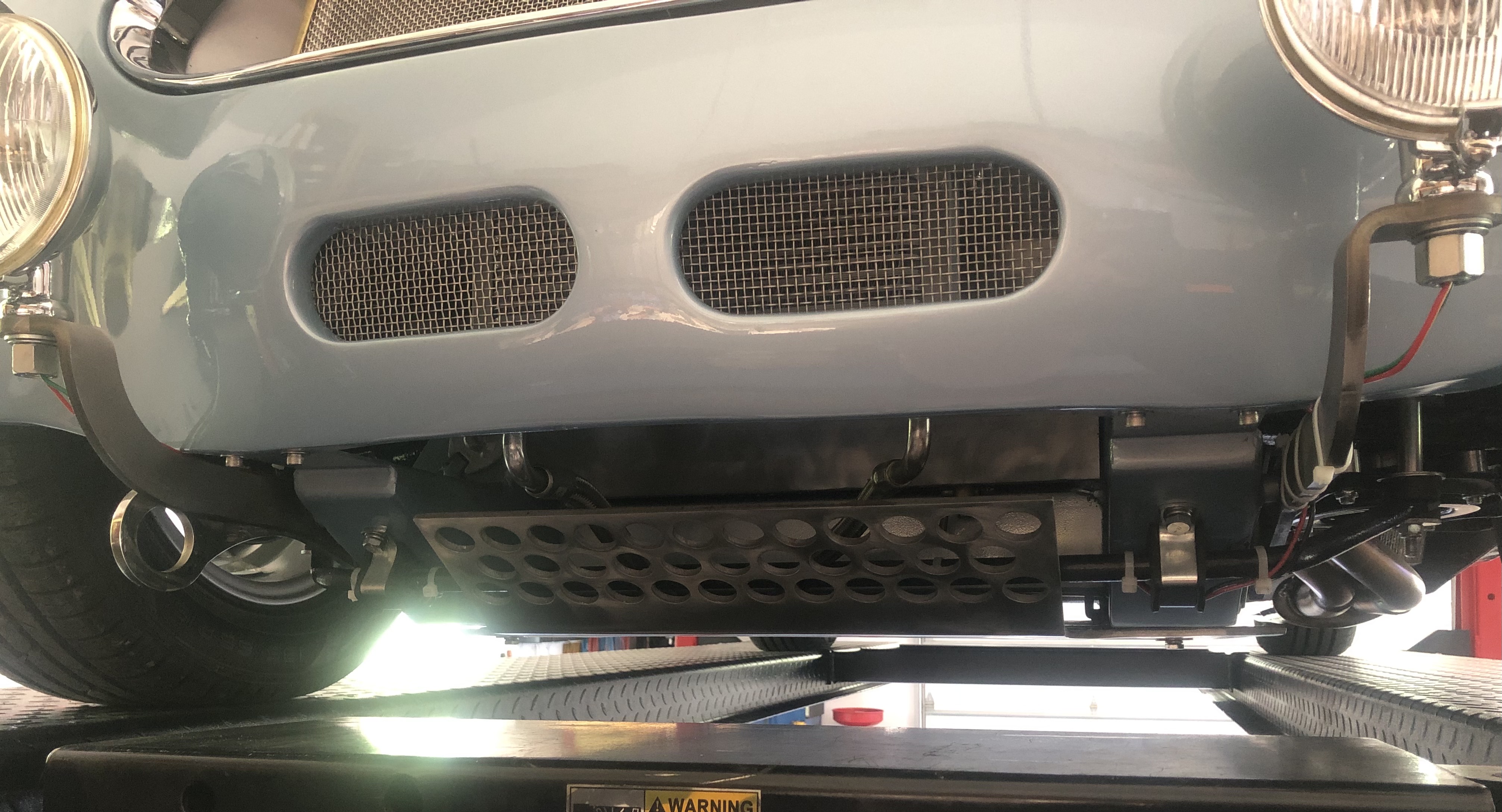

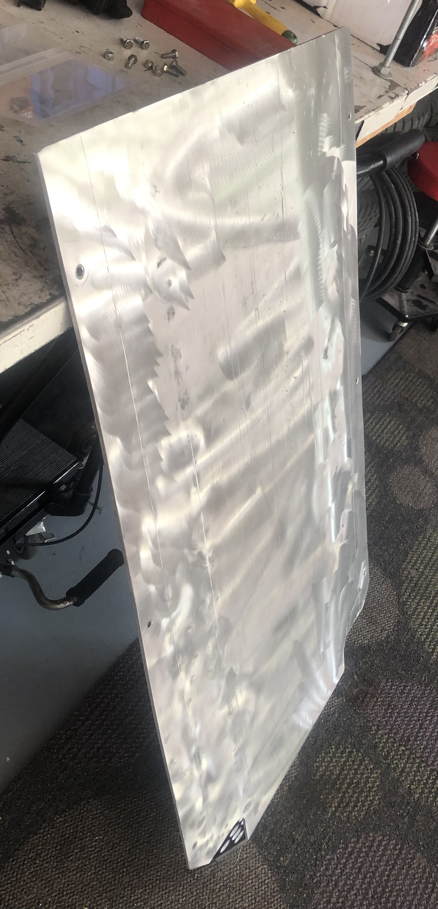

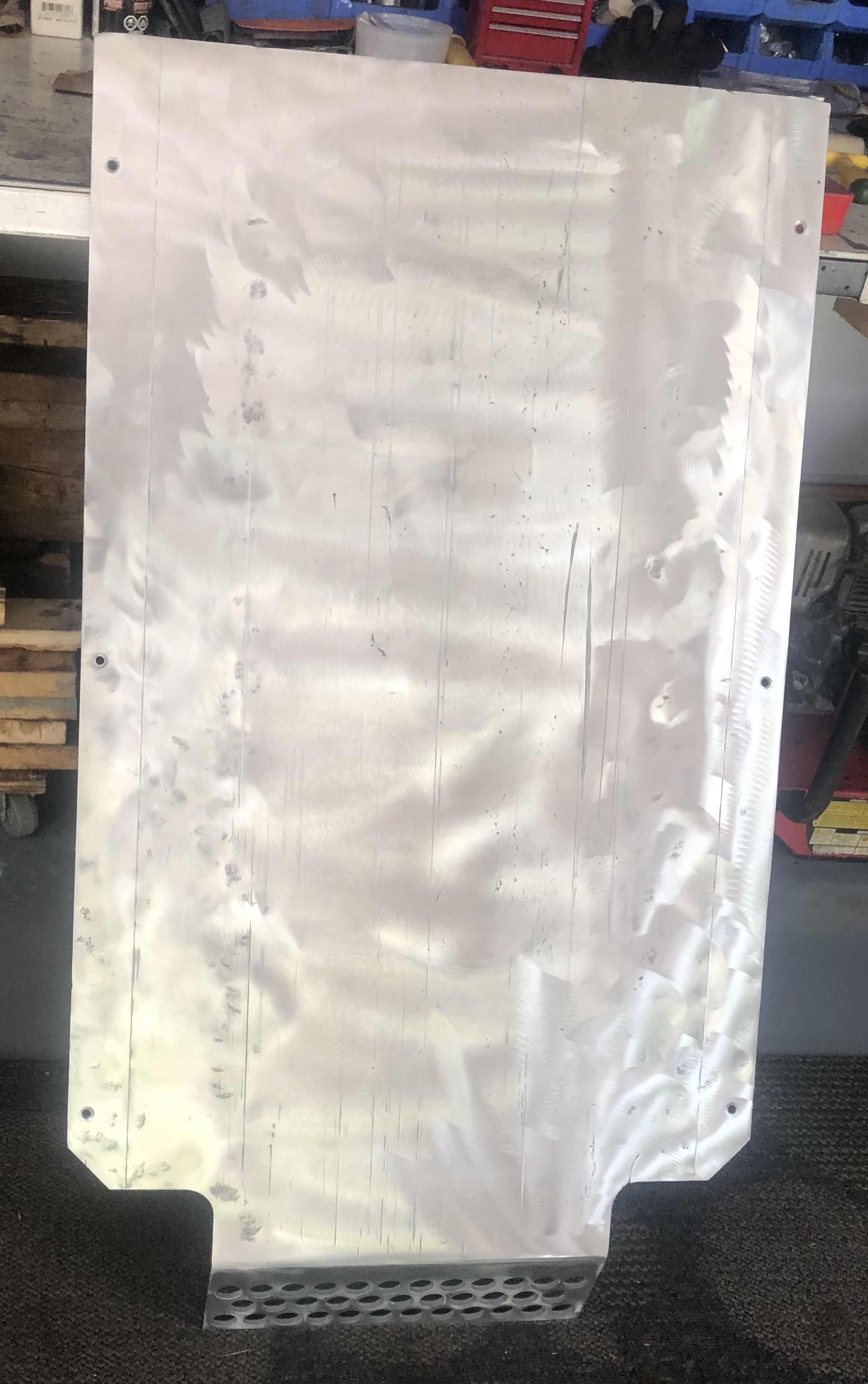

Well, having fixed my gearbox woes over the winter with it jumping out of gear and now having driven the car more, installed my Lumenition electronic ignition and got the car running much better, I moved onto other stuff.
I haven’t been able to convince the local authorities to pave all the roads I drive on bowling-green smooth, so I had to go for more ground clearance. Seeing as my car has a Jule frame, the frame rails are box sections with no standing seam in the way, and they are also taller so the oil sump doesn’t extend below the frame rails. It’s about 1/4” higher than the base of the frame. The alloy sump guard I was using from AH Spares is meant for a standard Healey frame, so it is made with a slight U shape to clear the standing seams and the sump.
I don’t want to raise the car as I like the aggressive stance and the way the wheels look in the wheel arches by being lowered. So, using my barbecue as a heat source and after a good round of heating, beating, pressing and squeezing followed by some annealing, my alloy sump guard is now flat and fastened to the main frame rails directly underneath with threaded inserts installed in the rails. Gained myself about 3/4-7/8” in ground clearance. Gave it a good buffing to remove some of the battle scars a bit, and re-clear coated it.
I need some more 1/4x20 nutserts to finish it, but it will have 8 bolts in eventually to hold it securely to the frame rails.

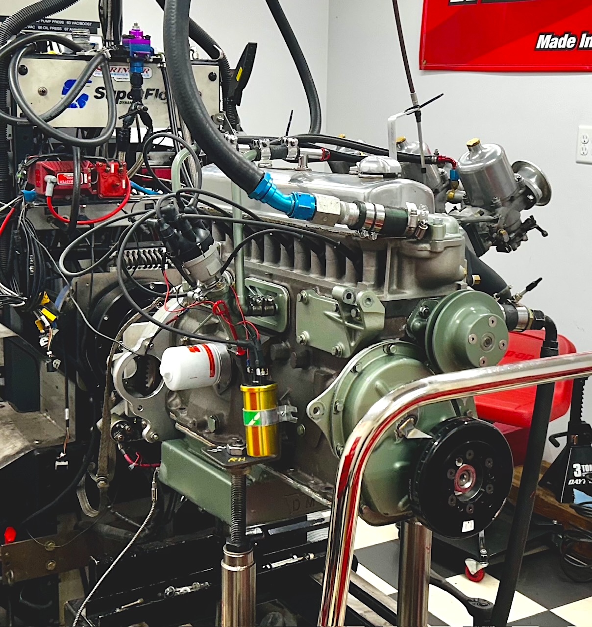

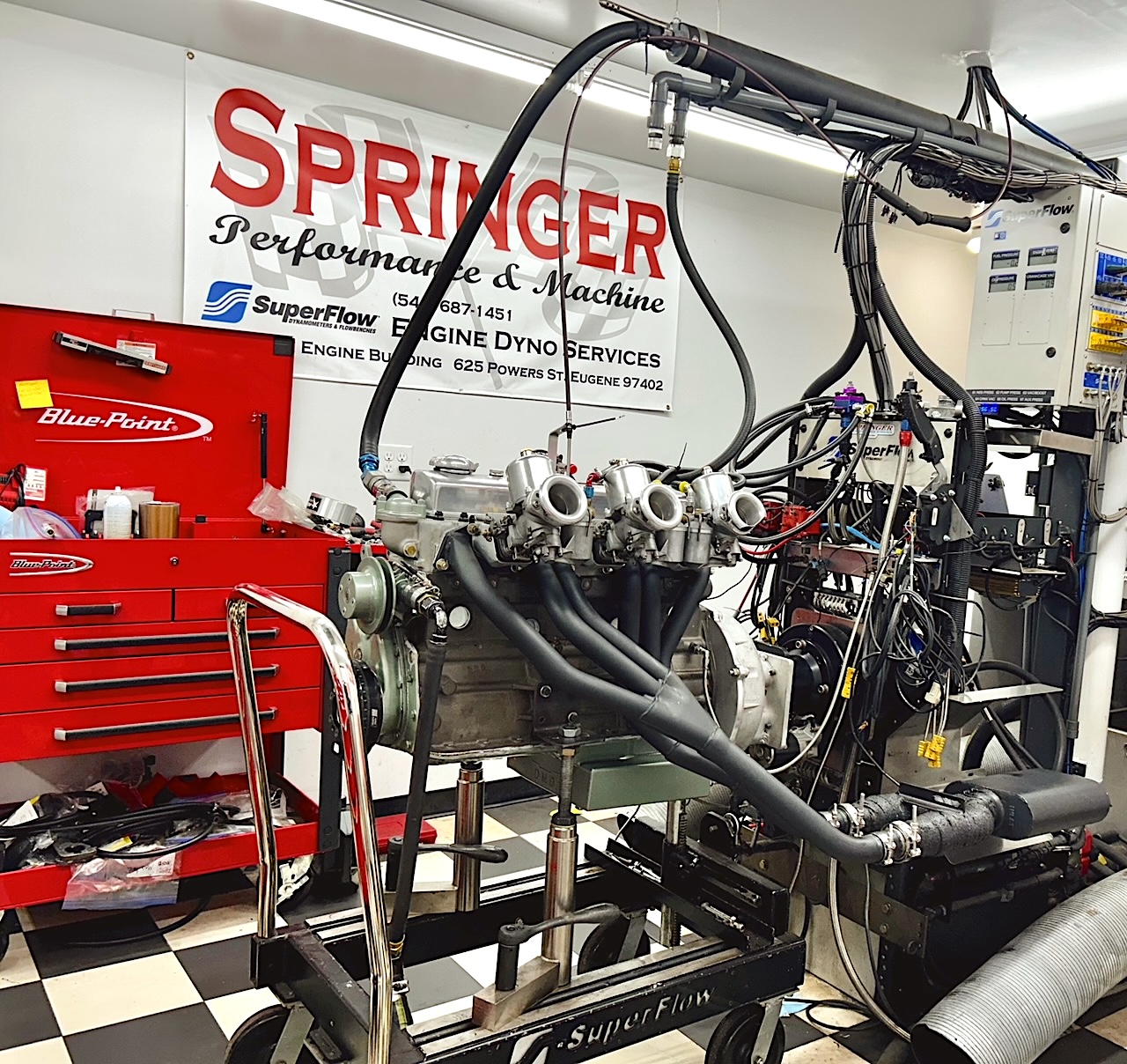

My new tri-carb race motor for the Healey World Challenge, > Healey World Challenge - Register Now! < is complete and dyno tested with great performance. Results will be available to those who visit my paddock at Road America, Elkhart Lake, WI September 13-15.
