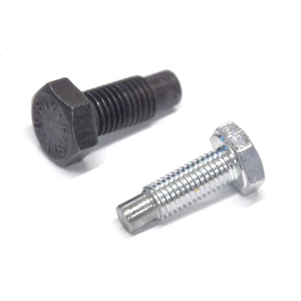

Agree with #2 as possible culprit but also consider gear lever bush and correct gear stick locating bolt (image from DWR). Oh, how about trans pilot bush. Good luck, GONZO

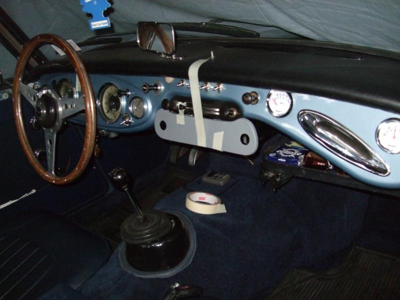

Well Bob, it could be coincidental that one of the failures you have mentioned could have occurred at the same time that you had the engine rebuilt. But I must tell you quite factually that in the only two times I have had my transmission cover off in the last 5 years, each time after a prolonged period of inactivity, I would then reinstall the trans cover and start driving only to find that all of a sudden my trans would jump out of 4th gear. Having done no work to the transmission my 1st thought was "oh great now I have trans trouble'. Then reviewing the situation I would discover that in my effort to "get it all right" I had installed the rubber shifter boot with the nipple facing down as all the restoration guides illustrate. And each time it was installed this way, the trans would not stay in 4th gear. So I turned the boot upside down with the nipple facing up and all is well and trans works perfectly. My boot is at least 30 years old. Maybe a little stiff. I also had to keep it unclipped from the perimeter of the tunnel opening. So take the boot off the shifter and go for a ride and see what it does.

Thanks, but the gearbox and OD are on the bench in pieces. One of the thrust washers in the OD was in pretty bad shape and the accumulator was showing wear, so all-in-all it was time to go through them. When I was driving in conditions that caused jumping out of 4th, I tried a few times to hold it in gear but it felt like the box was really fighting to jump out; I didn't resist too much as I was afraid I could snap a shifting fork. But, I DID install the shift boot with the nipple down; first time in many years, so you are probably on to something. With only one exception, it only jumped out of gear when decelerating sharply or engine braking going downhill.
What I'm going to do, thanks to your suggestion, is to install the boot nipple down and see if I've actually cured the problem or not.
Bob, I believe when it wants to jump out of gear for any reason, it will fight you. I'm not an expert on transmissions but each time I have had a car which jumped out of gear it was found difficult to hold it in. I believe in some cases that the wanting to jump out of gear is because it wasn't engaged completely to begin with. This scenario with the Healey is just that kind of scenario. The rubber shift boot is keeping it from going all the way in. Also as I mentioned, I had to keep my boot from being clipped or fastened to the perimeter of the tunnel opening. Probably because of the age of the boot. Also in my case I noticed that the opening in the tunnel is not exactly centered around the pivot point of the shifter. The lower edge of the opening encroaches on the "H" pattern of the shifter. It is easy to see that a stiff boot has no where to go when shifting into 4th. Good Luck with it. You obviously have alot of confidence when tearing into this sort of thing.
