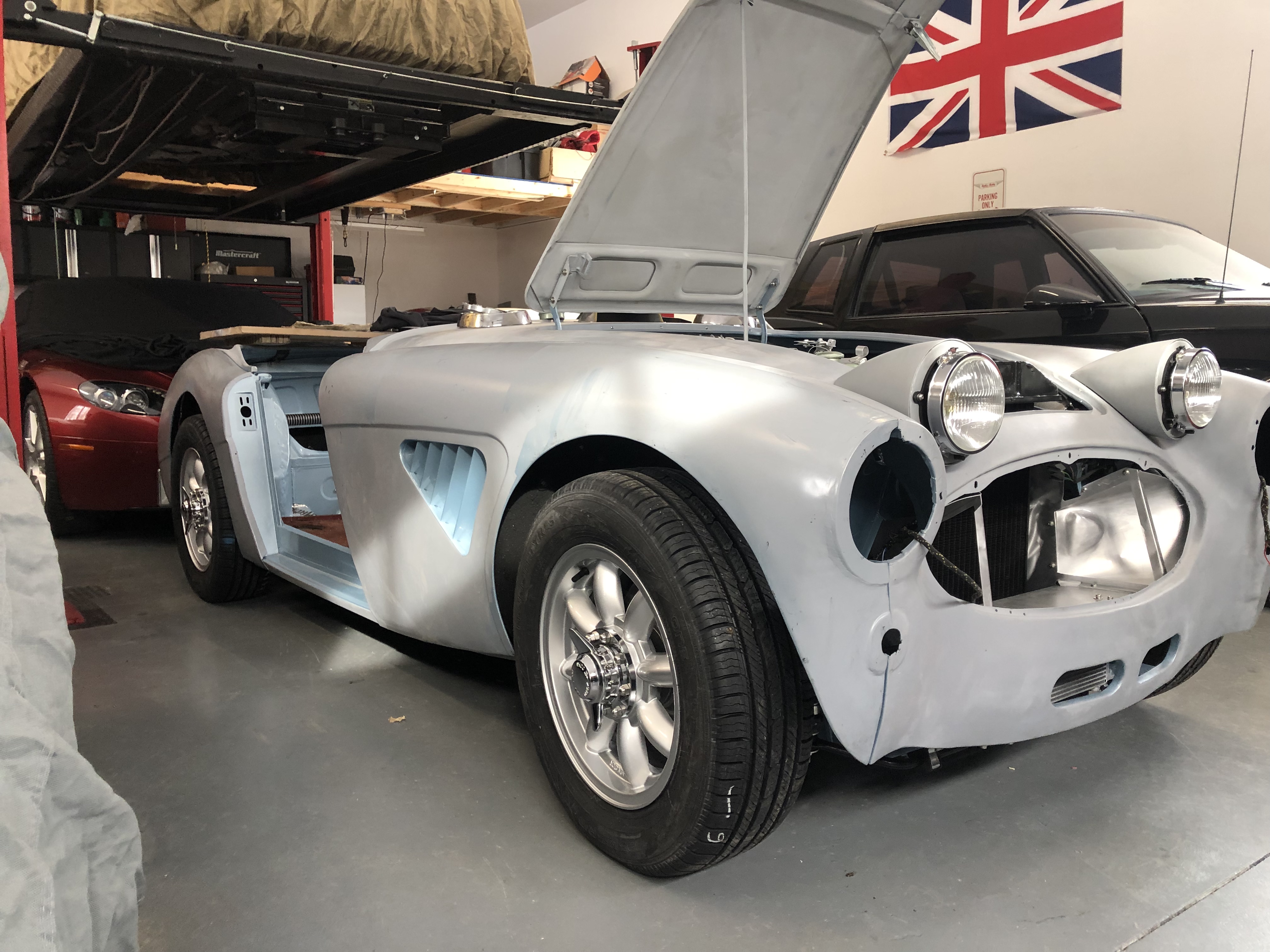

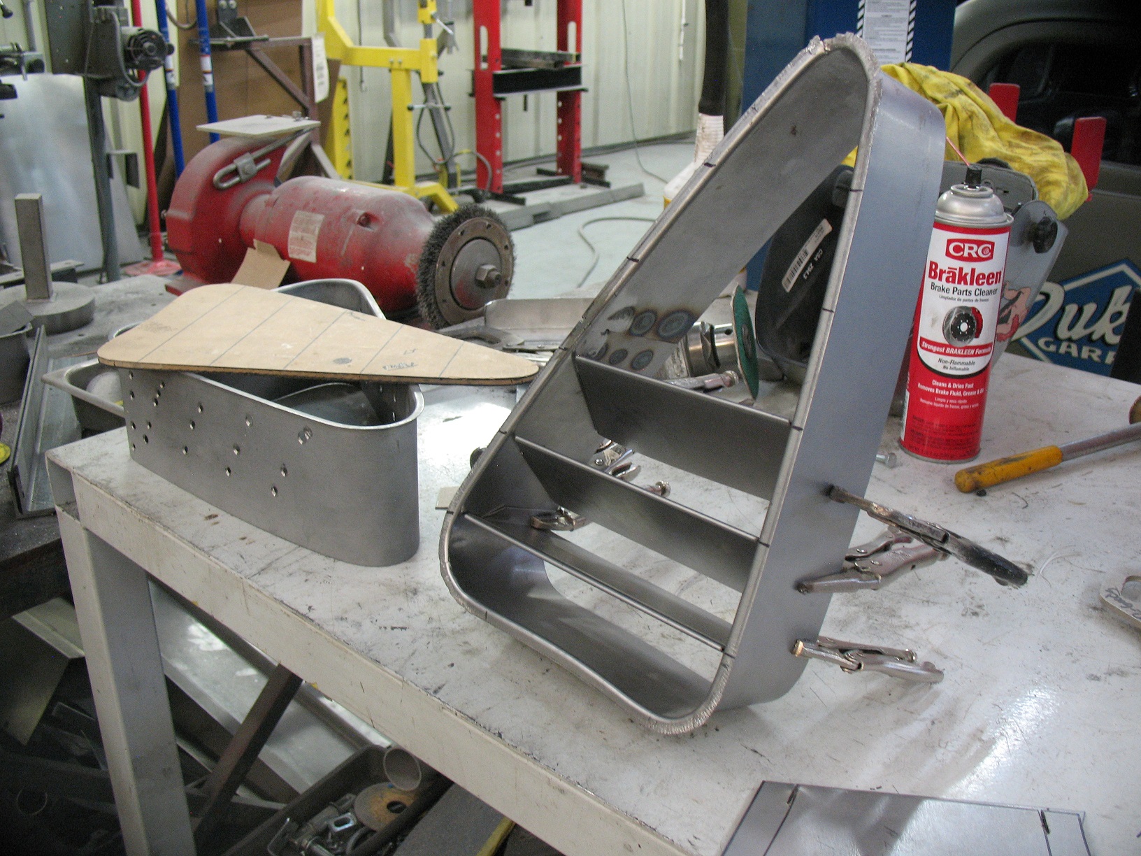

I didn't use full depth vents either. Since my guy custom made the vents from my patterns from Pat Moss's car, we, like you, thought they looked better not quite so large (deep). See pics.: Shows full depth original Works vents housing on left with my shorter custom housing on right. Of note is the carb access panel
That said, we liked the airflow improvement with the upper footwell reshape so added that.... earlier pics.

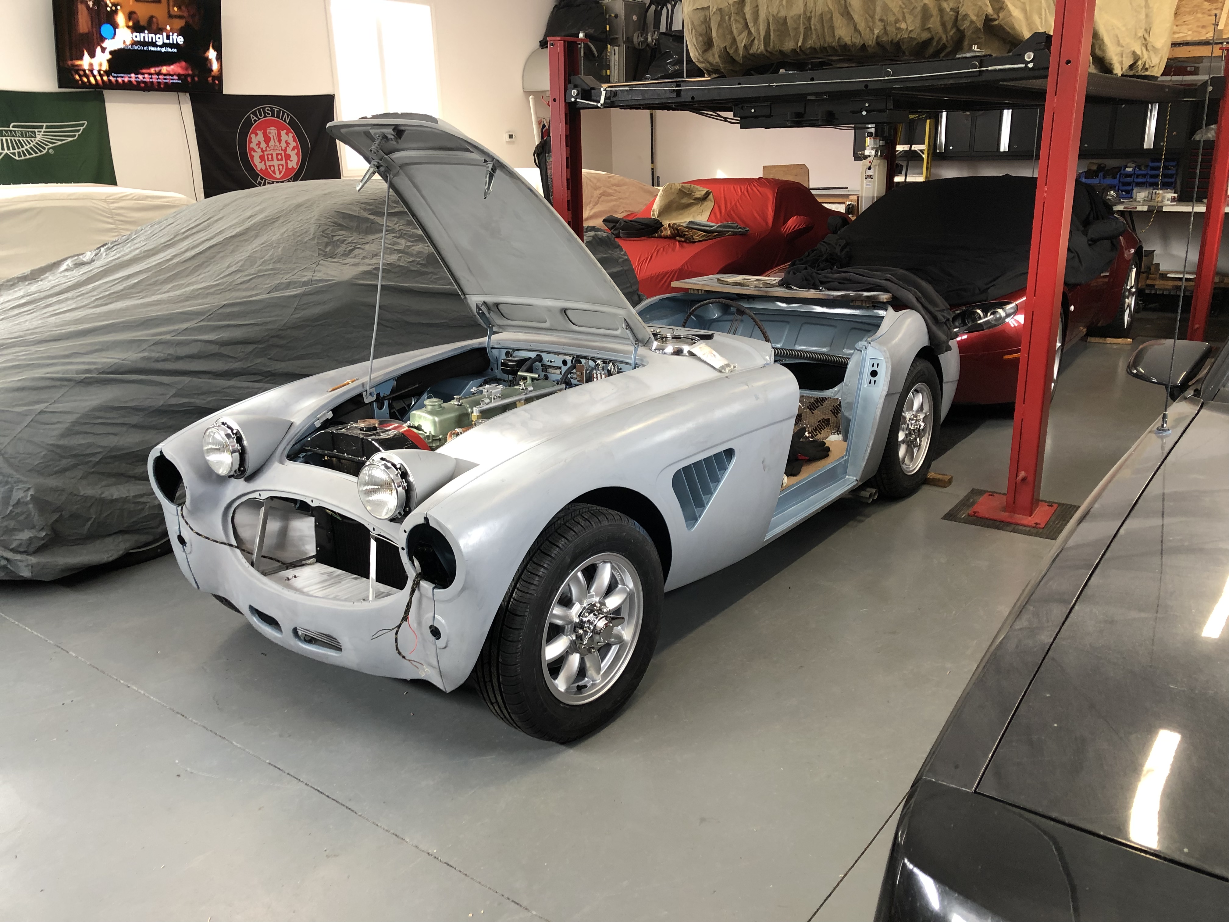

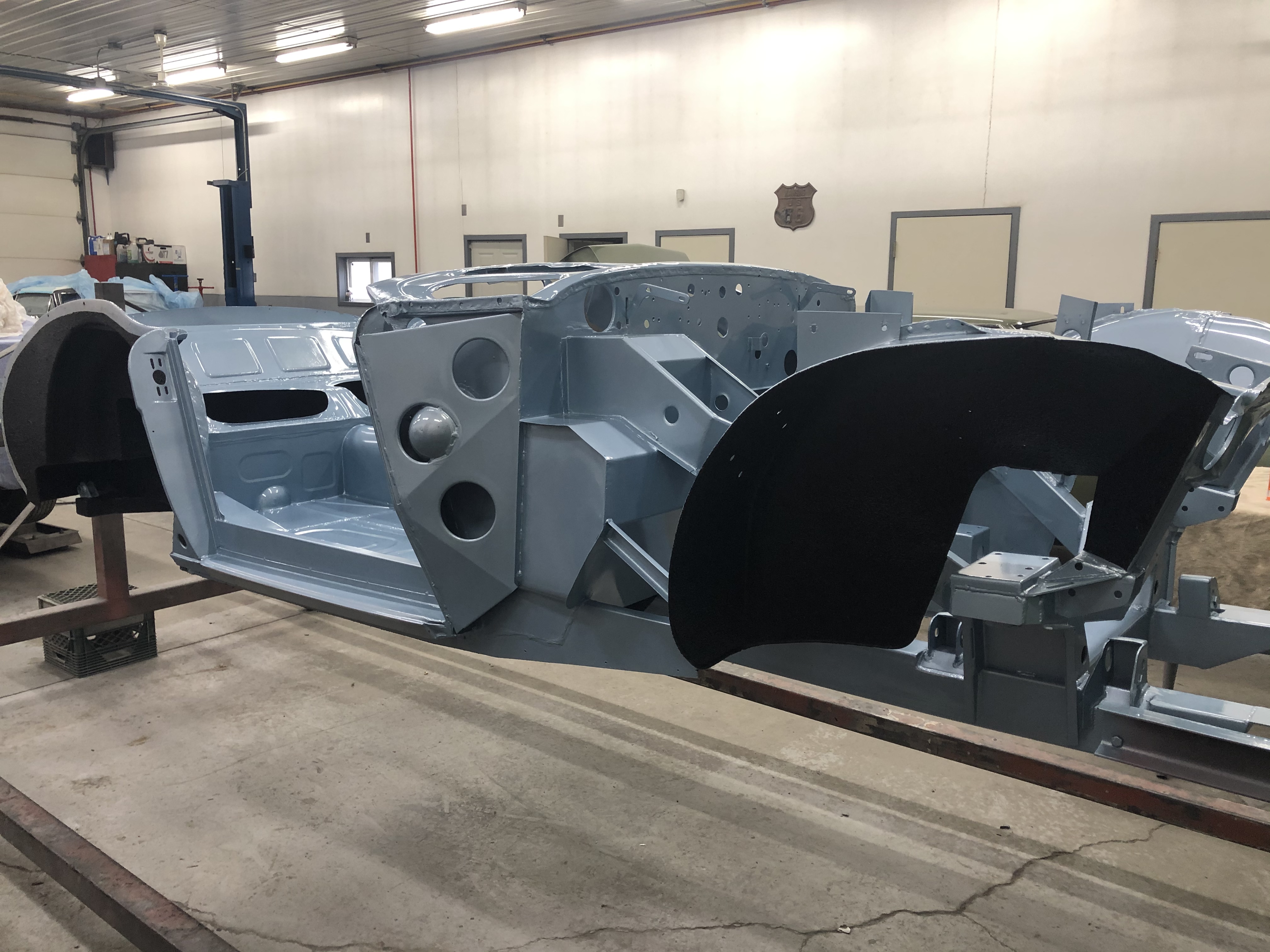

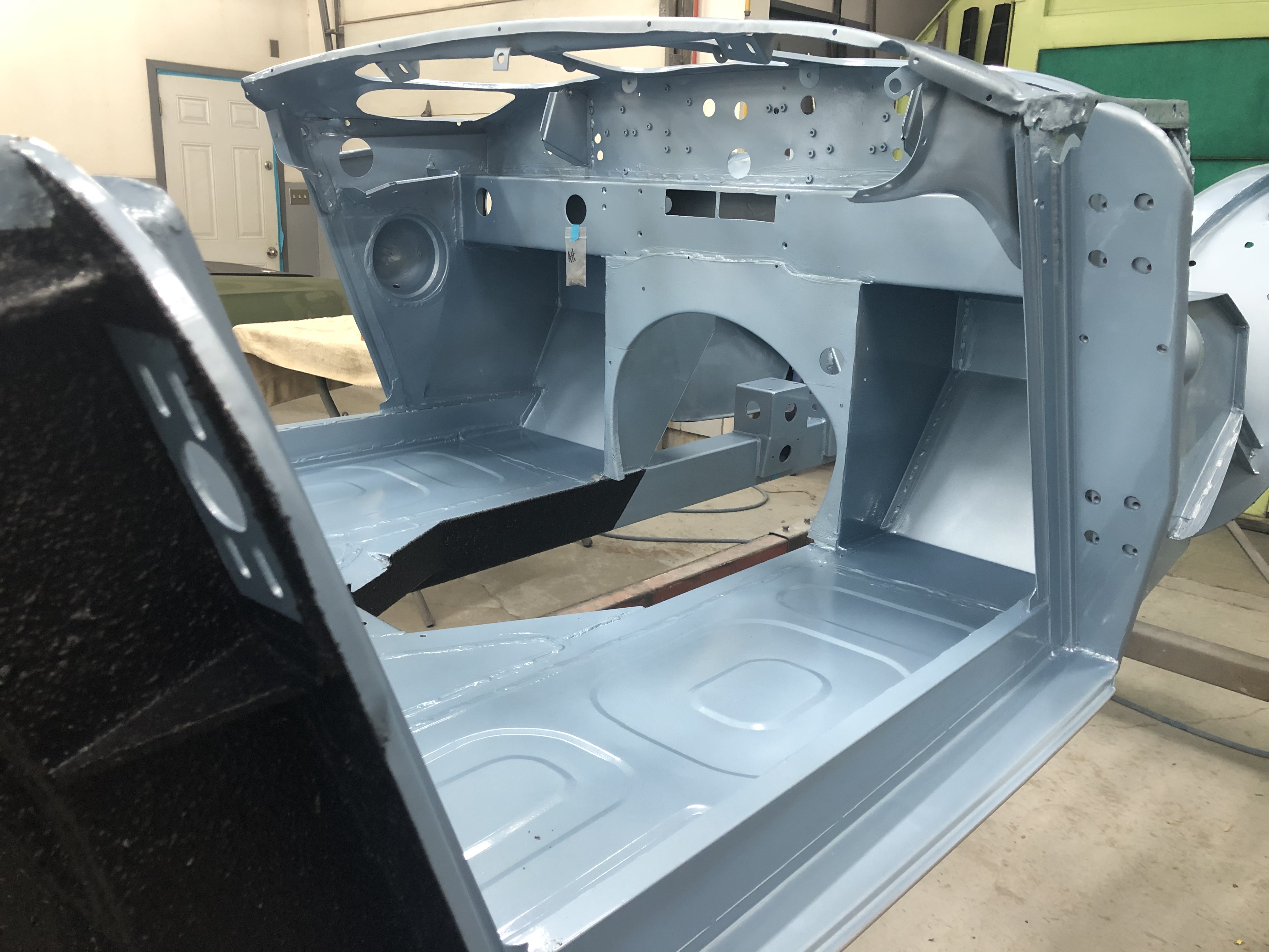

Now the fun can start , or it will do once I get it home and some cars get picked up to make some working room for me in my shop . Paint and black epoxy needs a few days to harden up fully before bringing her home .
So that’s the 2012 Toyota Blue .

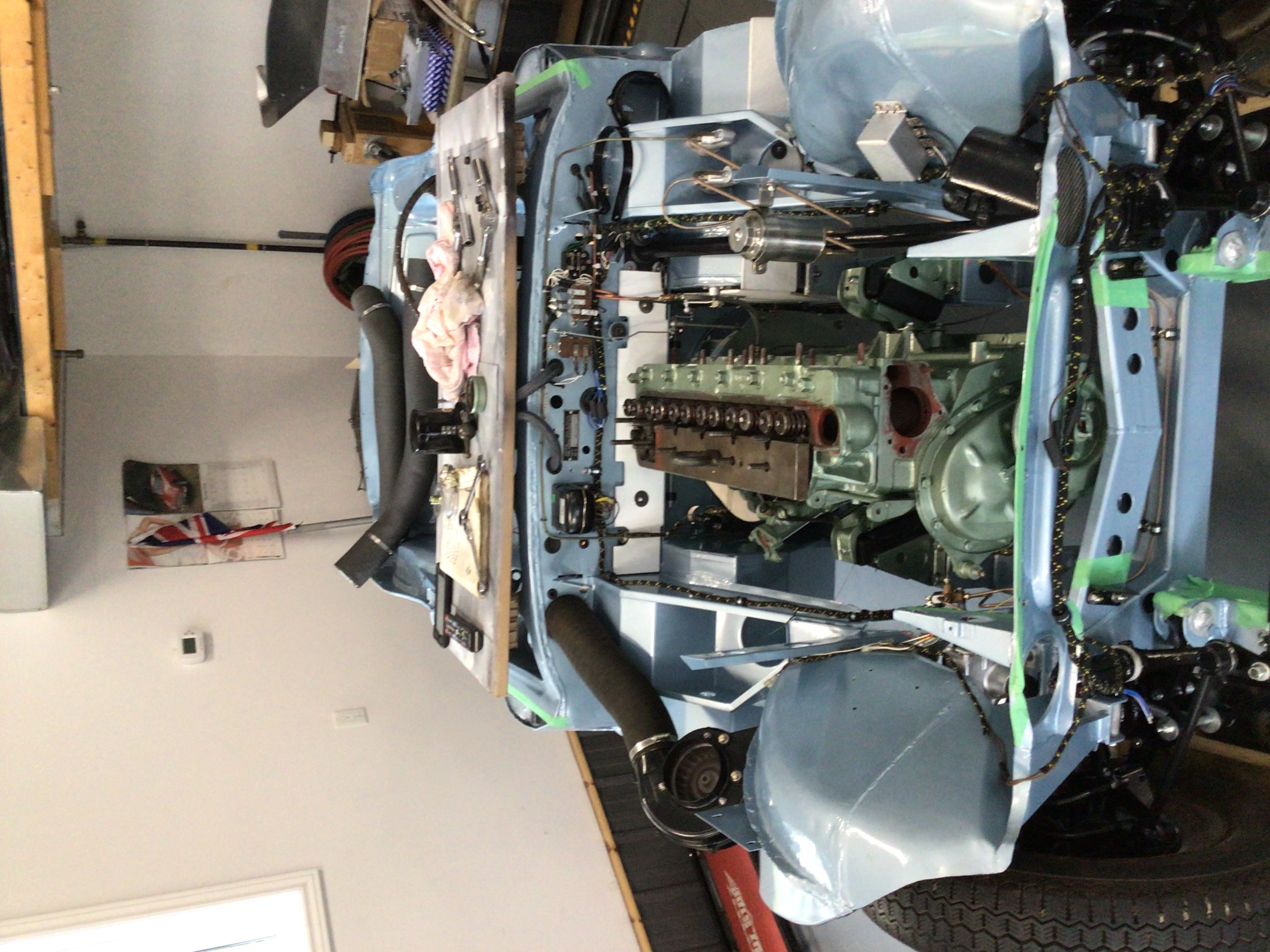

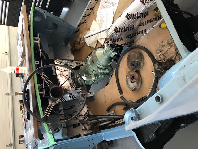

Haven't posted progress in awhile so here’s a few pics .

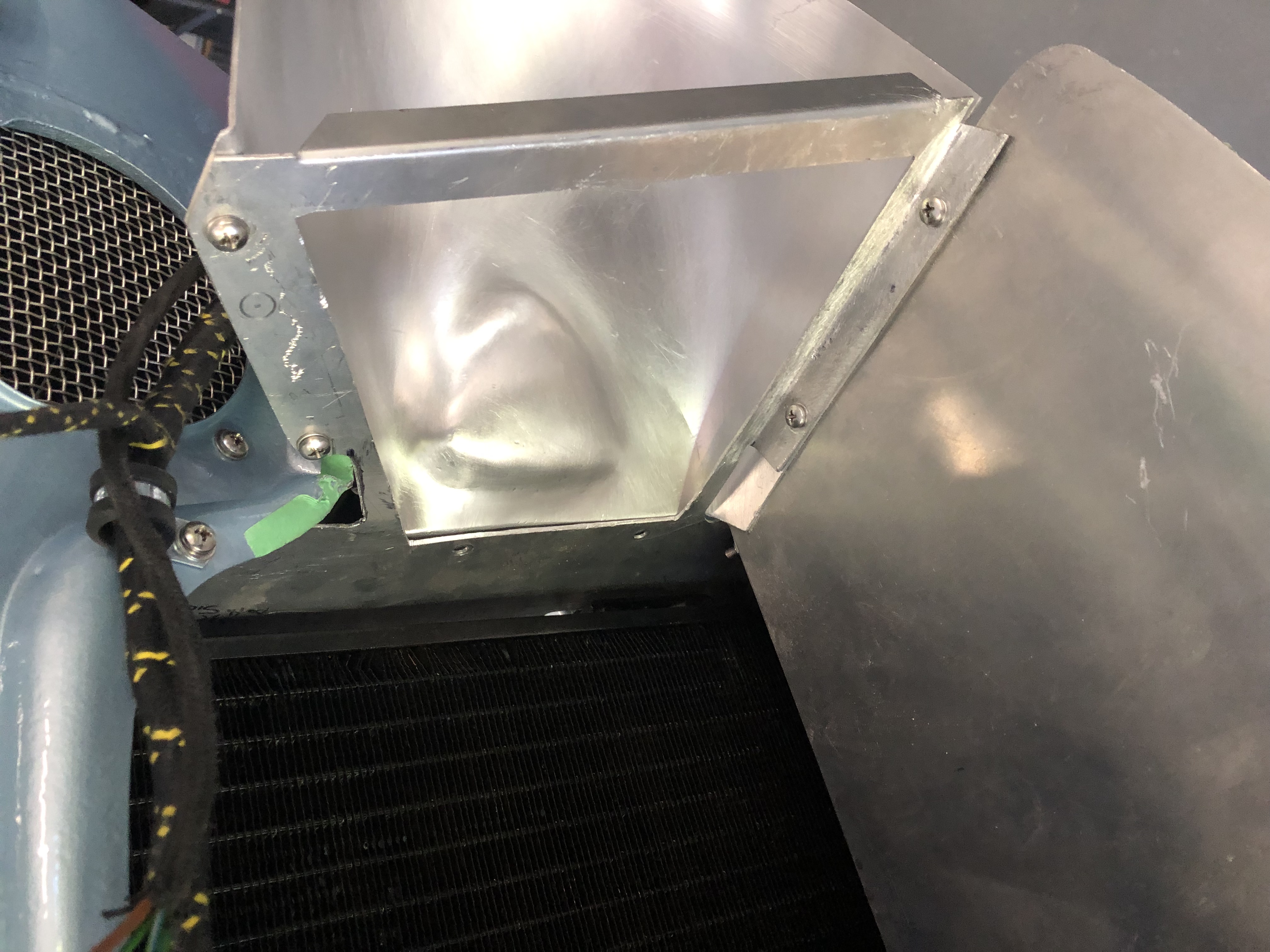

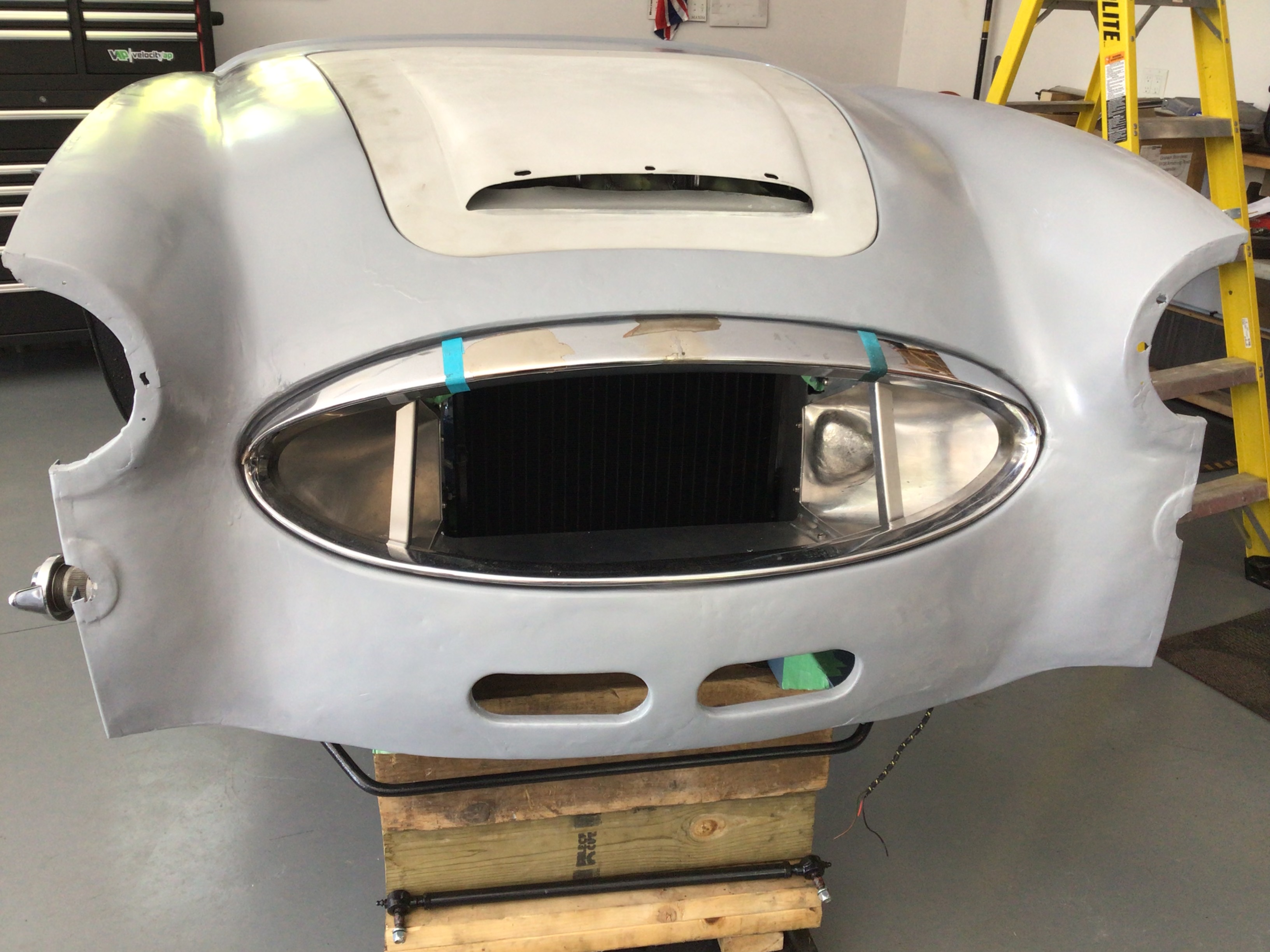

I have had that rally duct in and out more times than I can think of . It was a pain to fit and AH spares (where it came from) were no help at all.
It fit in the body only mock up but once the steering box was in there was no way it would fit and look right .
I ended up taking it all to pieces and fitting each piece individually. The main problem was clearance for the steering box , hence the custom bulge on the drivers side intake to clear it .
Maybe the rally cars had different steering boxes or they just jammed the duct in and we’re not as fussy as to how it fitted or what it interfered with .
The duct sides now sandwich between the lower rad mounts using the same bolt holes .
Just some final cosmetic tweaks and it can all be scuffed with wire wool then clear coated ready for final assembly.

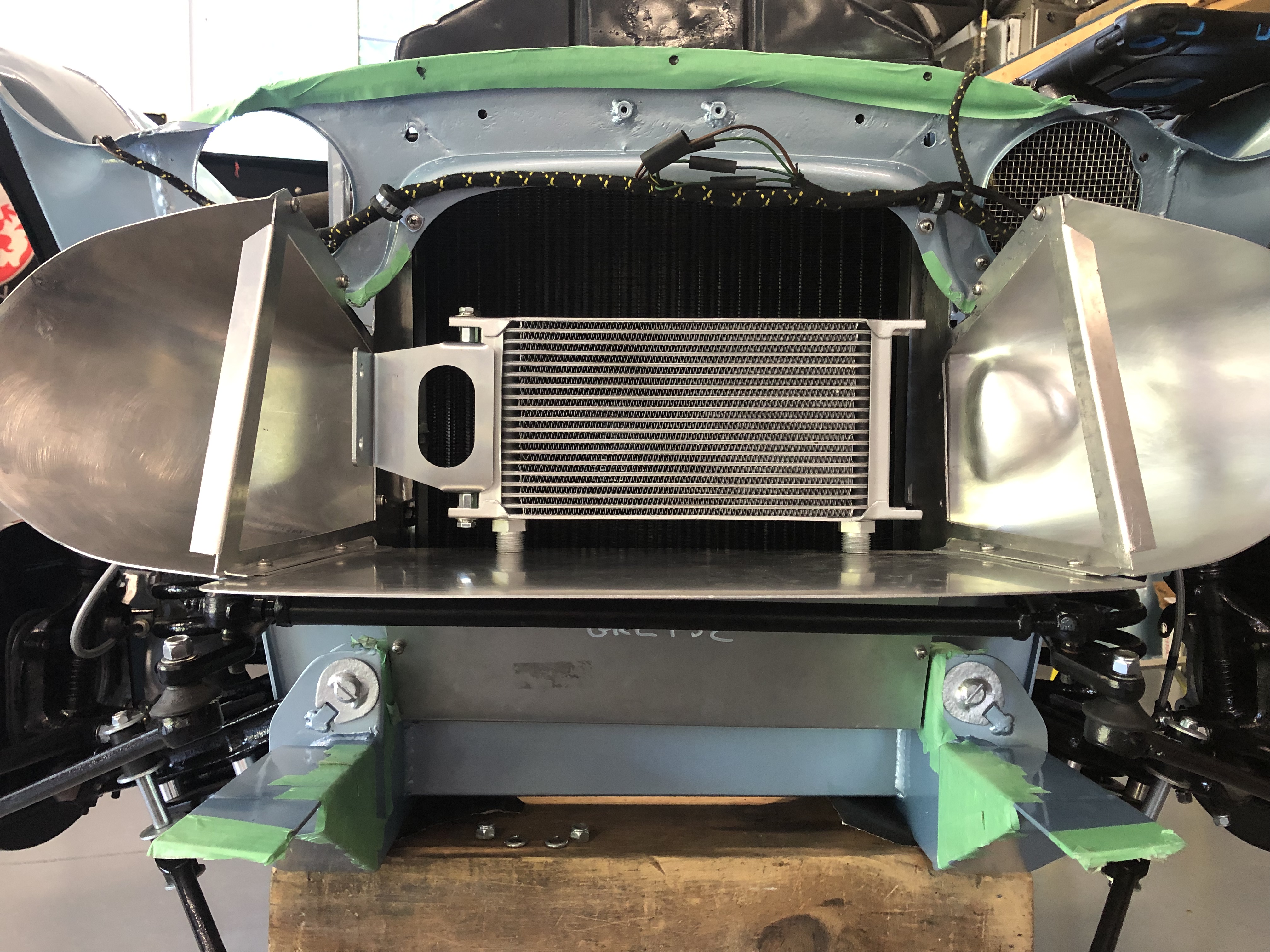

My next challenge is the oil cooler ,it will go in front of the rally duct behind the lower custom shroud openings mounted between the front frame rails ,and then I will create an opening in the lower angled panel portion of the rally duct so the air flows through the oil cooler then through the lower portion of the radiator .

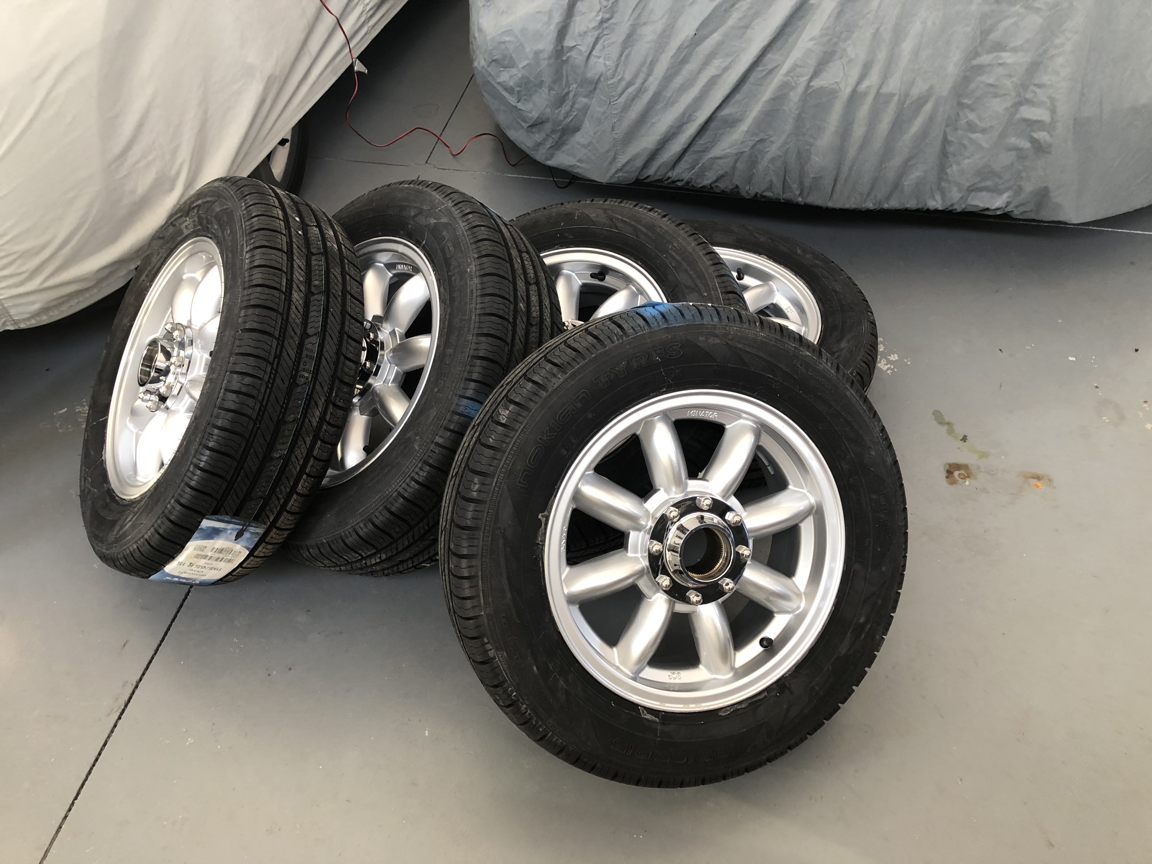

waiting on my minilite wheels from the UK then the driveline can go in and I can start refitting outer skin on her .

Why would you do that?
The air has to go somewhere if it’s a blank panel behind it then the oil cooler won’t cool much .

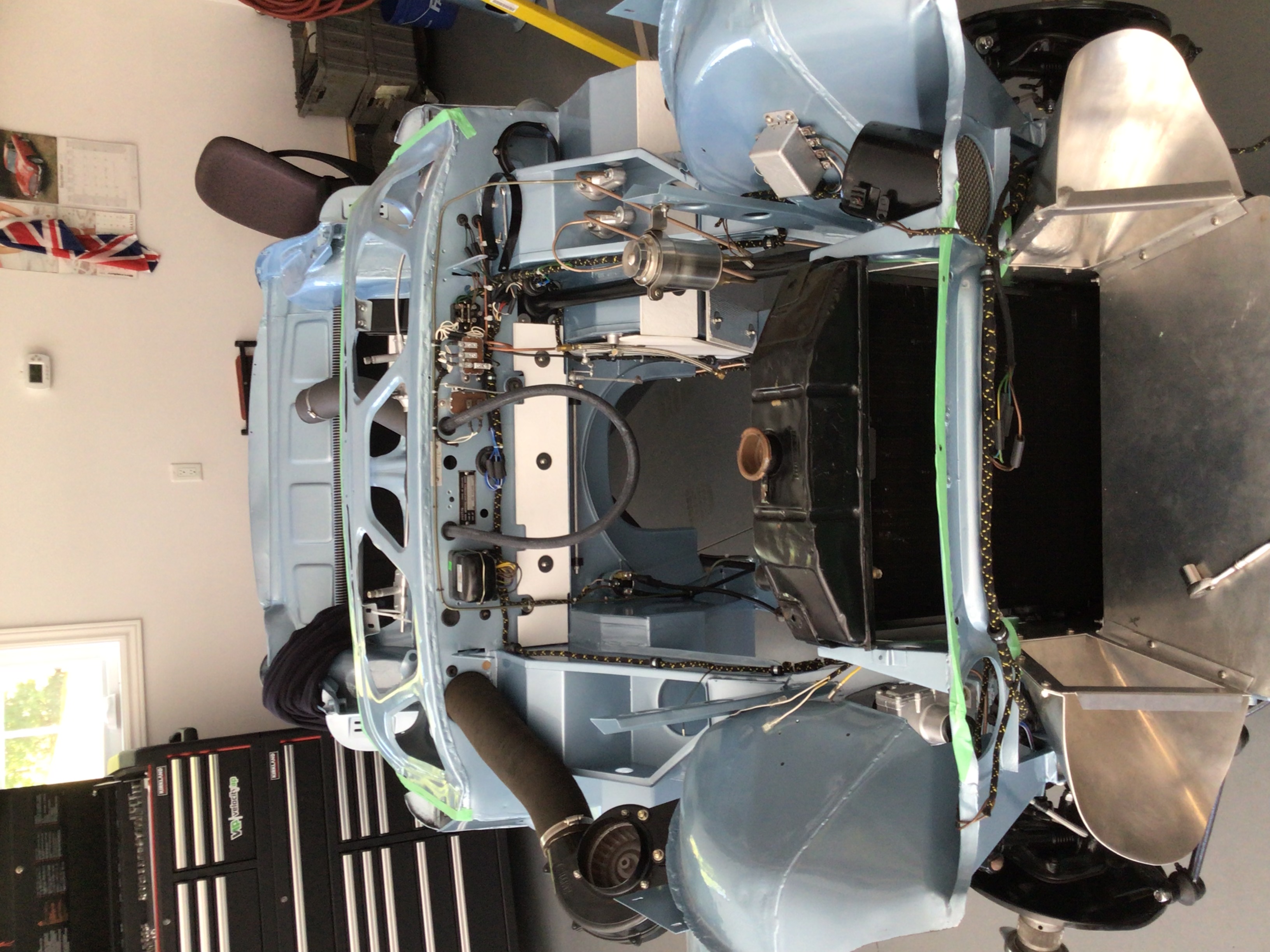

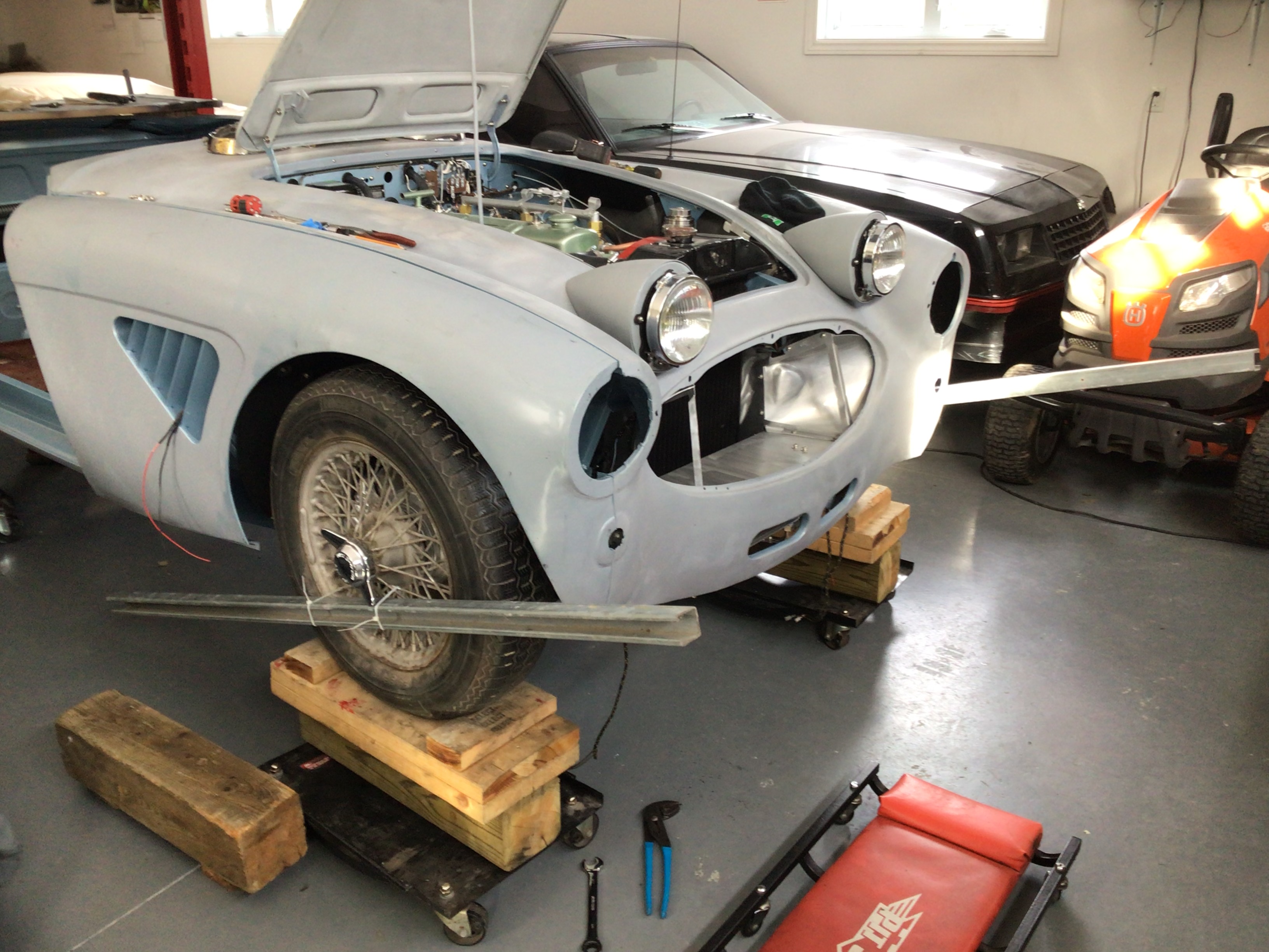

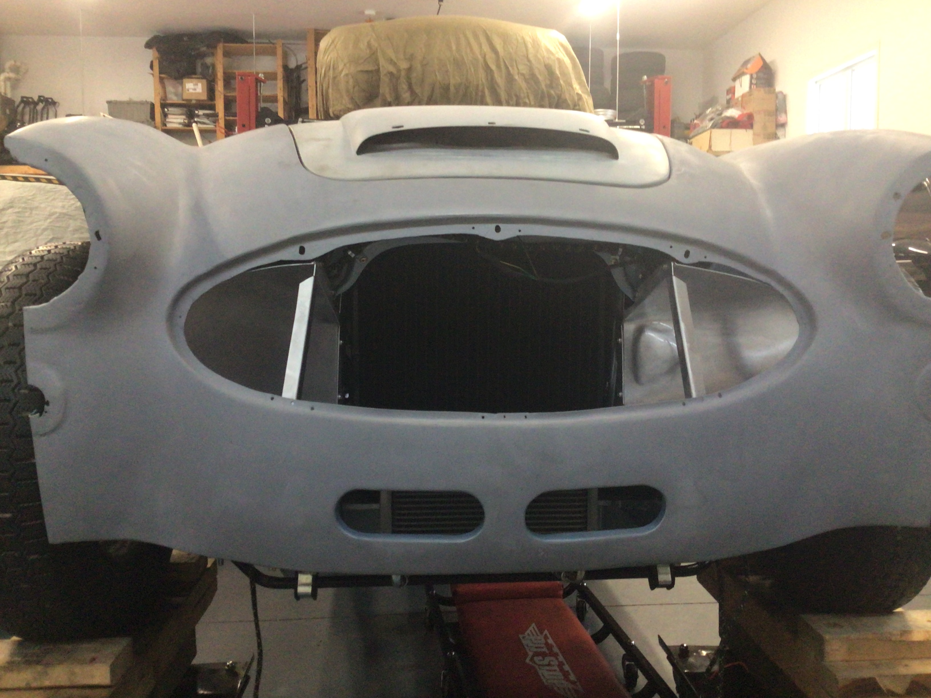

So a couple more shots , my custom bump is all smoothed out . A shot behind shows why it had to be done to clear the steering box .
Im having second thoughts about the oil cooler location
Below the duct where the white writing is on the panel behind the crossroad with a slot for airflow cut basically where the white letters are or above where I have it standing with holes drilled for the hoses from below .

More progress . , getting there slowly .
I did some surface prep on the shrouds on the outside to about 70% done , they have gone back to my paint guy so he can paint the inside and get them to 90% outside before going back on the car .
I did resolve the cross rod issue , Boy racer was absolutely correct . Steering arms were upside down ie reversed etc .

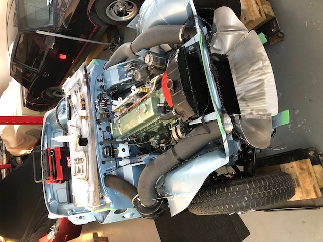

More progress , front and rear shrouds on , rear fenders on but need tweaking . Scuttle scoop done . Oil cooler etc all done .
dash stripped and recovered , checking all the switches and stuff this afternoon prior to reassembly .
Instruments have gone to West Valley for repair/restoration , carbs have gone to Apple Hydraulics for overhaul .
it’s beginning to look like a Healey again . 👍

Wheels with brand new boots going on this weekend (195/65x15s) so I can do the roll test to get my speedo calibrated .
Going to have to get my calculator out as there’s no way I can roll the car 52ft 9 1/2” etc etc as it’s minus who knows what temp outside and lots of snow . So it will be see how far the car goes over one revolution and extrapolate it out .
will post pics of them on the car soon .

Wheel alignment done using my Pat pending method , new boots on ready for speedo calibration roll. Once she’s had the brakes bled and off the blocks .
shes looking like a little rally car now
