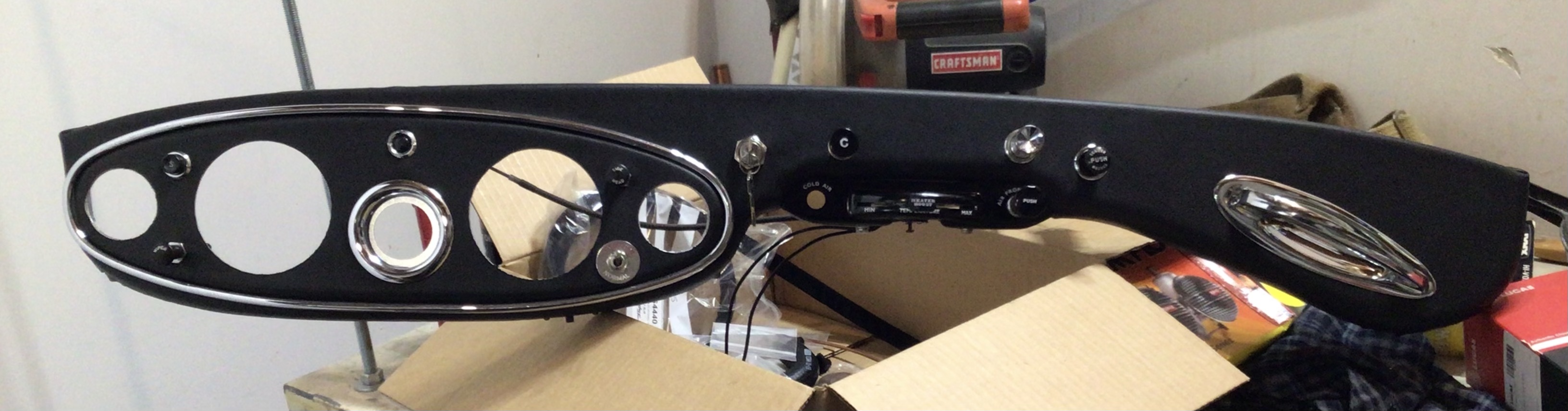

Looks like I will be doing wiring on the weekend

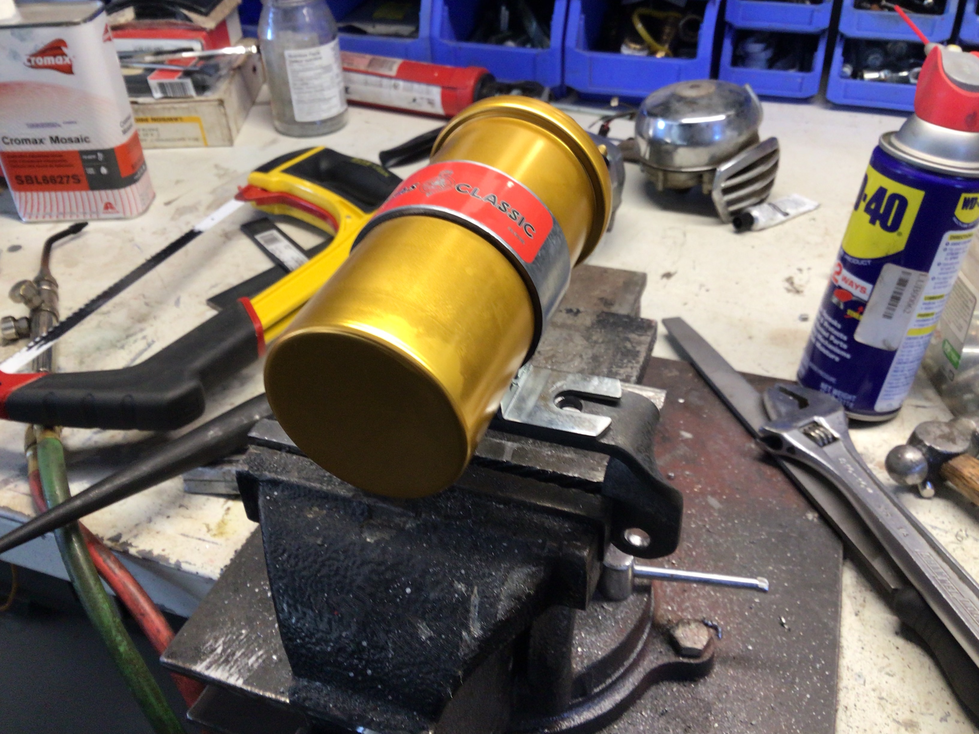

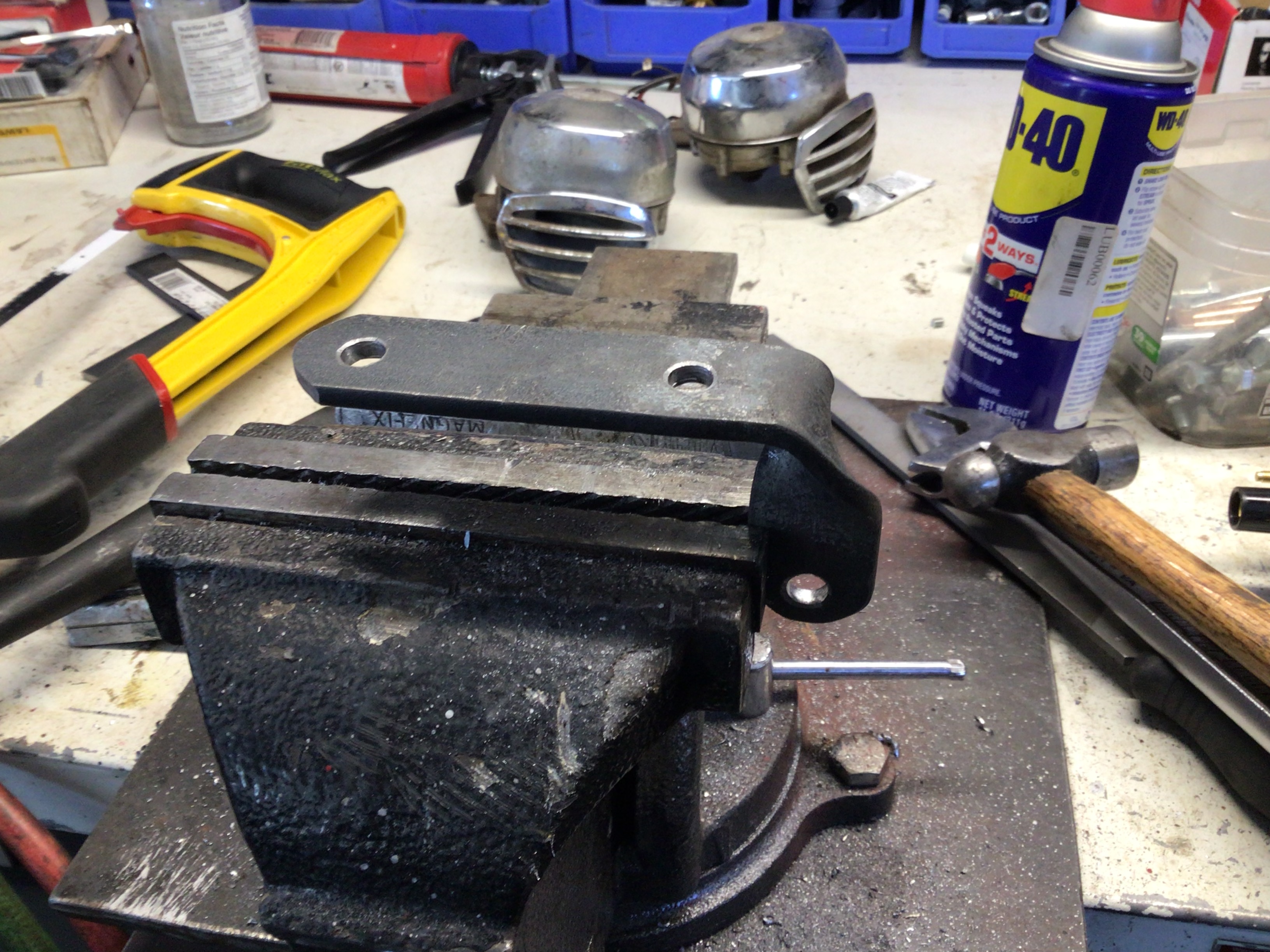

seeing as I’m using an alternator to power all those rally lights etc I now have no where to mount the new coil …..so……
Make a custom coil mount bracket .
just need a longer bolt to go through the alternator mounting and it will sit basically in the same spot as it did with generator .

I eliminated one horn then moved the remaining horn down to the diagonal brace
from toe box then mounted the coil on the vertical brace that the horns were on. Been running it that way for about 15 years. One horn is more than enough and I don’t think I have ever used it in anger.
I wanted to save space where the horns mount for my air compressor and ā€œGeneral Lee ā€œ musical horn set up …………
Kiddddding ā€¦ā€¦ā€¦šŸ˜šŸ˜šŸ˜
I never liked the coil mounted on/near the motor. The idea is to keep them as cool as possible and away from any heat source.

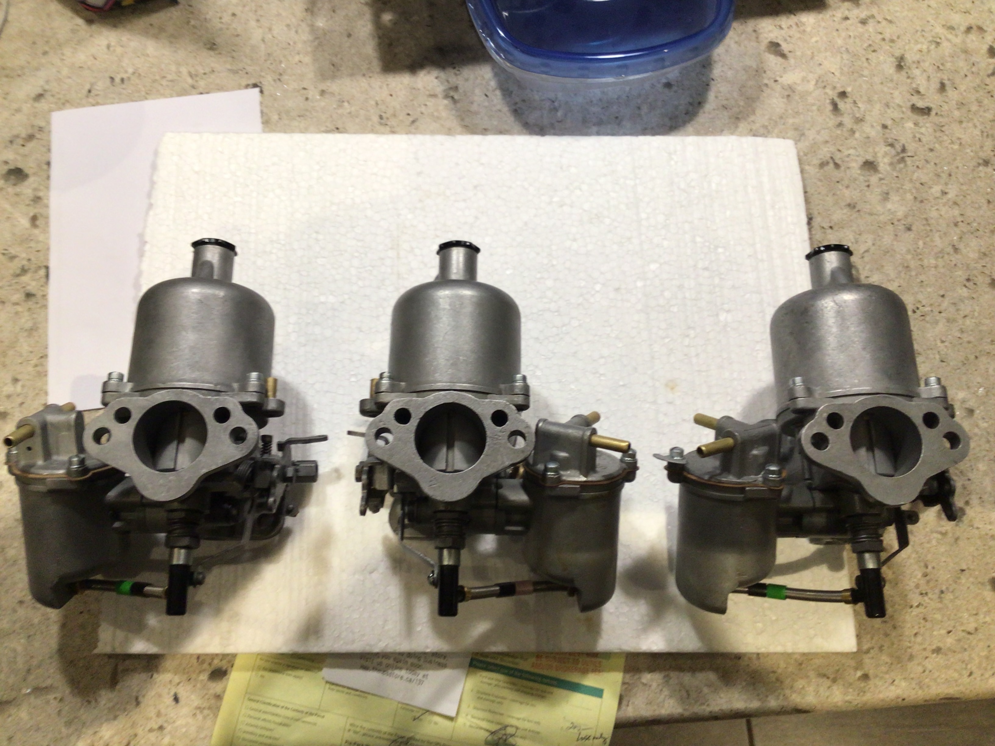

Carburation day coming up ,,,,,,,,, got them back from Apple Hydraulics all looking spiffy .

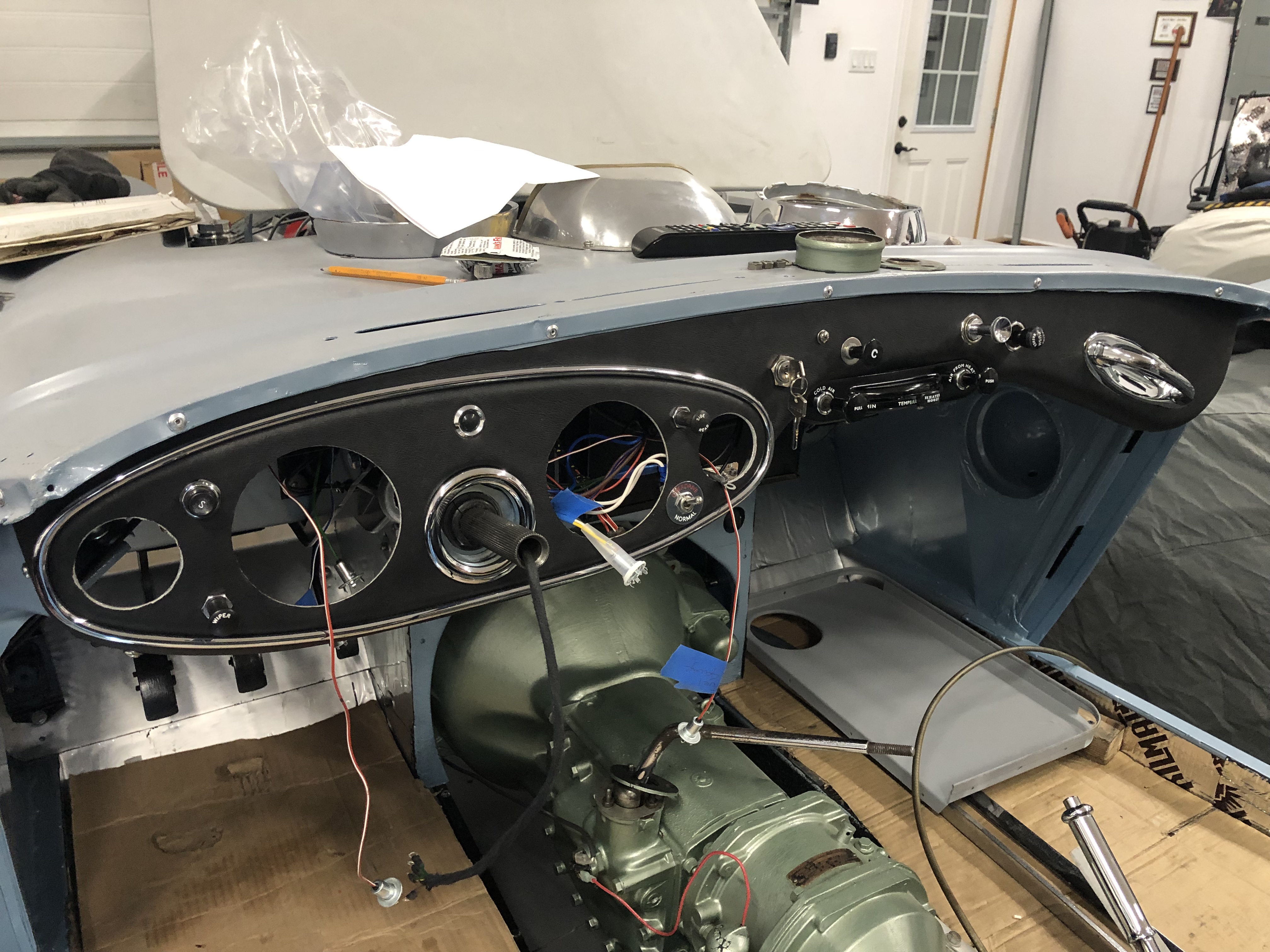

Dash is in wiring ongoing , instruments expected back soon . Cars are on , few details to deal with to finish the engine bay .
fire up day is getting closer .

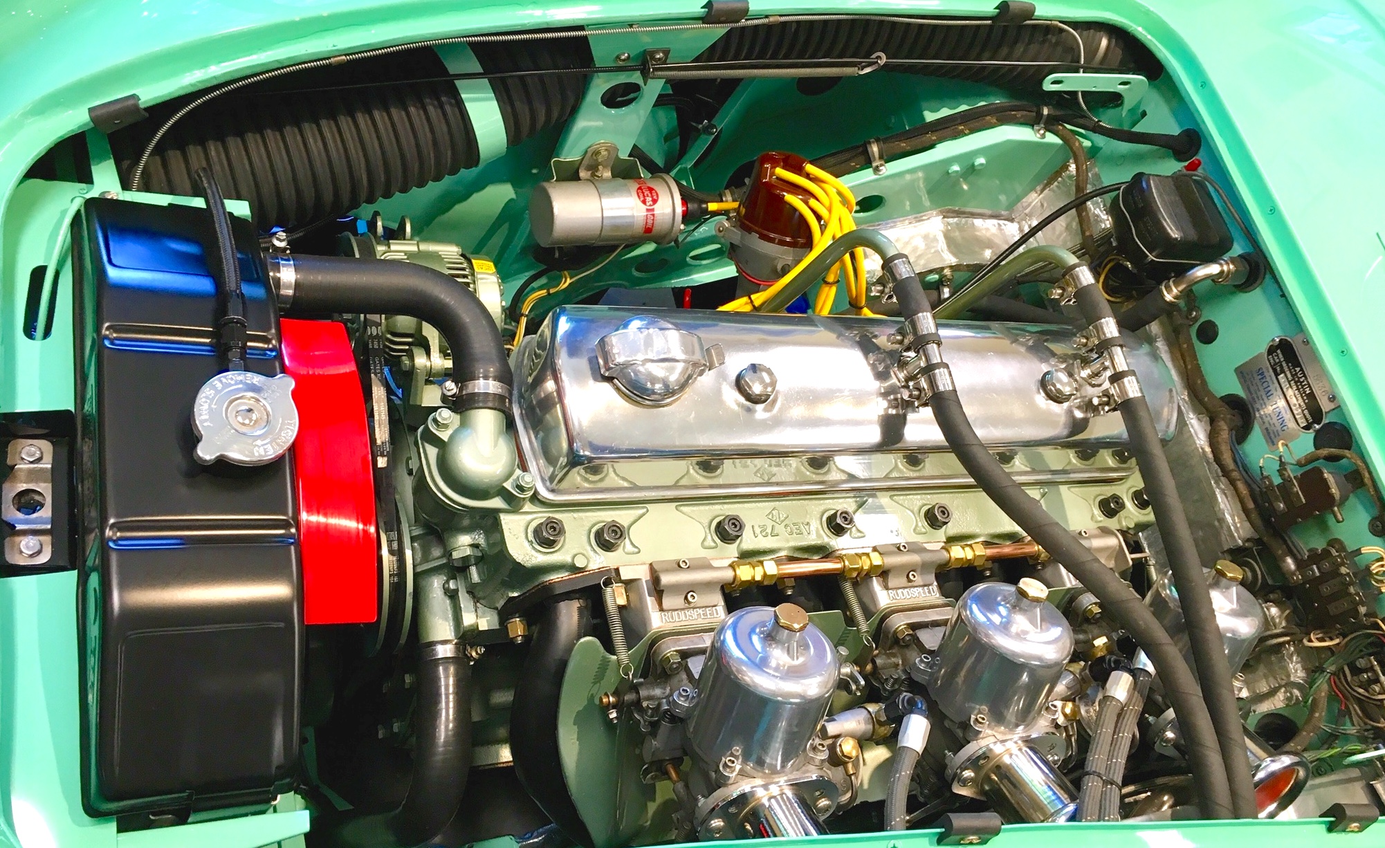

Got the new gear reduction starter installed and have been able to spin the motor with all the plugs out and no fuel pump .
was able to make oil pressure and get oil to all the rockers and shaft etc so that’s a big thumbs up .
instruments are on the way back to me so fire up day for the old girl is closing in . Just need some new ignition bits and some fuel .

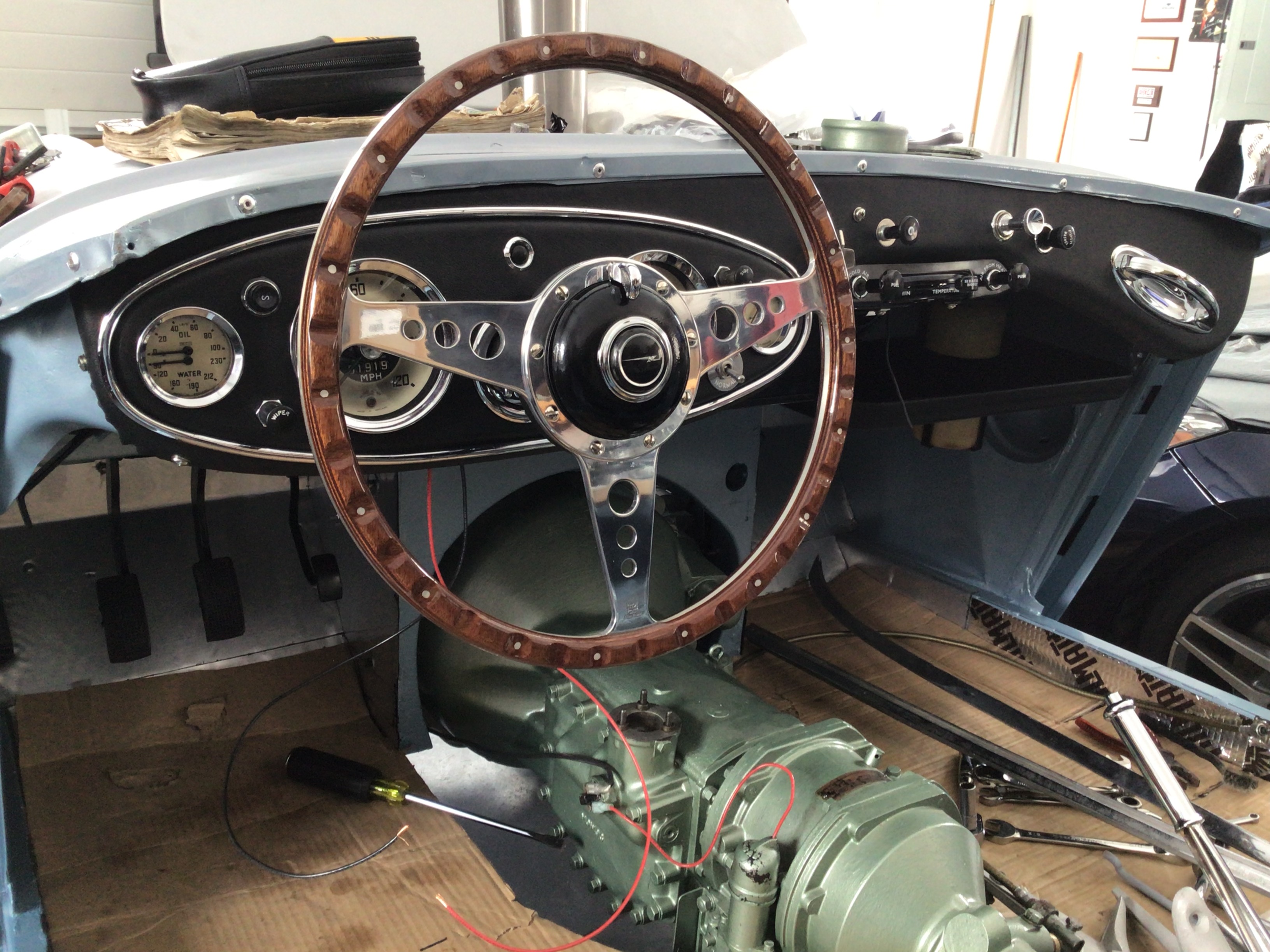

More progress . Electrical almost done , just the indicators/side lights to mock up and test . Instruments all in and checked along with panel lights etc šŸ‘.
Final check of ignition timing etc , fuel and fire er up coming soon .

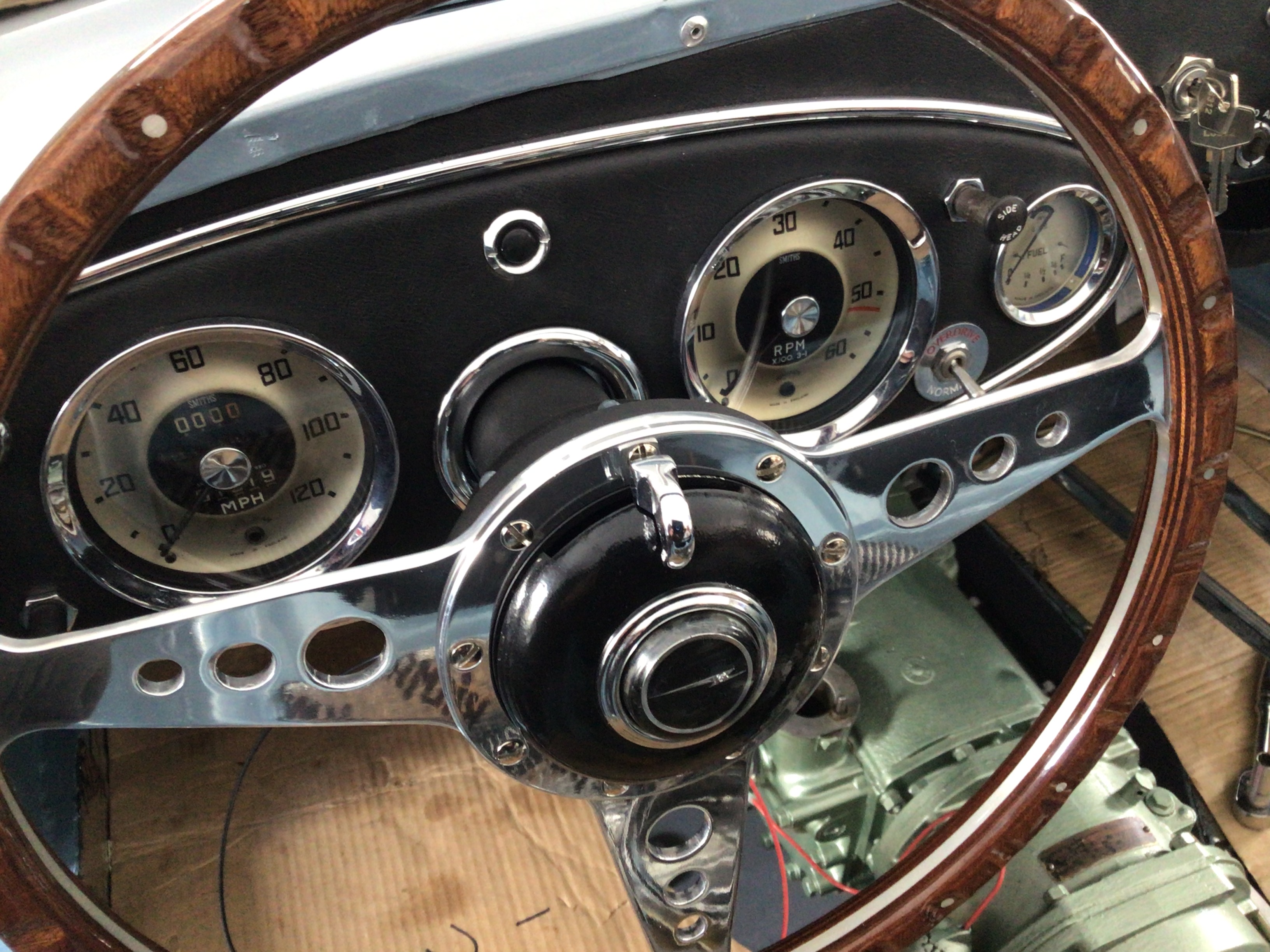

And as an FYI that’s a 14ā€ wheel and boss from SC spares in the UK .
Yes I know the wheel is on backwards , will fix it tomorrow ā˜ŗļø

However, before anyone else mentions it, you know, you have the steering wheel mounted backwards. The grooves/scallops in the wood, on the rim, that are currently facing the driver are actually meant to be finger notches (sorry if I don't know the technical name for them) and they're meant to face the instrument panel. There's no law, that I know of, that says you can't mount it the way you have it, but you're likely to encounter a lot of people who comment on it and ask about it. Maybe you're OK with that.

Oh crap, now I checked the pic again you're right. I was so happy to get that trafficator and wiring in along with the gauges, etc.,
plus I was conference calling at the same time with my daughter. Guess I will have to quit multitasking ā˜ŗļø
Tks for the heads up.
