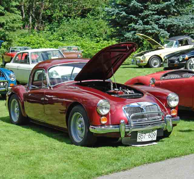

It is pretty tight for that sort of offset on the rear of an MGB. I run TR-6 (5.5') wires on my MGC with no issues but they don't have as much offset as the steel wheels did.
The MGA is much less demanding - these are 5.5' Dunlop wheels on my deluxe coupe, with about the same offset as the TR-6 steel wheels.

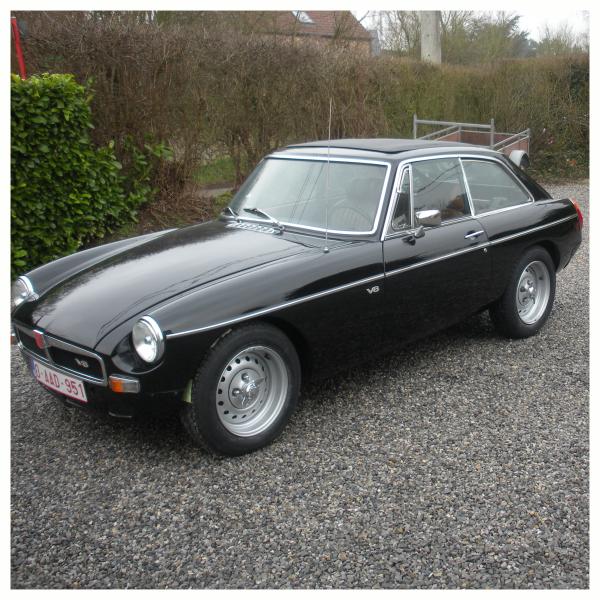

The rear is indeed tight, in particular the right side as the axle is not correctly centered. The left side don't rub, but the right side do sometimes.
Following your experience is it possible to better centre the axle ? the difference is about 10 mm.
billspohn
Centering the axle can be as easy as loosening the U bolt nuts, levering it to the side and retightening, or it can requite a Panhard rod or relocating the spring seats on the axle. you just have to try and see.
