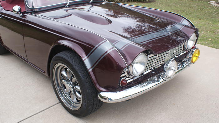

I used 225/50-16 in the back and 205/60-16 tires on my TR4. The wheel offset was "0" so I needed a spacer up front to keep from rubbing the wheel when turning. I did like the look of the 16 inch wheels.
