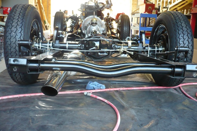

The TR3 steel wheels do fine with tubeless tires. Not sure about the valve stems. I just had the tire shop use what they normally use. It would be worth checking that the rims run true by mounting each wheel in turn on a front axle and spinning it to check for run out. I went through a few rims before I found a good set. Tire size is important if you plan to have a full size spare.
This is the tire size I used and it just fits in the spare wheel compartement.

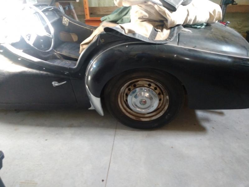

I'm debating what to do for wheel paint. Right now the car is a time capsule, original and never restored but showing some age.
Not sure I even want to paint the wheels yet. They were the period silver, a little rough right now.
I just want to replace the rotted rubber, make sure the wear items like brakes are good and drive it a bit.
I've decided to paint the wheels, she deserves some nicer sneakers.
I need to get my shop set up but I have a compressor / blast cabinet, maybe this is a good reason to get that done and get these done.
I'll probably use VHT rattle can, I have a spray gun but not sure I want to load it / clean it if rattle can will hold up.
I'll use Argent Silver. I assume the original finish was single-stage (no clear). Any recommendations for if I should clear coat them and what sheen to use? (gloss?)

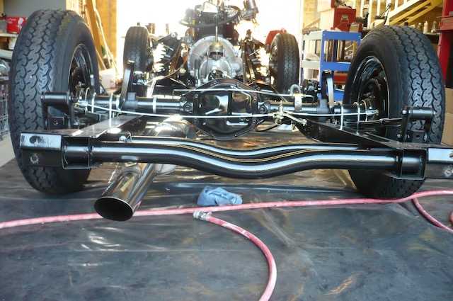

Back when I painted some steels wheels I used (the redundantly named) Argent Silver in a can followed by a clear gloss. I likes the result and it may have been easier to keep clean that it would have w/o the clear coat.
My rattle can wheels with no clear coat a year+ on the road, 1500 miles. No special treatment except washing off with soap and water.
David
