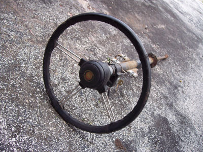

I have a later model steering wheel (banjo type) and shaft (I do not know what year it is out of), complete with column-mounted ign. switch but without the center boss (horn push?)I can post pix if anyone is interested in it!

Jim, as I said, I do not know what it is out of (I acquired it with a bunch of other donor parts for my BE), but here is a pic that may help in identifying it. If it is what you are looking for, PM me and we can go from there!!

Mike, What you have is a stock wheel out of a '68 or '69. I've got one of those attached to a spare steering column I pulled out of a '68 Sprite that I grabbed some parts off of.
