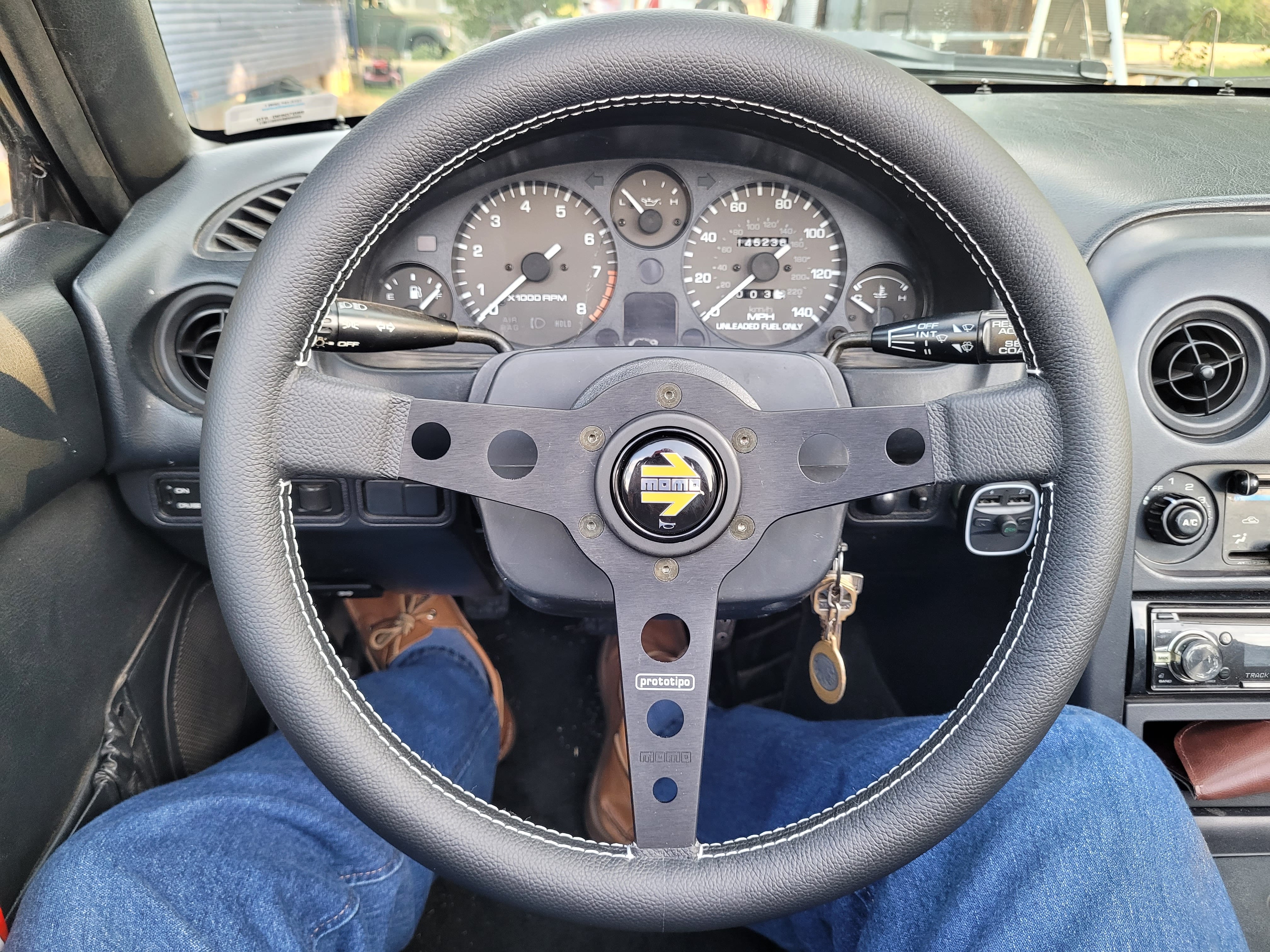

I replaced the old worn steering wheel in my Miata with a new Momo wheel. It's enough smaller than the old one that my knees don't hit is as badly when I depress the clutch or brake. It's also thicker and much more ergonomic feeling.

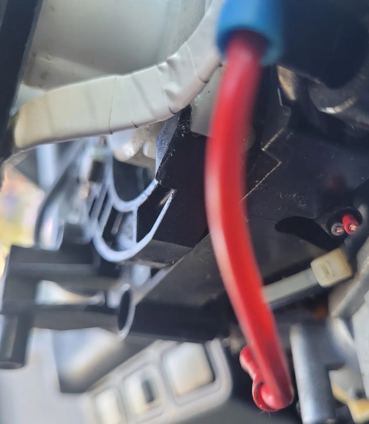

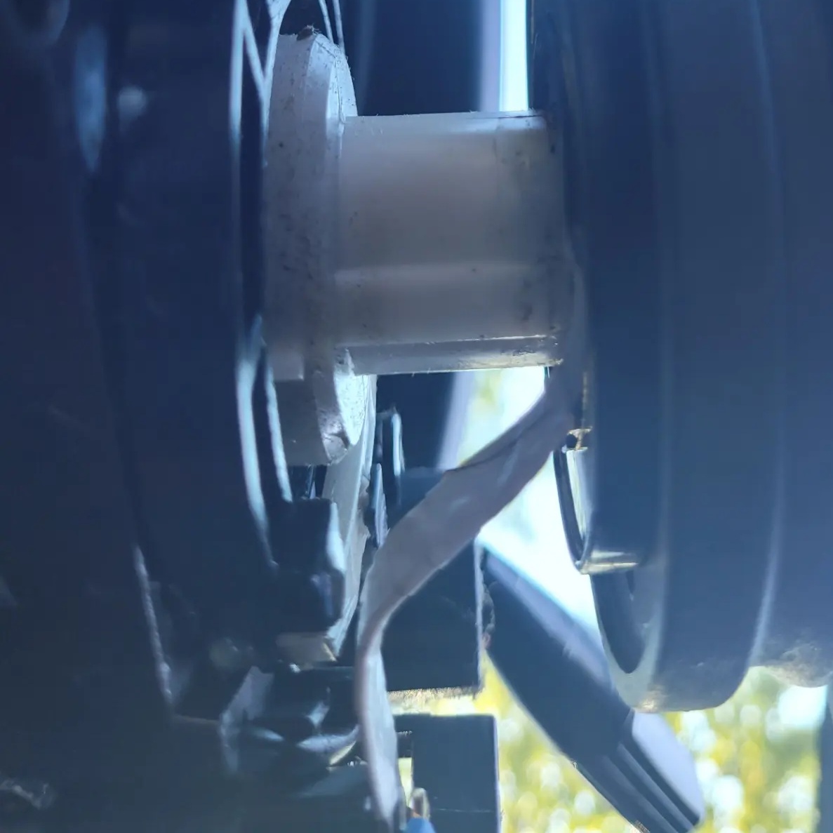

The only downside was that the horn didn't work because Mazda used a funky connector for both the air bag and horn that was sealed. There was no good way to connect it to the hub of the new wheel. So I cut it out then made a new connector out of two layers of coffee can. Now I have a nice wheel and a working horn.
