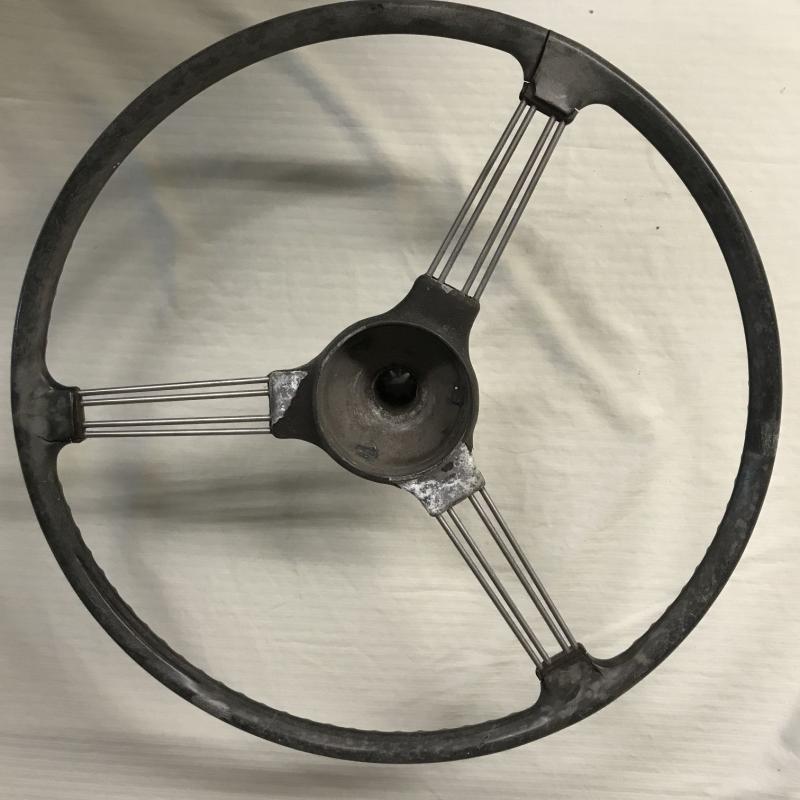

I am working on a car that I am trying to keep original. The steering wheel has lost all the plastic; it is just wire at this point.
Do you have instructions for restoring this or a steering wheel sitting in your garage you want to get rid of?

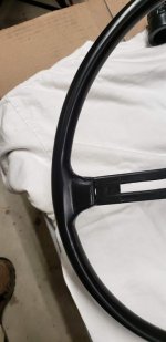

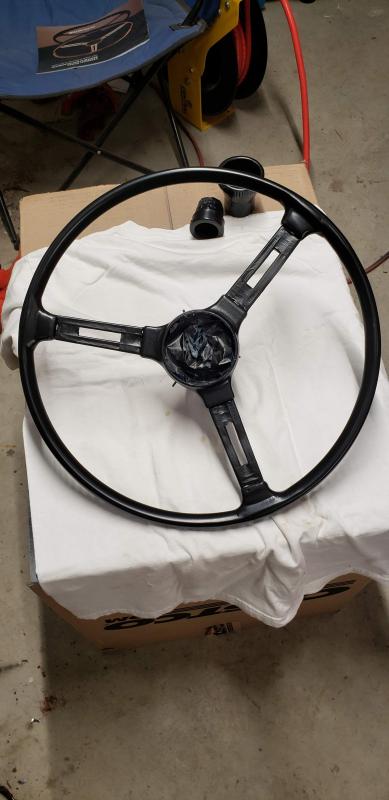

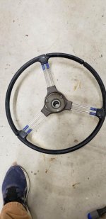

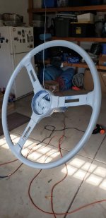

I recently refinished my steering wheel. It took some time and patience. I used the kit and instructions from Eastwood. It is not perfect, but I am extremely pleased. The included instructions are not clear and a bit out of date. Should anyone decide to go this route, let me know and I will post my more extensive tips. See my before, during, and after photos posted here.

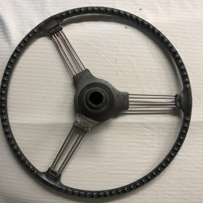

Jerry,
I have an original wheel that is in need of restoration, but sounds like it's in better shape than the one you have.
Let me know if you want it.

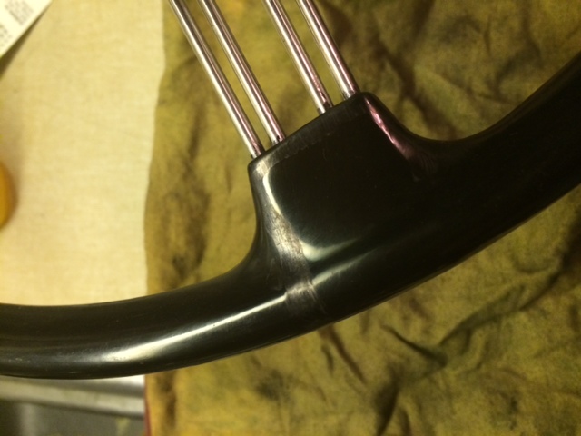

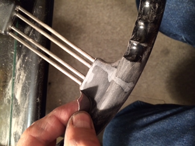

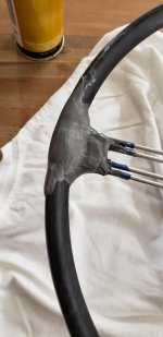

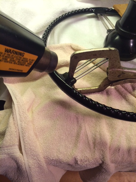

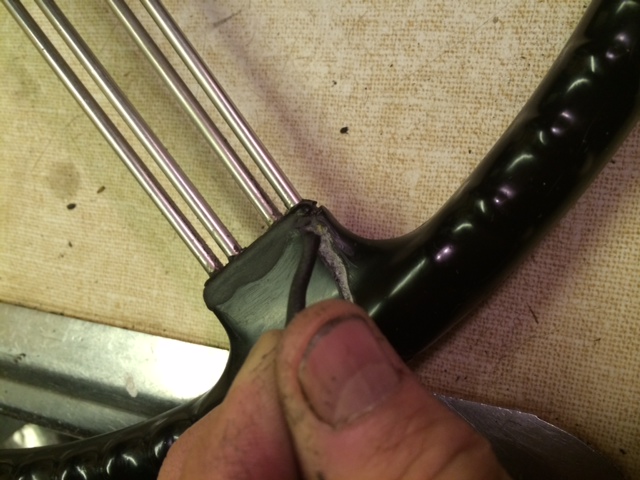

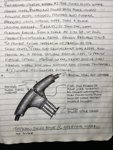

GBedford, I did something similar to what you did. I used a black colored, two part epoxy milliput with piano wire composite. I also included a record sketch as well for better explanation and viewing of the piano wire concept here. I did this restoration back in 2016 and it has held up pretty well. Some further fine grinding could be done, but all I have done up to now is to use a Sharpie (only in the milliput applied areas) from time to time, to color match the right blackness to the surrounding existing finish. All in all, I am pleased with this approach. (PS.- I decided to include a last photo showing the use of a heat gun (used with care), a technique to restore "flatness" or that is to say, eliminate any 'raised' plastic areas as well). 4 Austin Healey 42842 Steering Wheel Refurbishment 4.JPG5 Austin Healey 42842 Steering Wheel Refurbishment 5.JPG6Austin Healey 42842 Steering Wheel Refurbishment 6.JPG

Thanks for all the instructions. I had someone call and a used unit is on the way. It needs a little care like you have done above, but in better shape than the one that came with the car. I should post a picture of the wire under the outer ring. I am not sure how all of the plastic is gone.
