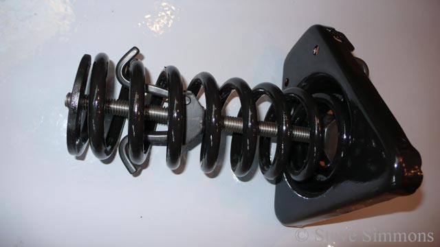

You don't need jack stands either, but they're certainly a good idea. If spring compressors weren't the best tool for the job then they wouldn't make so many of them.
Use the proper tool for the job. Use a spring compressor. It's so easy that there's no reason to not use one.
Here is a previous thread on the subject: https://www.britishcarforum.com/bcforum/ubbthreads.php/ubb/showflat/Number/476267/
I don't know about anyone else, but encouraging people to forgo the proper tools seems a bit risky in this age of law suits!
Photo of spring compressor in place....

Steve - What you're using isn't the proper tool either! Do you know what factory/dealer's proper way to remove springs is? From the factory manual's perspective?
It was to use a special spring compressor to the lower wishbones to take the spring's pressure off so the spring pan could be removed from the wishbones...That compressor fit under the outsides of the 2 wishbones & hooked to the outside of the spring so that the perch could be removed from the wishbone assembly....spring wasn't compressed against itself like your compressor does...it was compressed down towards the wishbones...then the compresson was taken off the spring & the spring & lower spring pan were removed from the bottom leaving the stub axle assembly bolted to the front shock.
The length of the spring (under pressure) is longer than the distance between to upper spring mount & the top of the lower perch over which it has to be pulled (if you leave the perch in place)...it can't go anywhere!
If you leave the lower spring perch in place, the spring can't go anywhere until you push the lower wishbone assembly down enough to release the spring from the lower spring perch (farther than the normal travel of the wishbone assembly.
If you want to go to the trouble of installing that compressor - go for it...but it's a waste of time!
I even take springs out of a complete suspension assembly that've been dropped from the car with no problems....can't count the number of cars I've done the way I described!
Use a compressor if you have one - don't waste your time running all over town to find one though!

Correction, it isn't the factory tool. However it is the proper tool to compress a coil spring and allow safe, easy removal.
<div class="ubbcode-block"><div class="ubbcode-header">Quote:]If you want to go to the trouble of installing that compressor - go for it...but it's a waste of time![/QUOTE]Safety is never a waste of time, especially when we're talking about 90 seconds to mount the tool to the spring. You then disassemble everything by hand. No jacks or special care required.
Using jacks, chains, 2x4 blocks of wood, clamps, wire, metal rods, comealongs, removing shock bolts or any of the other methods I can't think of will all work. It's all simply a matter of how much risk a person is willing to take.
When I work in the garage, my goal is to never be "that guy", if you get my drift! :smile:
