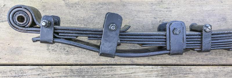

Wondering if anyone can identify these unusual leaf springs (or at least unusual additions to normal leaf springs) from the BN2 project we're working on:
Specifically, there is obviously at extra leaf with its own unique profile. It appears to have an "anti-squat" or "anti-tramp" function, and we're wondering if it is a custom modification, perhaps a period "kit," or perhaps even a different model originally supplied this way back in the day. Again, this is from a BN2, build date 1 November 1955, that had a single owner 1962-2019, and he was interested in performance mods. We wonder if he made this modification or perhaps bought them this way. He is, unfortunately, no longer with us to clarify.
Thanks.
No specific knowledge of the above, but we used to know these things as spring helpers.
They were usually to aid towing...unlikely on a Healey? I don't know if they are effective as an aid to worn springs?
