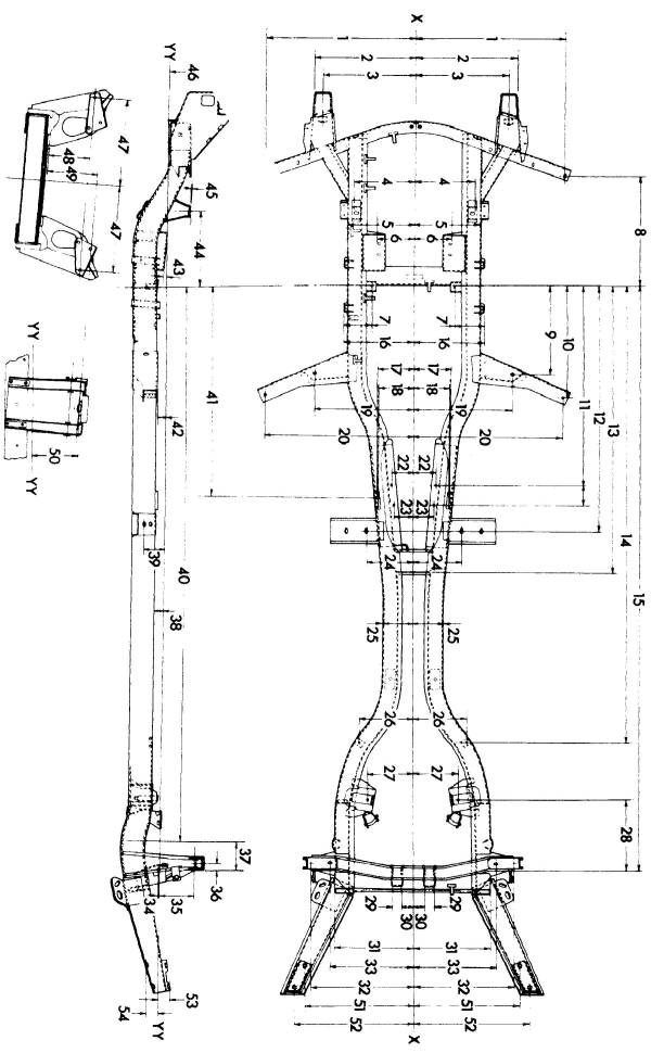

Does anyone have a pic of the correct angle of Spitfire rear tow tabs? I guess mine have been used in the past and are quite bent out of shape.
Also-Any suggestions for getting them straight (flat) and at the correct angle using common hobbyist tools?
Thanks,
Bob
Andrew Mace
This drawing of a late chassis with measurements (I thought the picture was kinda large to include here, so just click on the link) shows pretty well where and how they mount. The tabs themselves are pretty much at a 45-degree angle to the chassis, and probably any big old hammer (and maybe some kind of dolly on the other side) would straighten them enough to be serviceable again.
