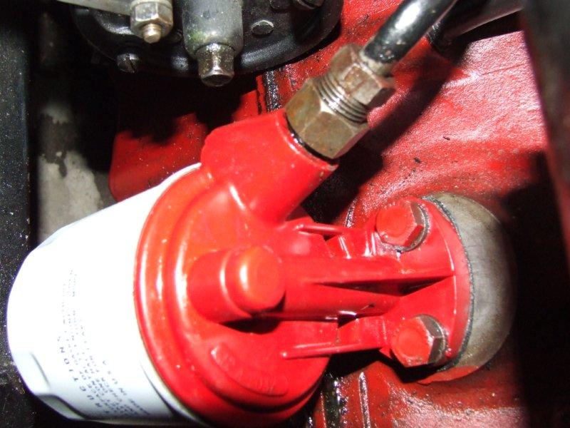

I changed to a spin-on filter for my 1098. It was simple bolt on thing with just a little bit of tweaking to the original oil line to make it fit.
