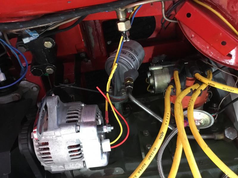

Here's the solution I used. A couple of compression fittings. All Hard Line all the way. Have not checked this under pressure yet but looks like it will work.View attachment 53412

Well I got a new aluminum inlet for a 1275 or 1098 with downflow radiator. However I bought a new aluminum radiator, will need to see which one fits best. Tim also had a cast part in his stash on Mini Parts. Will use whichever on provides the best angle for the hose. Fix was a compression fitting of the correct diameter for the metal pipe and a compression fitting on the other end that fit the inlet for the adapter. A little bit of bending to fit and voila.
Now there is a spin on adapter as mentioned above. $< $30 on e-Bay that he says fits with the standard line. This fixed the problem. Will find out if it works once we fire up the engine.
Bugsy can be seen in the background and that's Tim's Mini Moke in back of him.
