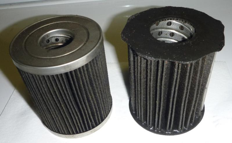

Wix on left; Fram on right:
Unfortunately, these photos don't answer the questions (in no particular order):
  • What's the filtration efficiency?
  • How much dirt does each hold?
  • What models are each?
  • What material is the drain-back valve on each?
  • What are the pressure drops through each?
  • When were these photos taken?
davidb
Still, based on the photo, notwithstanding the good points that John Turney makes, the WIX filter on casual inspection seems to have greater filtering capacity. Interesting photo nonetheless, and thanks to Steve for posting. I guess if you change your filter regularly and often, filtering capacity becomes less of an issue, and more of a talking point around a couple of beers out in the man cave. I wonder how much better the spin-on filter system works when compared to the old canister type Crossland filters that are lurking somewhere in a dusty box in my basement.

The two different filters I cut open validate the points made 10 years ago by The mopar guy linked to above. The fram is poorly made compared to the wix.
