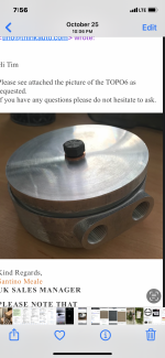

Sorry, new to forum. The part you are looking is made by ThinkAuto (MOCAL). P/N: TOPO6
Ask for Nick Fitzgerald. I bought mine for him so he will know what you are asking for.
