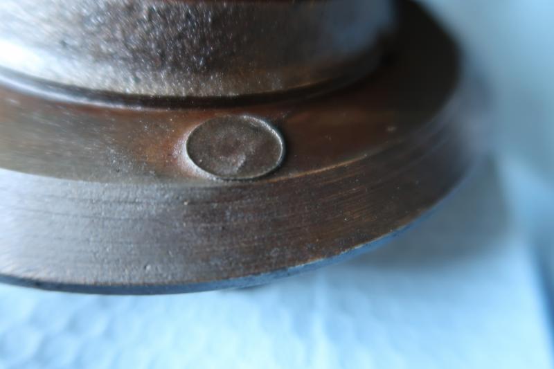

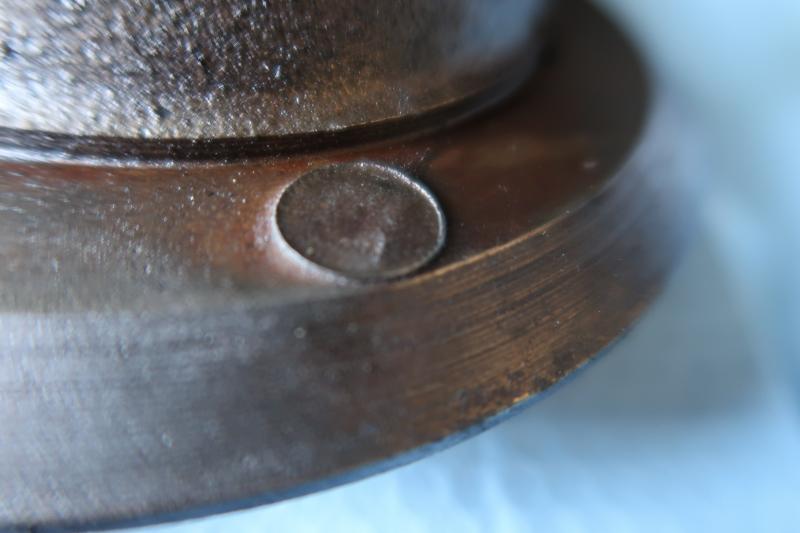

Wow. My new rotor from Moss self distructed taking with it the new distributor cap. Now my baby is again grounded.
So I turn my attention to distributors, rotors etc.
What's my point(s)? heheheheheh
I would like to hear from those who don't get the point(s) anymore but use electronic ignition instead.
Shall I stay with points and rotor, if so where is a source of bosch or another reliable maker?
The one I got from Moss came apart (little brass push rivit came loose) and grooved the cap beyond the point of no return.
I notice a small amount of play in the distributor
just a few degrees but it did run fine before the rotor
ed out.

I need to come clean. I found the original rotor box (the pack rat I am hehe) it WAS a green boxed Lucas rotor. I originally thought it was non-Lucas.
My understanding is that Lucas no longer makes anything but farms this stuff out (usually offsore) in this case probably India. I wonder how many healeys are in India?
Speaking to Moss this morning they said I was the first to come forward with this bad rotor problem.
The rotor is bakelite type material and has a brass rotor blade held on by a single rivit. The brass rotor blade has an arrow on it indicating rotational direction.
The cap was in a blue and red box marked C I. (C above I)
Moss will ship me new ones no charge.
